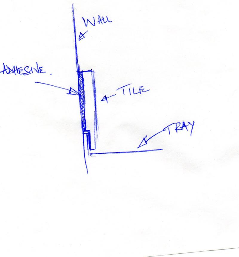

I have fitted a new shower tray which has the raised tiling lip around the edge. The new shower tray is fitted butted up against the new/existing walls. Yes I know I should have recessed it into the wall.
Anyhow what I am after is a sealing trim that I can fit under the bottom row of tiles to shed water over the lip. I have searched on the web and cant believe nobody makes such a thing.
I could fit bottom row of tiles over the lip but this would make them "kick" out at the bottom.
Anybody know of such a trim?
No dont know of any such trim.How thick are your tiles and how thick is the lip?
You may be able to rebate out the bottom of the tiles so they dont kick out,use a diamond disc in an angle grinder and have a practice on some off cuts.
Like the idea - not thought about that.
However the tiles are plain whites and quite thin. Think if I did take anything of thickness they would be quite brittle.
