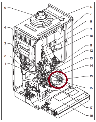

The installation manual I have for the 'Vaillant ecoTECH 637 Plus' shows it with a pre wired internal pump. Is yours different?
You're right Stem, there is an internal pump which is connected to the PCB on the x18 connector (green block next to 230v block).
I'm talking about an additional, external grundfos pump which is placed on the pipe work near the valves. I guess this was placed to improve the flow (11 rads two floors) and get the return temp up. This was connected in a junction box and got a live when the valves open.

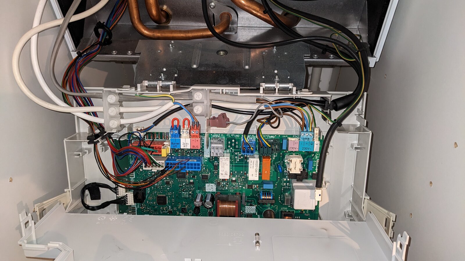

PCB photo added. As you can see the internal pump is in. It's the external grundfos that has to operate when the valves open that is not plugged. Before ebus and wiring centre there was a 230v brown block with the grey cable which has you see is now disconnected and this was going to the junction box.
All works well otherwise, just trying to get that external pump connected.

If the external pump were connected to the same LNE as the internal pump they would both operate together. But I would still want confirmation that the boiler pump control circuit is capable of driving two pumps together without damage, and still question the need for two pumps in the first place.
Also to be considered is a by-pass to allow the pump to run on for a few minutes once both motorised valves have closed and there's no water flow through them. The boiler has an internal by-pass, so the internal pump will be OK, but what about the external pump, does it have an external bypass?
If you are sure that the CH is the only part of the system to use the second pump, and the boilers internal pump will run the DHW, then you could wire the second pump to the CH motorised valve.
Just as an after thought, you're not having a boiler without an internal pump replaced by one that does are you, hence the introduction of a second unnecessary pump?

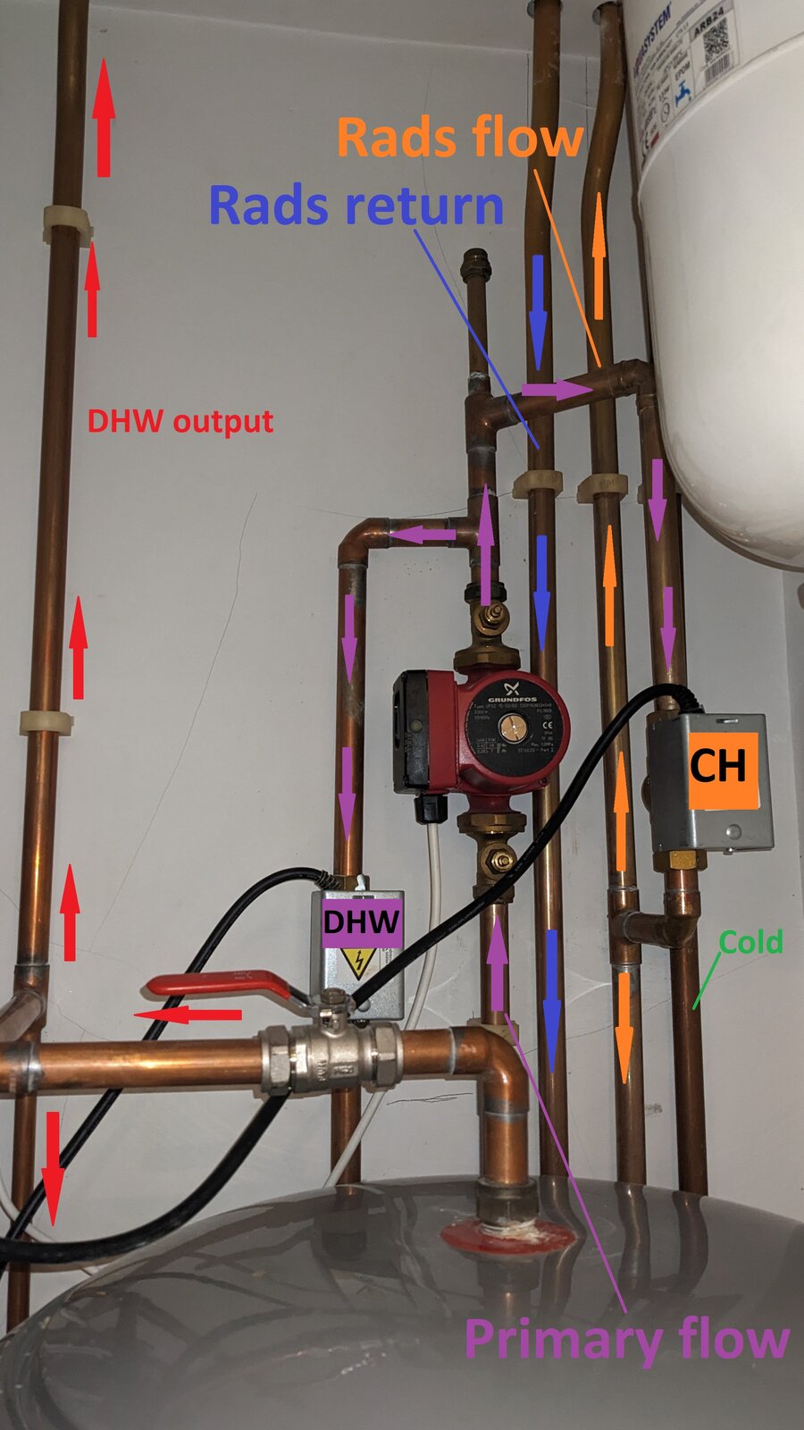

Here is additional info and a photo of the pipe work of this install:
- I'm positive there is already an internal pump in the ecotec plus boiler (as you'd expect). It is a Vaillant / Grundfos UPM3 and it's wired on the PCB on the X18 connector. There are two pumps on this installation: one in the boiler, and the UPS2 pump on the pipework.
- I'm almost certain the UPS2 pump on the pipework was wired so that it would operate only if the CH valve was in open position. A wire from the thermostat was on the same block as the brown of the CH motorised valve. There was no connection between this external pump wires and the DHW motorised valve. The DHW motorised valve was operating as you'd expect (if thermostat calls for DHW and then if CYL stat calls for heat then DHW valve opens and the microswitch turns the boiler and internal boiler pump on, the external pump did not seem involve for DHW).
- This is the pipework of this S-plan:
It's not visible in the photo but after the DHW valve the pipe that goes down is the flow for DHW going into the cylinder, and DHW then goes out from the output pipe following the red arrows.
As you can see the external (additional / UPS2) pump is on the primary flow pipe coming from the boiler BEFORE the motorised valves. So if the CH valve was opened, the pump would run as well, if the DHW valve was opened but not the CH (e.g. in the summer to get hot shower) the pump would not operate, but the water would pass through anyway.
Here is my first question: would that pump on the primary flow pipe being turned off hinder the flow because of the blades inside it and make it harder for the boiler internal pump to get the water moving? I assume this would not be an issue since it was working like this, but it begs the question ..
Now as far as I can see, there is no by-pass valve on this pipework. So in the eventuality of that external pump running and both valves being closed the water had nowhere to go and that pump would struggle and overheat (as @stem mentioned above). I assume this simply never happened because the wiring was done so that the pump would only operate if the CH valve was opened.
However here is my second question: by default the boiler internal pump is meant to overrun ~5 minutes after the flame is off. Is there a setting that keeps at least one valve opened whilst that internal pump is running? If not where would the water pumped by the internal pump go during this 5 minutes overrun? As @stem said there is indeed an internal by-pass valve within the boiler however unsure how much pipe circuit there is for the water to flow and hence how effective those internal by-pass actually are?
There will be some resistance, but I would imagine overall it probably has a greater cross section than the 22mm pipe it's connected to, although it could generate some turbulence. Hard to say really and although I've helped with 100's of systems, this is the first domestic installation I've ever come across with more than one pump. (Other than underfloor heating systems) As it was, the only time the external pump wasn't running was when the HW only was operating, and that requires a much lower flow than the CH, probably more like the flow required by a single radiator.
OK. When you first asked the question about how to wire the pump, you hadn't mentioned there was another internal pump [having said that I've since noticed that the title of your post refers to it as a secondary pump :rolleyes:] so the initial comments you got back were based on the external pump having to pump the HW circuit as well.
From an electrical point of view. If the external pump was wired to the CH MV, then there's no problem with it not having a by-pass as it won't be running once the valve has closed.
It circulates the water around inside the boiler. Don't worry about it though it's designed to do it by the manufacturer, if there was a problem it would be tripping the boilers overheat function.
Keen to have your views on this set-up. It works I guess... but starting to wonder if this was installed as it should have.
Like I said my skills are really electrical; my plumbing knowledge I've picked up as I've worked alongside others, so I would be interested to know why there are two pumps on your system. Perhaps you would consider starting a new thread with the title 'why do I have two pumps' or something similar, giving details of your set up. This thread has a controls bias so some of the expert plumbing engineers on here won't be following the discussion, and a new thread might just pique their interest.
