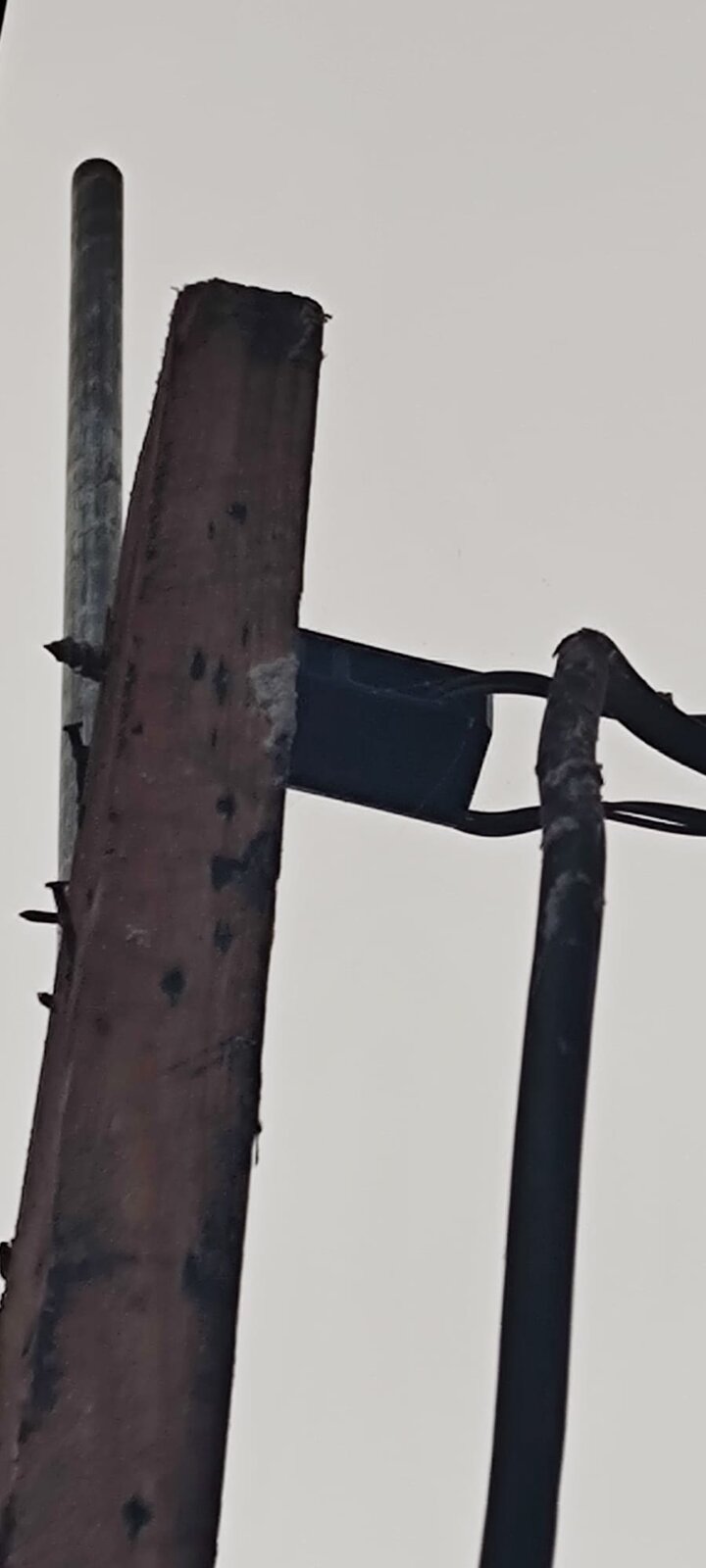

Hi,
I'm waiting on a date for UKPN to replace my existing overhead supply cable with a new 100A rated one. At present my supply is attached by a hook screwed to a piece of 6x2 propped up by scaffolding. (see pics) I would very much like to get rid of the scaffolding.
I have a new timber-framed upstairs floor and I would like to secure some kind of corner for thisbracket for the supply to be fixed when it arrives.
Ideally I would prefer to get an angle bracket wirth a hoop/loop fixing on the corner, so that it can be fixed through both sides into the timber body of the house. Where can I get a suitable bracket?
Regards
Tet
You don’t get a bracket from anywhere - that cable and support is nots yours to touch
