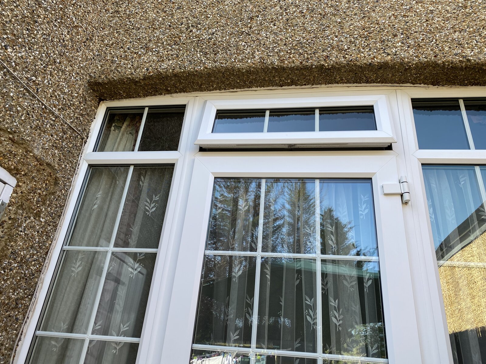

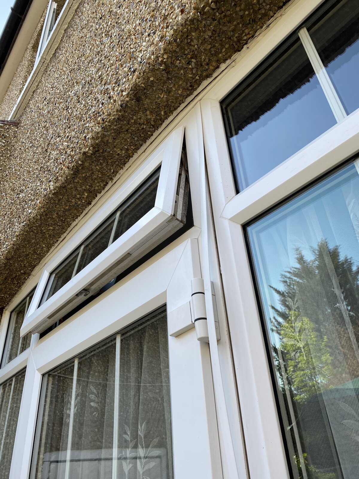

hi all,
I have a upvc french door set comprising a double glazed door in the middle and a side pane either side of the door. I think both the door and side panels are screwed into concealed metal props between the door and the side panes. This is on the rear wall of the property which is a double brick wall. I'm guessing that the props were secured to timber plates at the top and bottom of the opening in the brickwork.
I am planning to have a kitchen extension done and want this double glazing taken off and re-used on rear wall of the kitchen extension. The surveyors plans show the new wall as a cavity wall with a catnic above the door.
So can the props be screwed somehow to the catnic ? Or will there have to be timber plate in between that is fixed to the sides of the opening in the wall ?
Thanks in advance
Photos would help.
Usually a common configuration is that the joints are either re-enforced or not, but not attached at the top or bottom. But you can get versions with a load late and jacking elements, in something like a bay.
Thanks swwils, attached a couple of pics. Not sure if they help. You can see there’s a trim to cover the joint between the side pane and door
So you are saying that the props are basically held in place simply by the force of jacking up and friction at top and bottom ?

You shouldn't have any problem drilling into the catnic, punch it first, start off with a small pilot drill and progress larger as needed.
I would be surprised if that set of doors is anchored to the lintel already, with
I looked at a neighbours new bay window, that had aluminium box section running vertically inside the end sections (like a prop), these merely rested on the bottom brickwork, and had 4x2 wood on top as wall plate for the roof.
Post more pics when you uncover the fittings.
You may be able to use some medium/heavy duty angle brackets to secure the top, depending on internal decoration.
