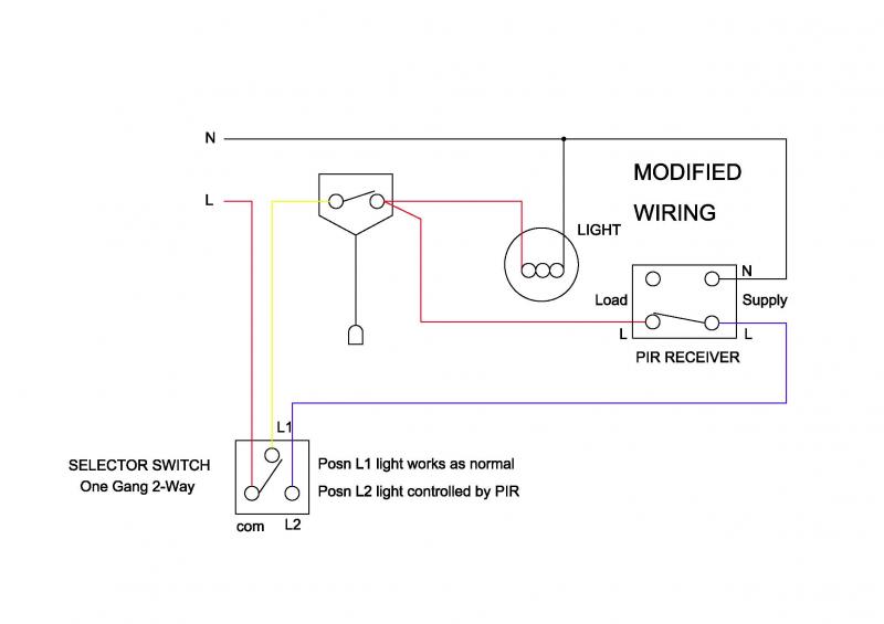

Silly idea i know , but this is what i would like to potentially do!! In esssense i would like to (at night or when away for the weekend hols etc) at the flick of a switch set an internal light (say bathroom) to come on by way of PIR detection at main gate of property, and on my return flick of switch and light is back to internal normal switch on wall use.
Plenty of ways in my CU so could dedicate to say bedroom light.
Reason!!, I believe this would be a decent detterent to anyone dodgy about to enter my "empty" premises.
Running cables internally externally no problem as place is all stripped.
Russell
No a silly idea at all. I did something similar for a mate. Simple job. I used a wireless PIR similar to one of these, with the switch inside the airing cupboard. No walls to chase out, no external cables to run, half a day job including time for tea and biscuits. It will need to be wired into the same circuit as the lights, so all connections nearby anyway.

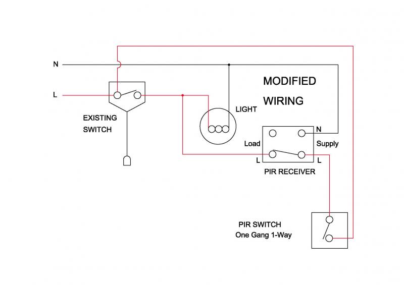

Here are some sketches to assist. Apologies for the use of the old wiring colours, as I don't know what colours you have, I thought it would be the simplest.
Existing Installation
Option 1 with Changeover switch to allow selection of normal light control, or PIR control
Option 2 Alternative version. Here the bathroom light will work as normal all of the time, with just the PIR being selected on or off.
