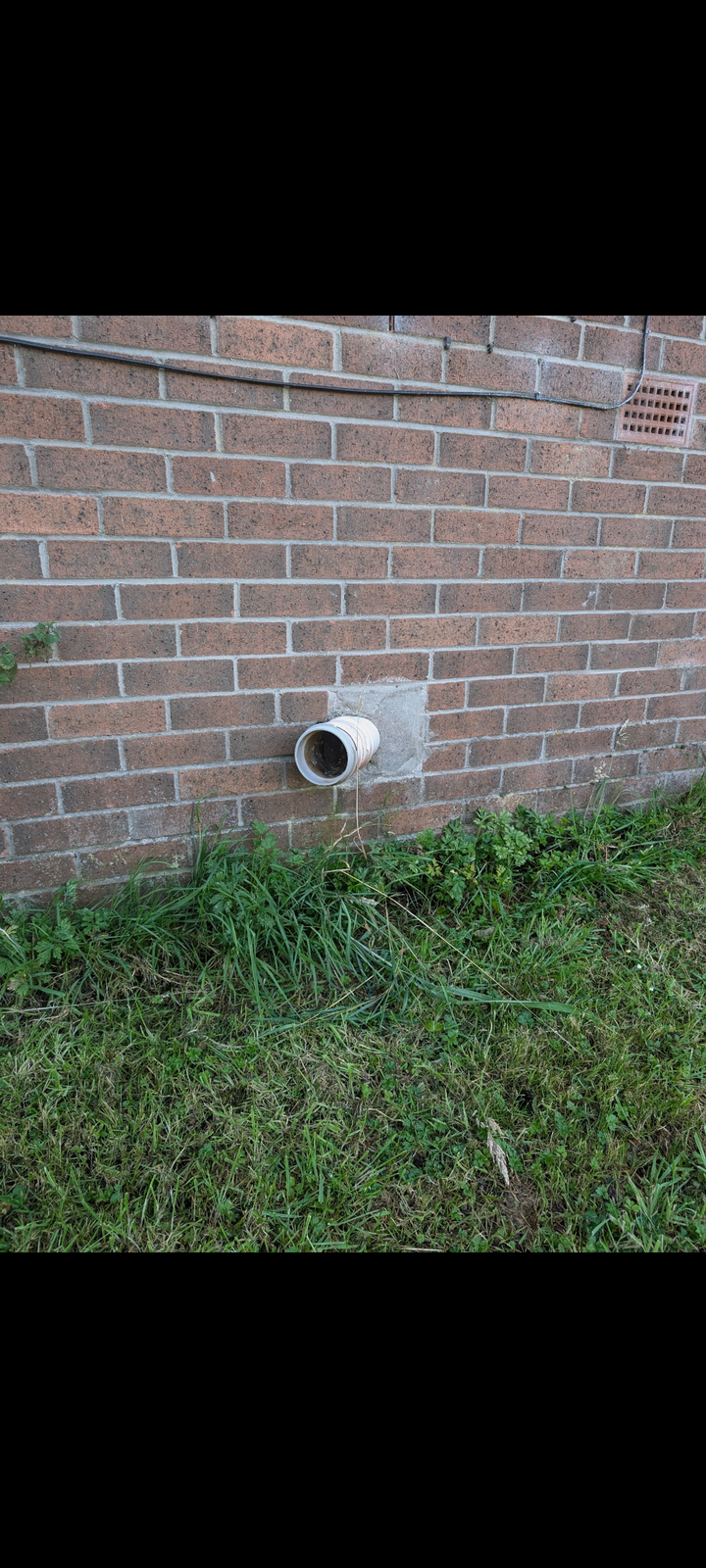

Moved into new house a few weeks back. Since day 1 we've had an issue where when running any water in en suite we get this clicking/banging noise at high level but I feel like it's coming from the drain (pipe chase is in en suite).
Separate to this there's been a weird thing where there's a pipe outlet for my drain that seemingly connects into the same drain/downstack that comes from ensuite (or this pipe is basically directly below en suite).
Today I bunged this outlet to stop any vermin etc getting into it (used a push in cap). I then went for a shower and for the first time had no banging drain. It seems too coincidental not to be related but I can't work out how bunging this drain has stopped a banging drain on top floor.
Don't suppose anybody can explain this to me? My one concern is I'm not sure why this pipework was left open in the first place, there seems to be a vent at roof level

What on earth the purpose is of the pipe sticking out the wall I do not know, cant say I've ever come across anything like that! Assuming (which is dangerous!) it is connected to the stack, then capping it off may have effectively sealed the stack, I am wondering if the noises you describe are the stack expanding/contracting where it has a piece of timber pressed tightly against it somewhere.
Wont be Water Hammer, that's a completely different sound, and will be a Humming noise rather than banging.
Hi, thanks for the response. I agree that it wasn't water hammer as was most noticeable for a few mins after having a shower.
So my thoughts (and I'm an admitted idiot when it comes to plumbing) are that it's connected to the stack (Incan hear water flow through it when I get someone to flush toilet etc). My random guess is that it's been added as a rodding point at some point to clear a blockage (the location is actually below floor level in the house).
You're point about the noise being expansion and contracting against a joist was the same one I had. What I don't understand is how blocking this off has stopped that happening.
You mentioned it has sealed the stack, are there any implications to this? There's a vent a top of stack so assume it can still vent off.
