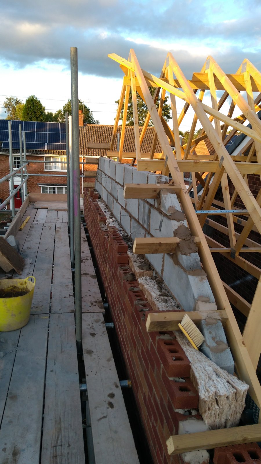

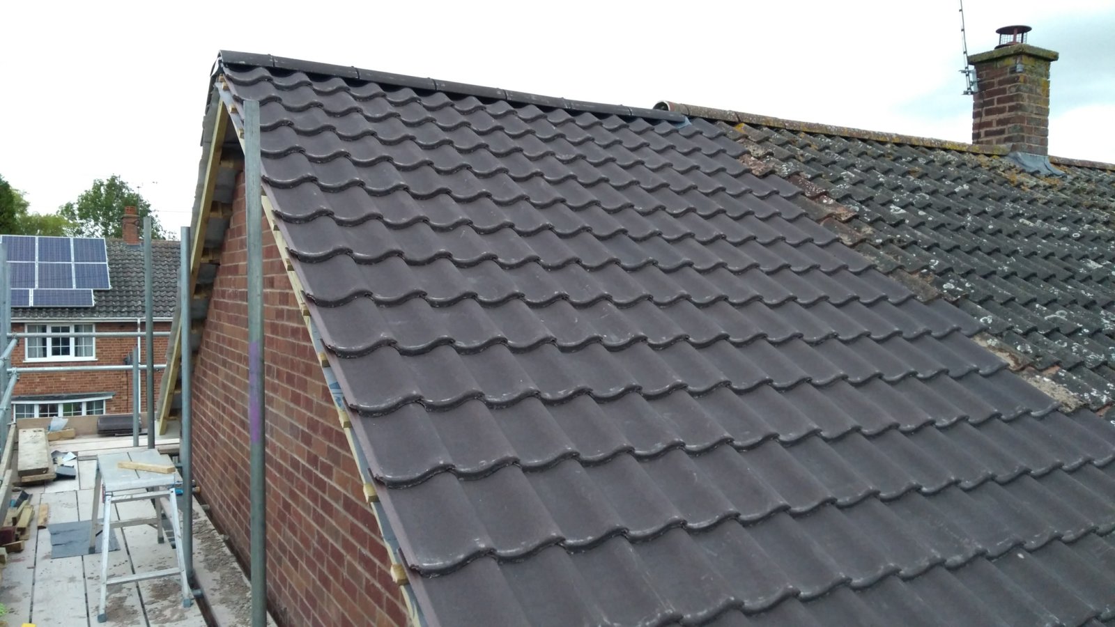

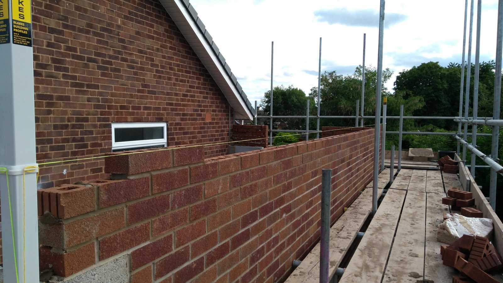

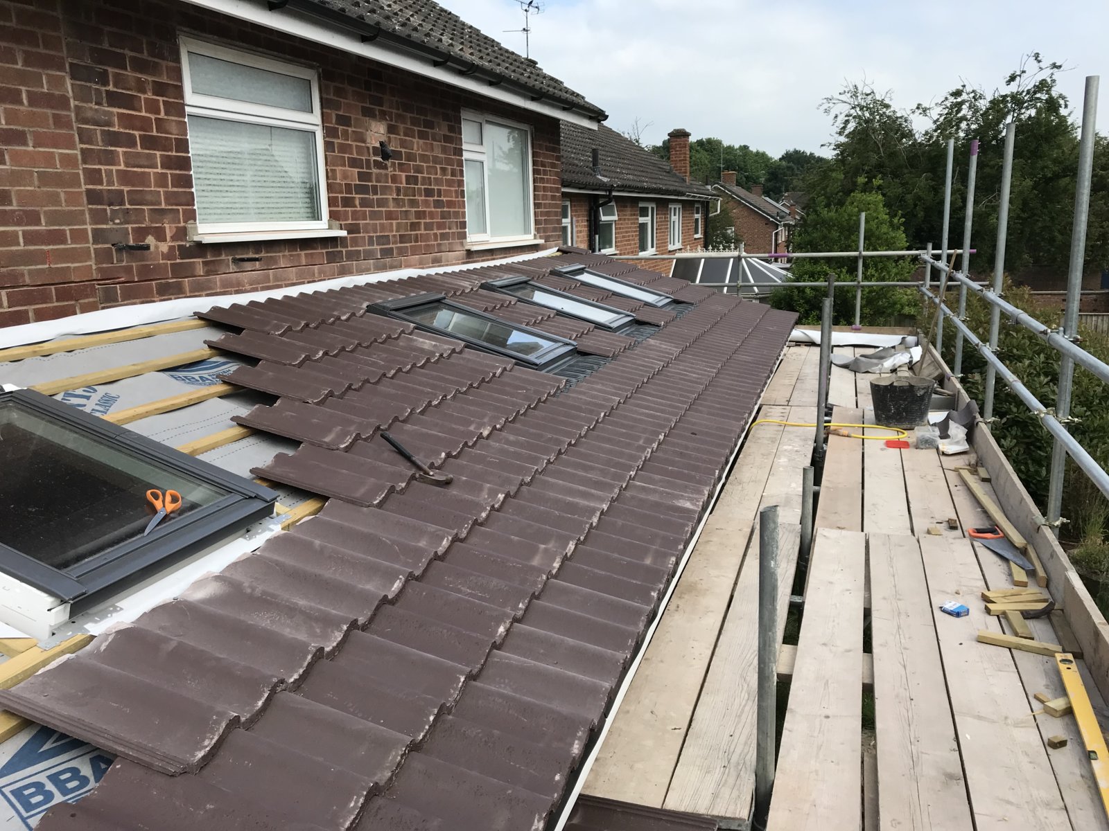

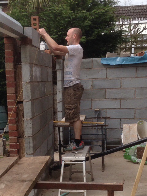

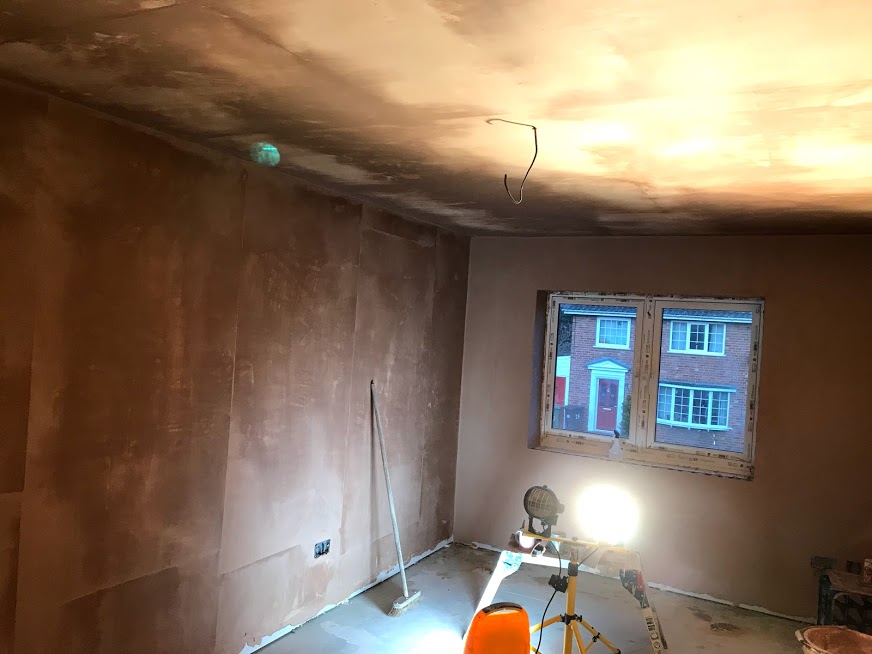

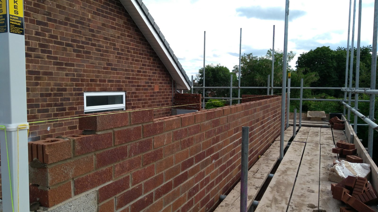

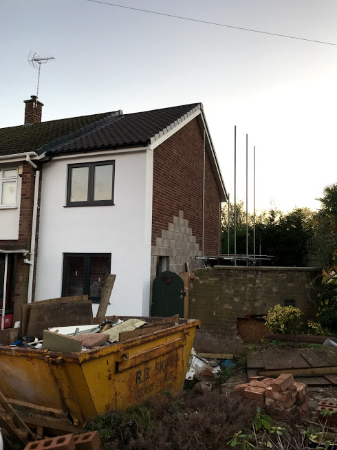

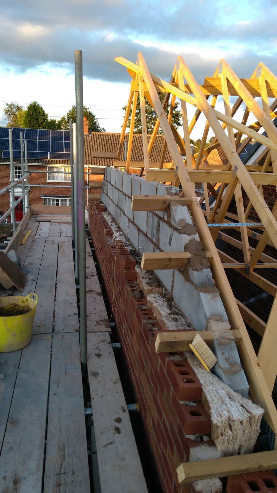

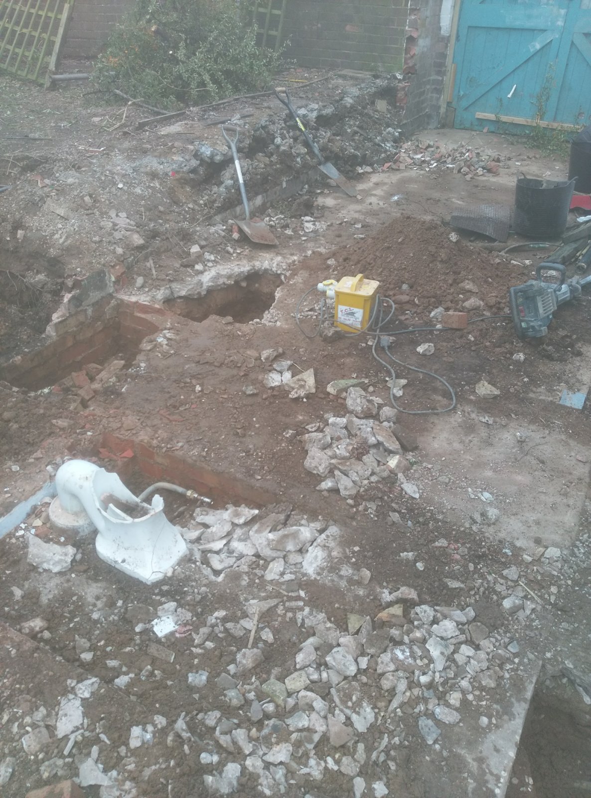

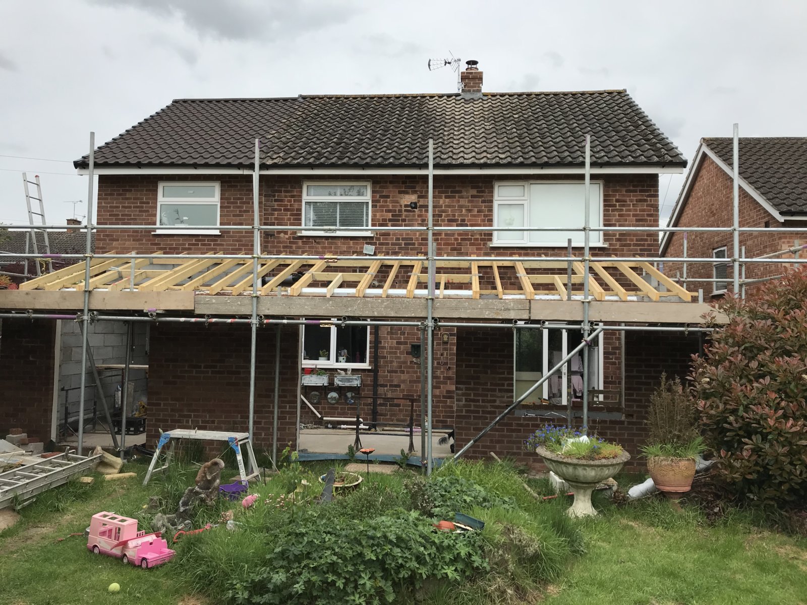

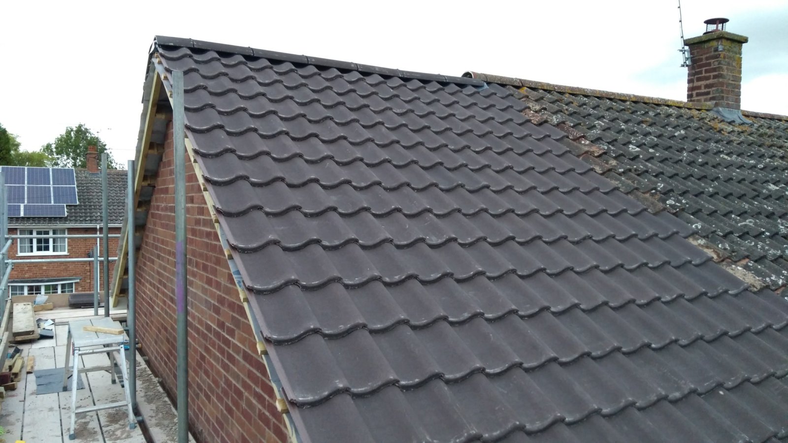

Been meaning to put this on here for ages incase anyone's interested.
Started a year ago with foundations, done everything myself apart from digger guys for foundations and sparky, squeezing it in at any time I can outside of the 9-5 job. (last summer many evenings and weekends bricklaying - loved every minute - kind of!)
Built 2 storey section, roof, plastering, now finished upstairs apart from ensuite fit out (stalled until I save a bit of cash for it) and this year's project is to build the single storey rear kitchen extension, which'll hopefully be easier!
This site has been a massive help - top bunch of guys of all ability/experience and some good humour along the way (y):D

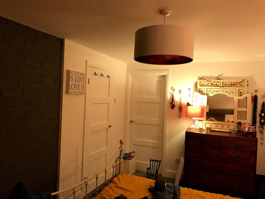

lol. I can't comment on how the client (the wife) dresses the rooms after I've finished skimming them

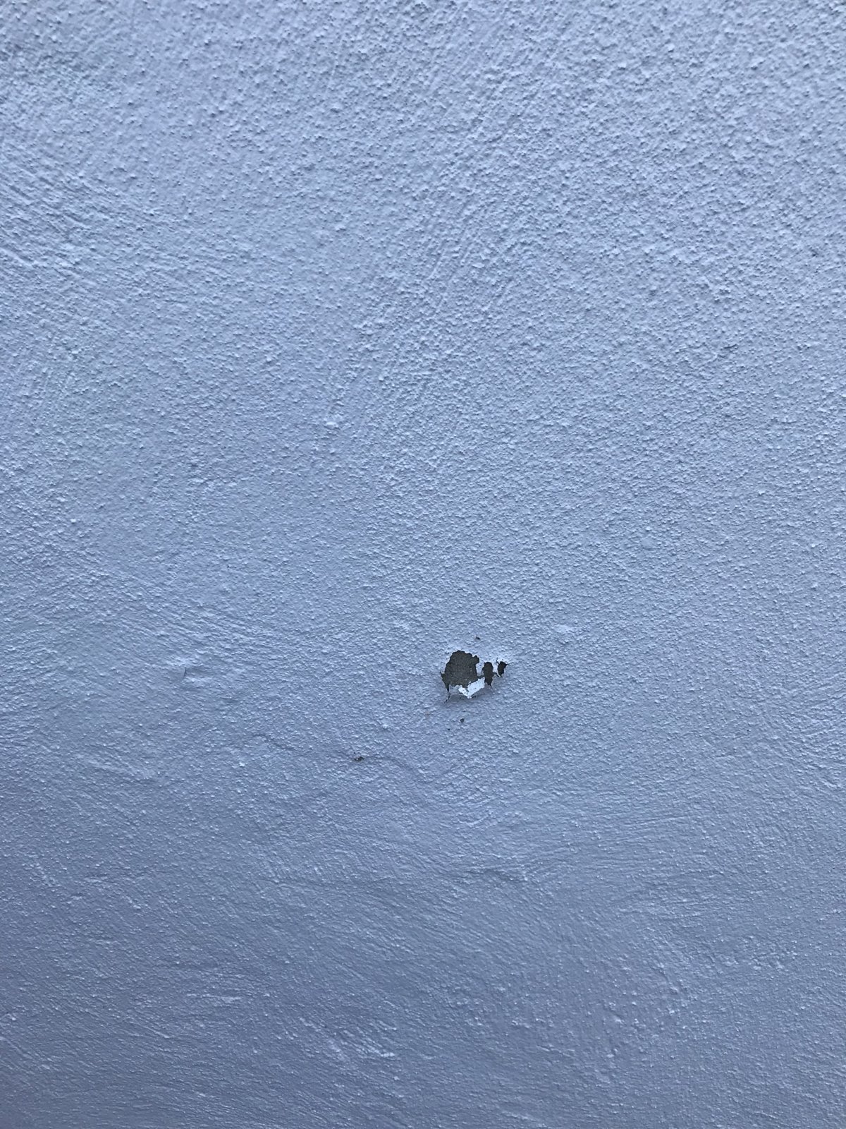

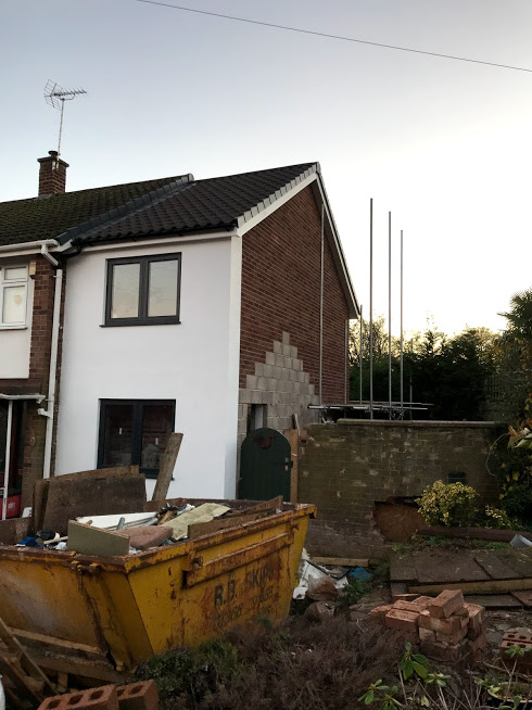

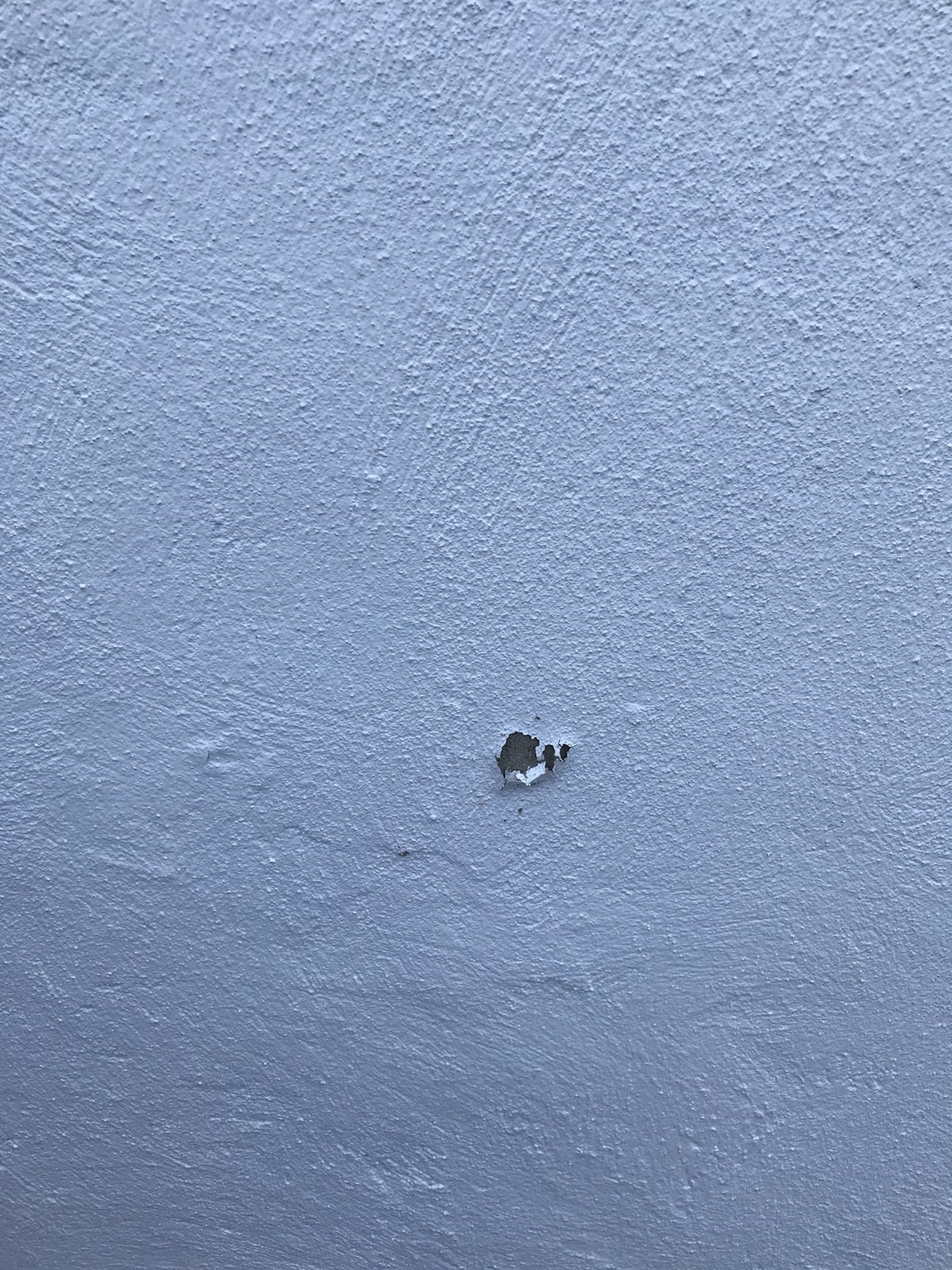

Gutted as masonry paint is now bubbling and coming off. Don’t want to duplicate posts as I’ve asked in detail over on the decorating forum. I feel a right muppet as it totally lets the job down and need to find a way to put it right. Suspect render wasn’t dried out enough. Moral of story don’t bodge/rush the paintwork as it can ruin the finished job
You have done a cracking job there. Looks very sharp. Brickwork especially. Just can't get over how tidy everyones site is..... I'm a disgrace.
With your painted render woes, take a deep breath and assess the situation. If it were me (which it may well be in a few months), I'd leave the paint for a few more weeks to do its thing, then get a scraper and some coarse sandpaper and go over the lot. Will be a days soul destroying work, but will get all the loose stuff off. Then leave for a few weeks and repaint.
Cheers, I've loved every minute of it to be fair, and am absolutely chuffed with it. Just embarassing re. the painting as it's such a schoolboy error, and its so visible.

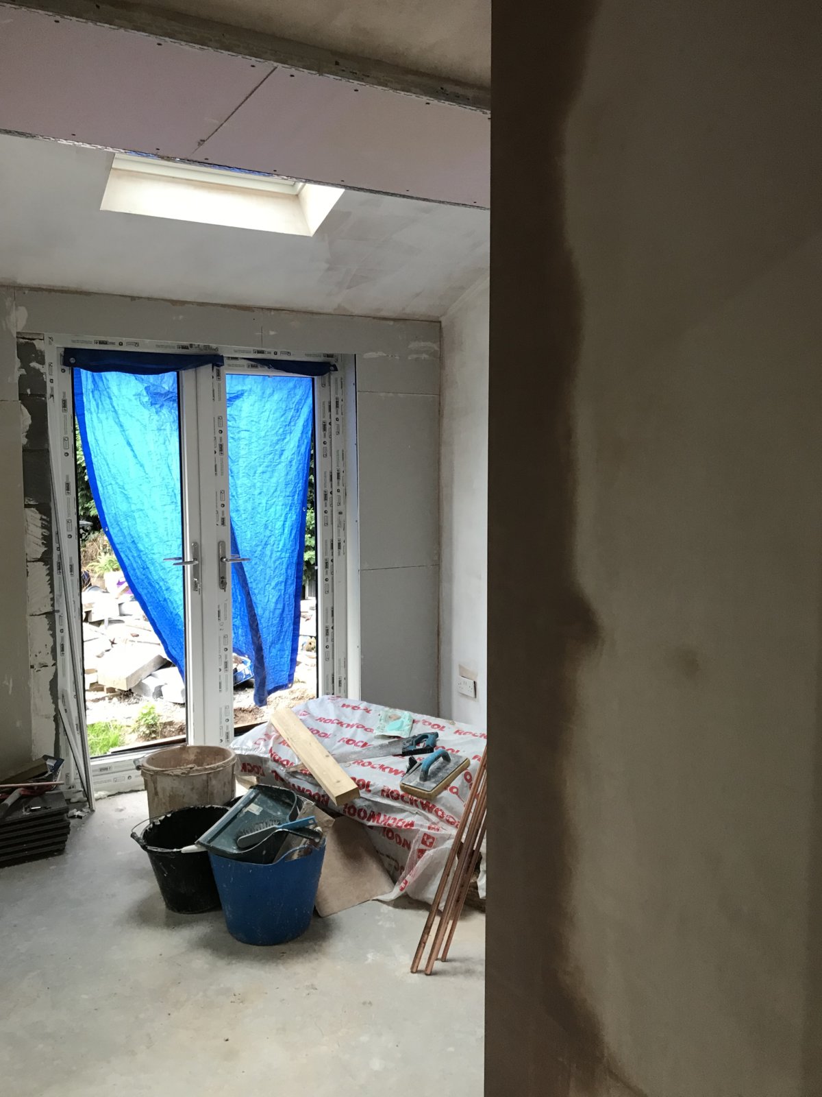

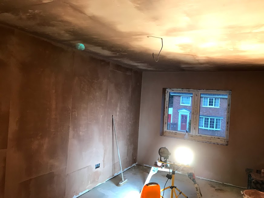

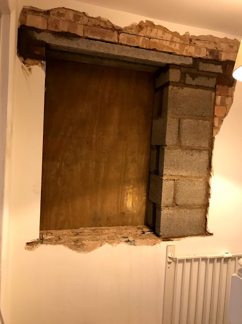

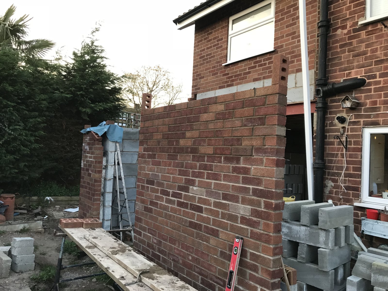

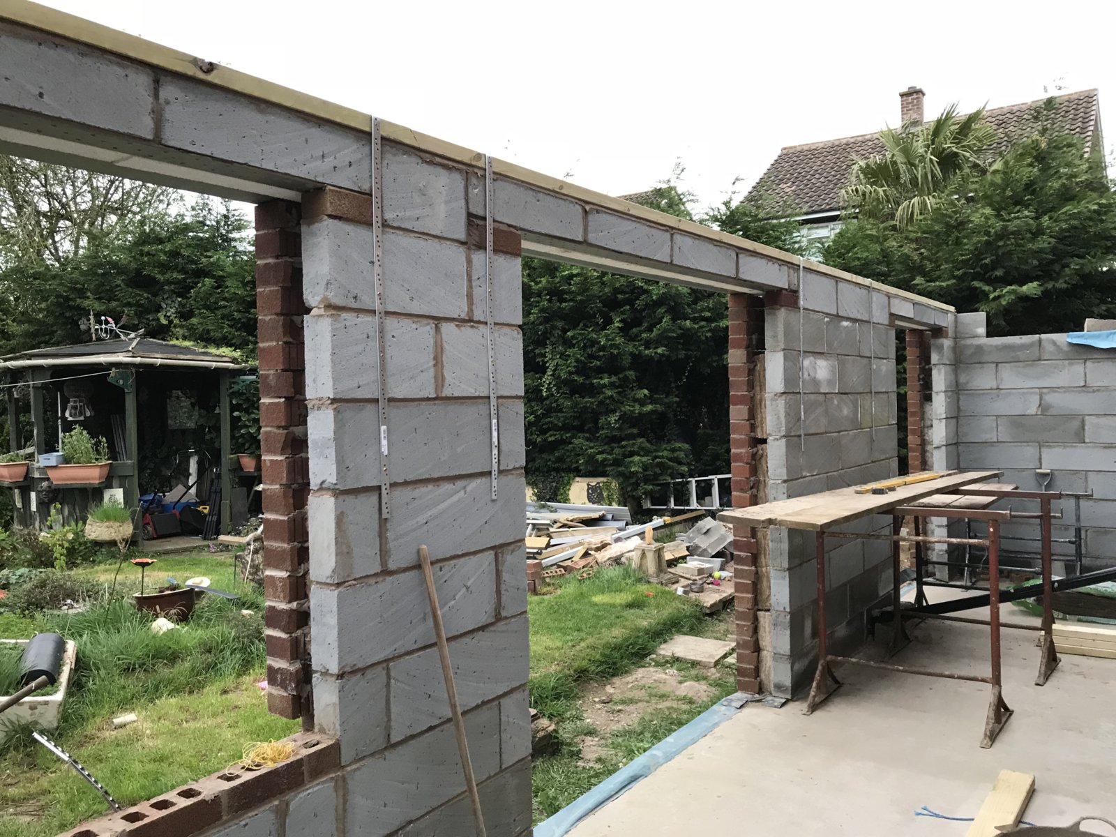

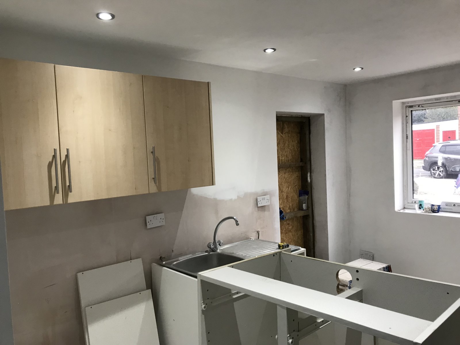

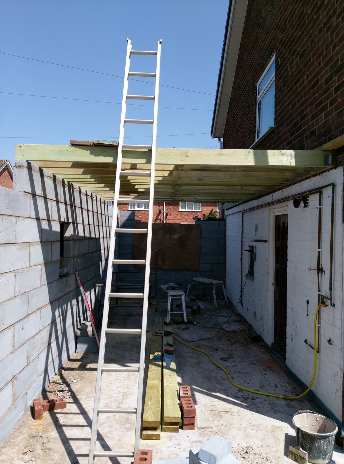

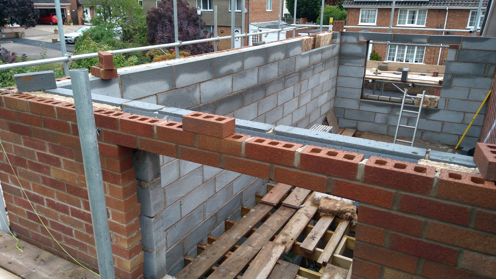

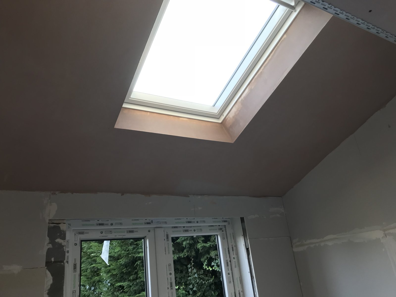

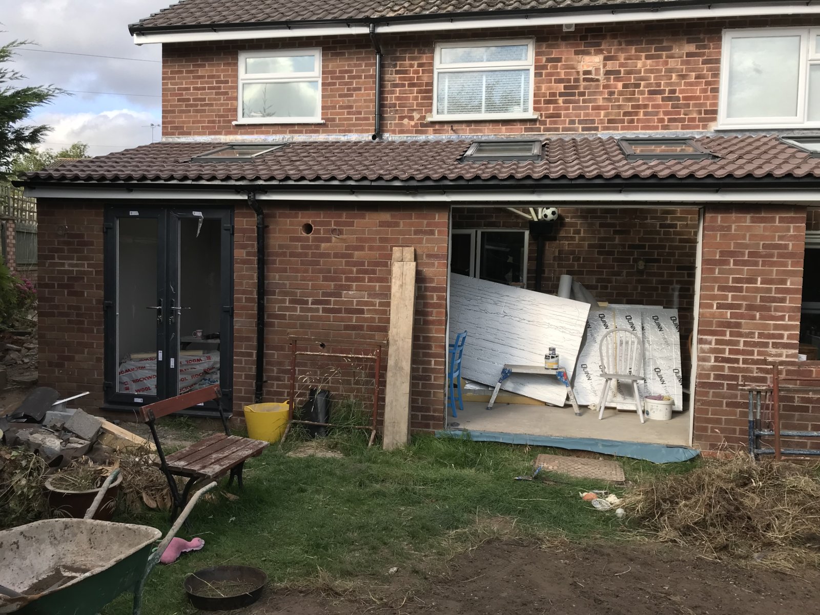

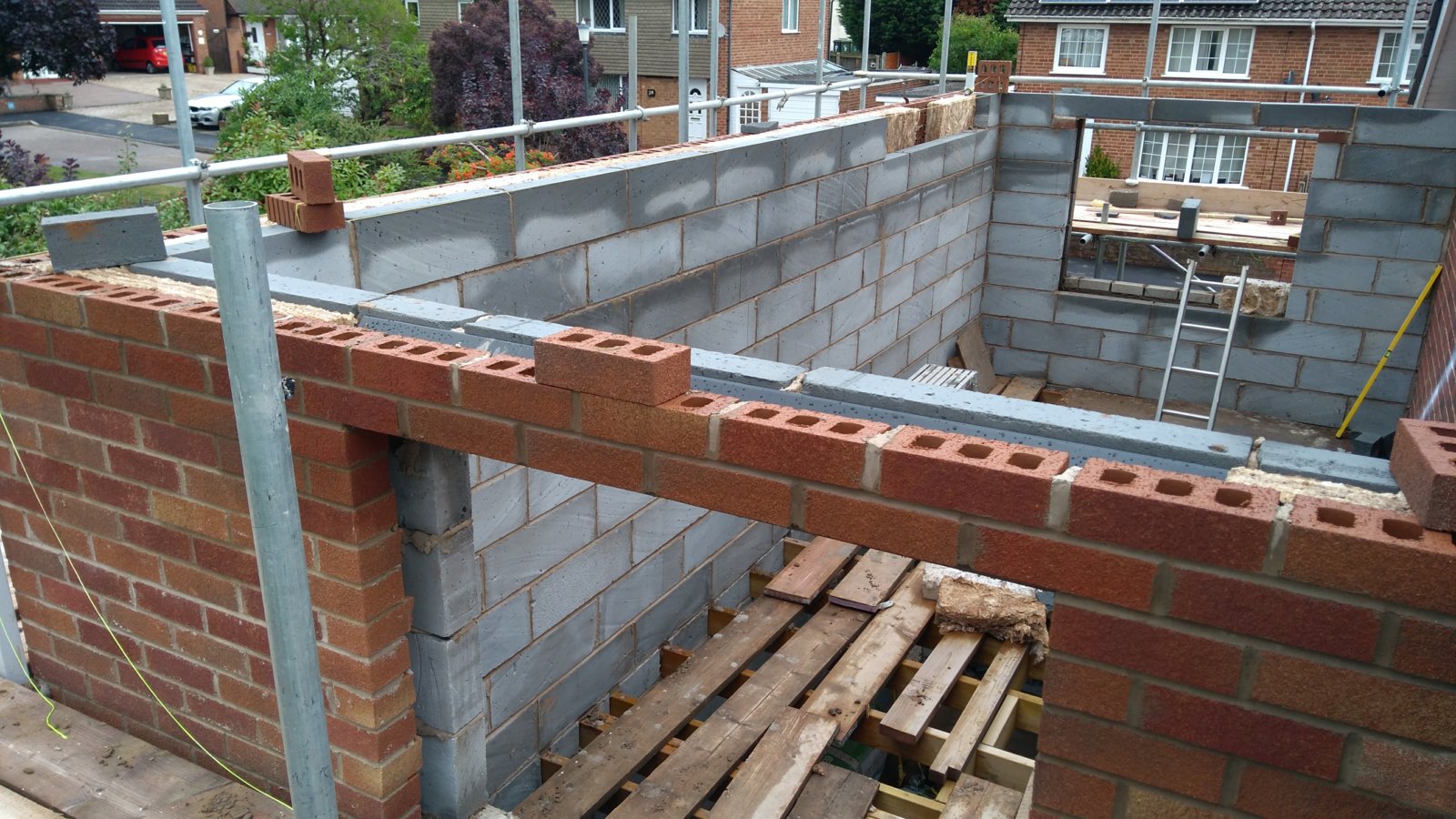

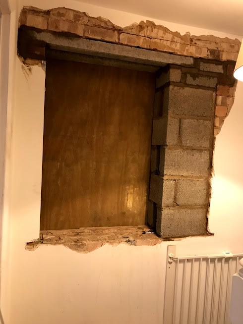

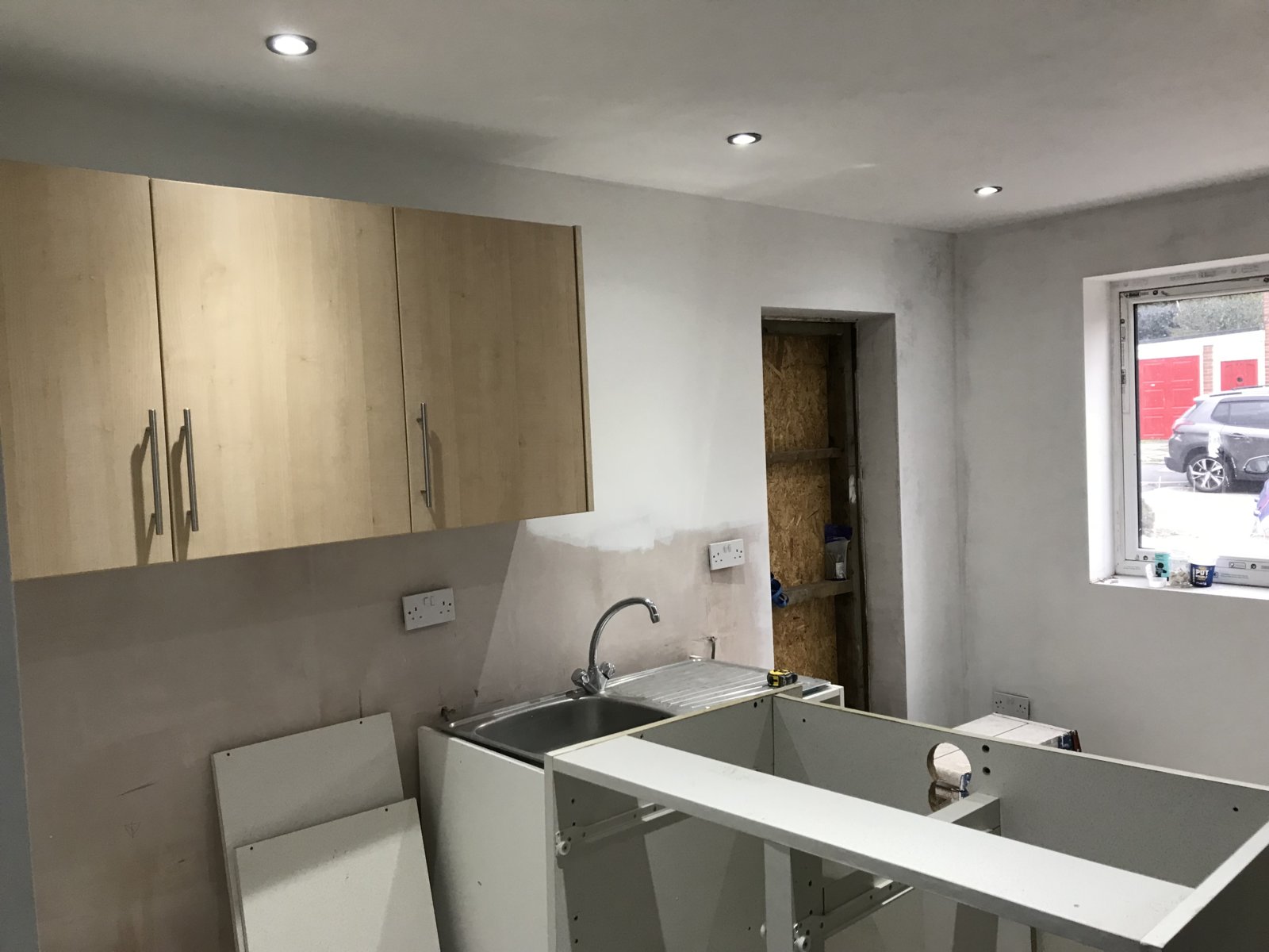

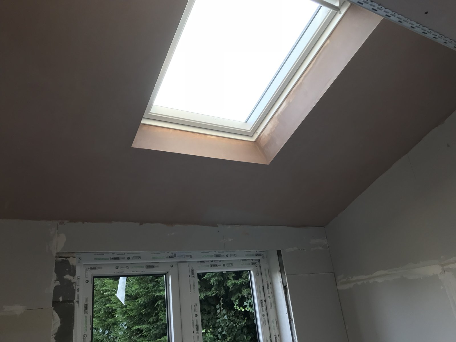

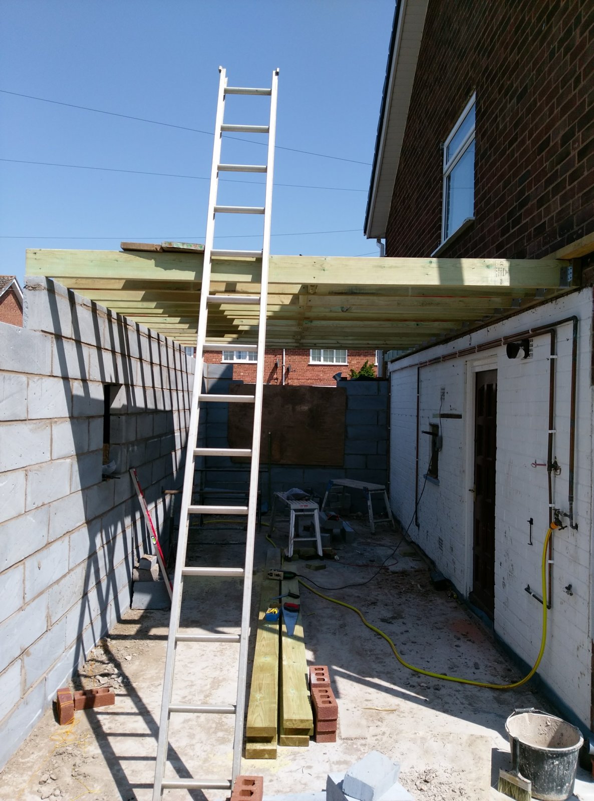

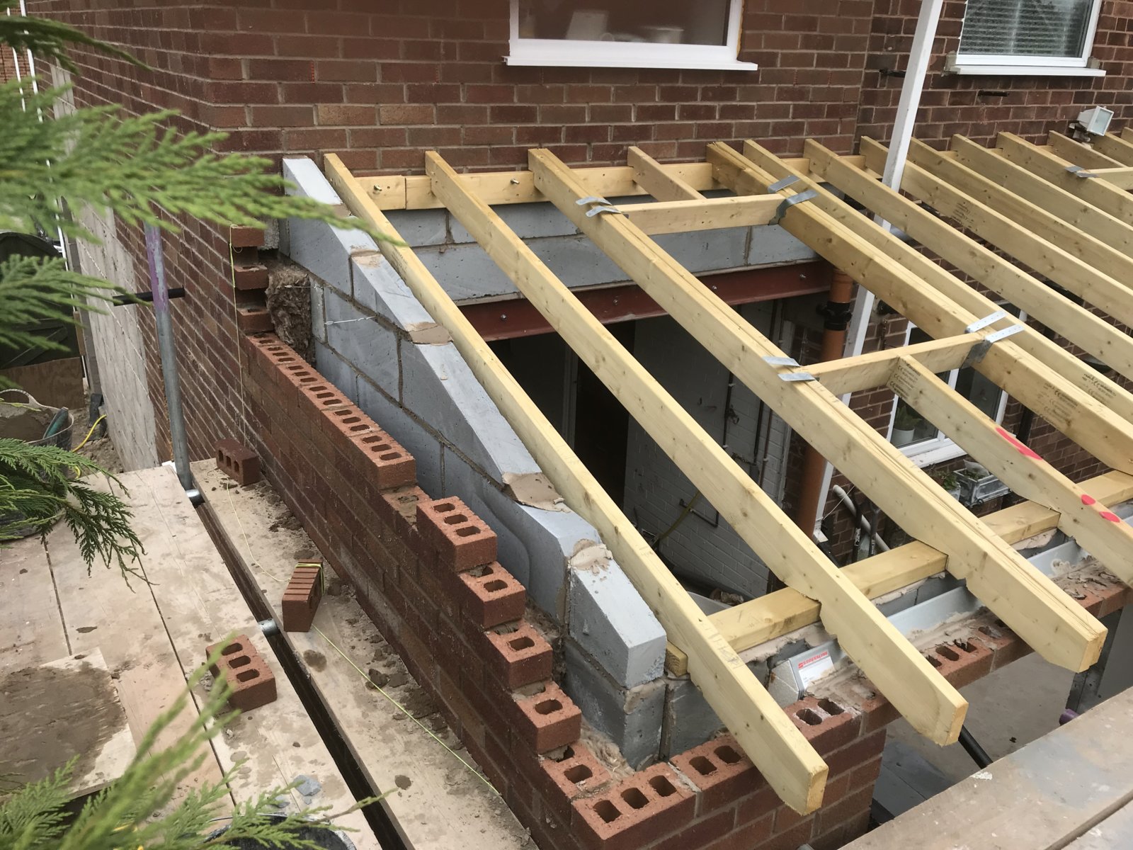

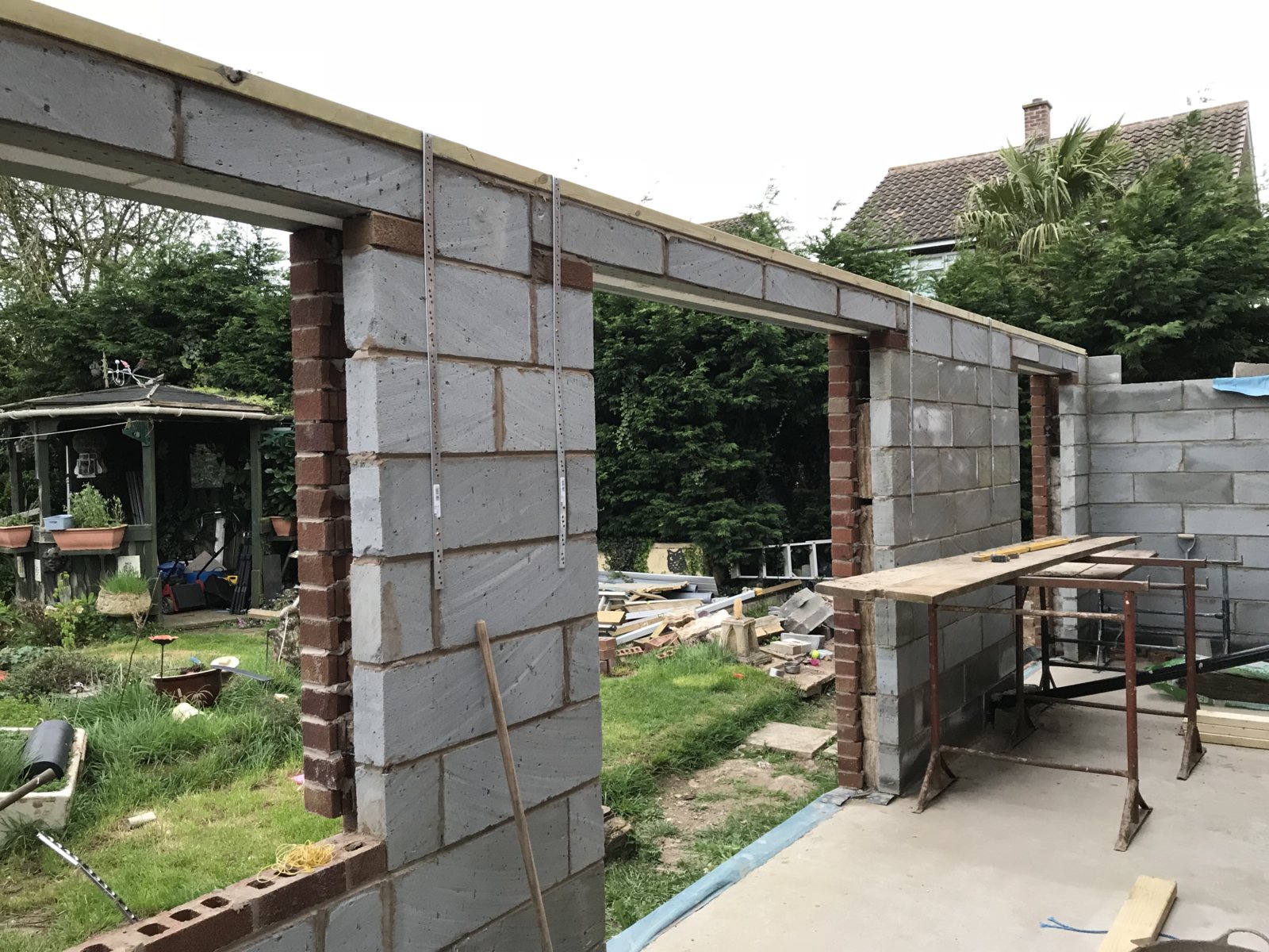

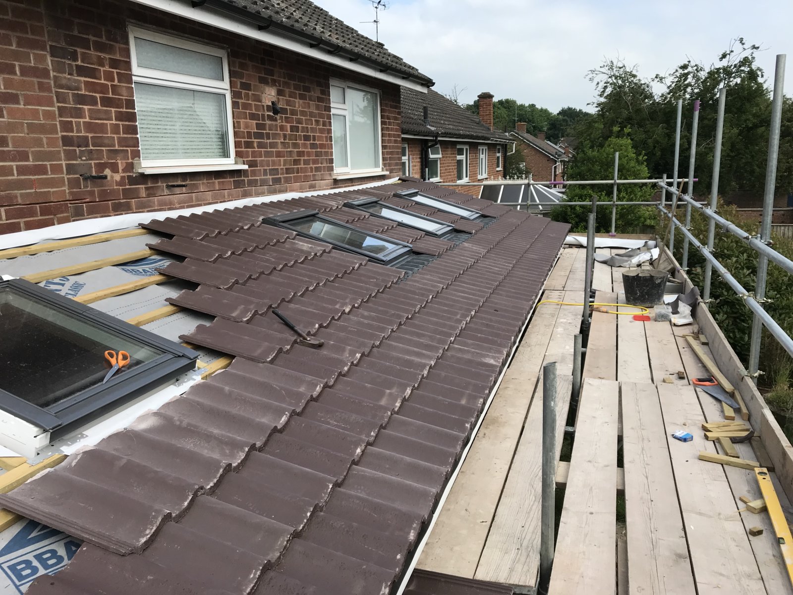

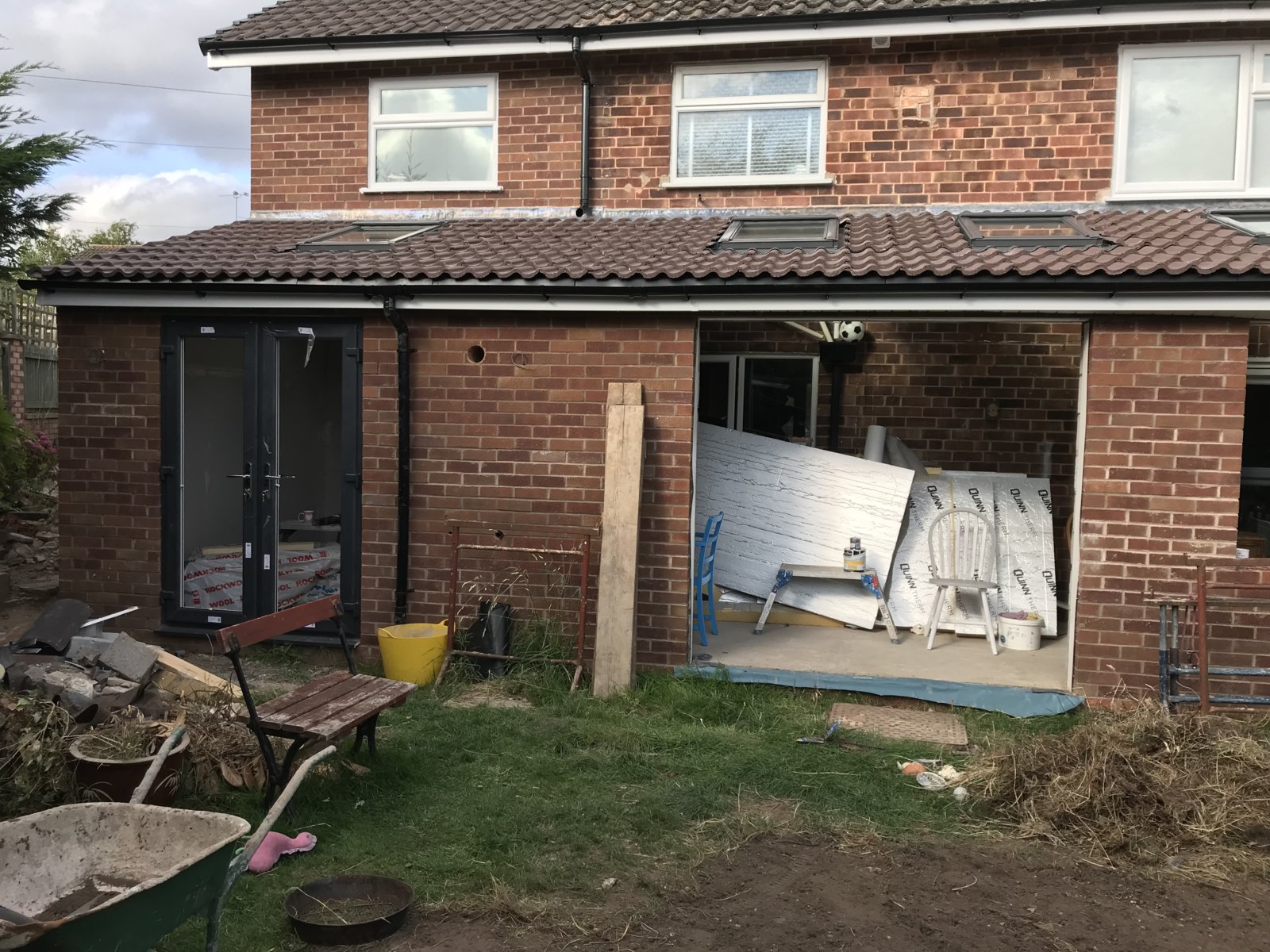

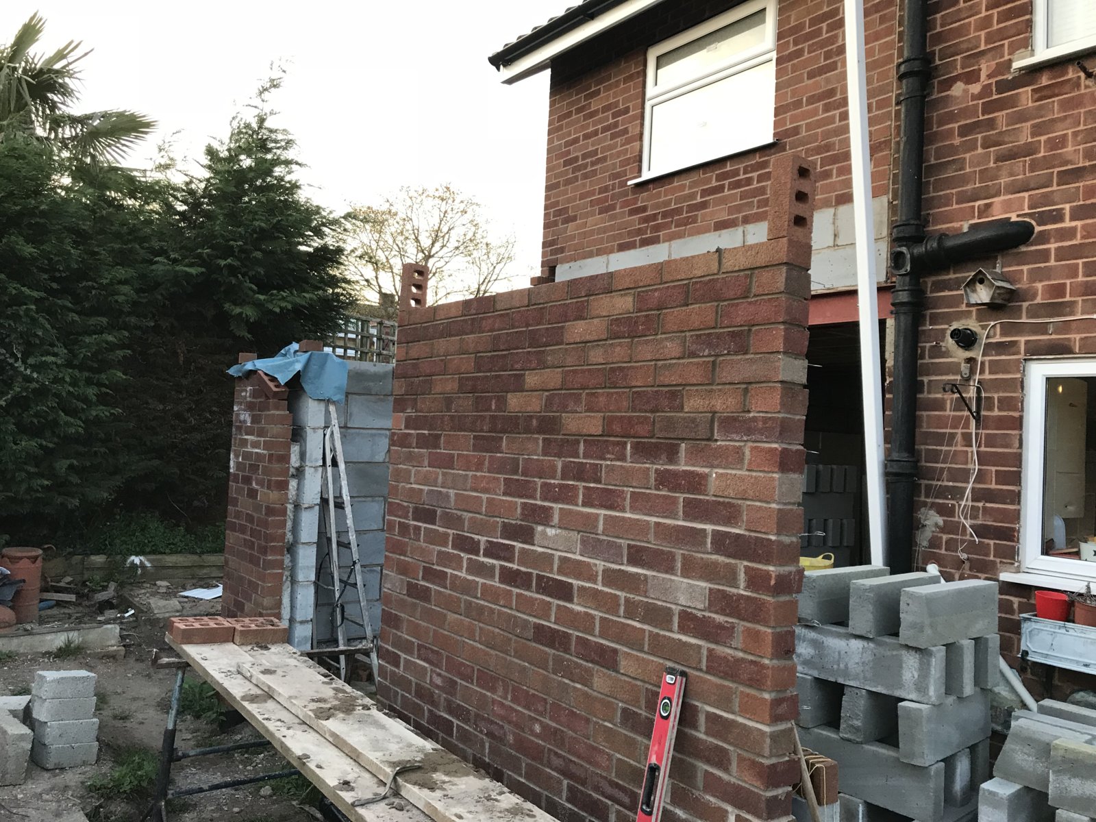

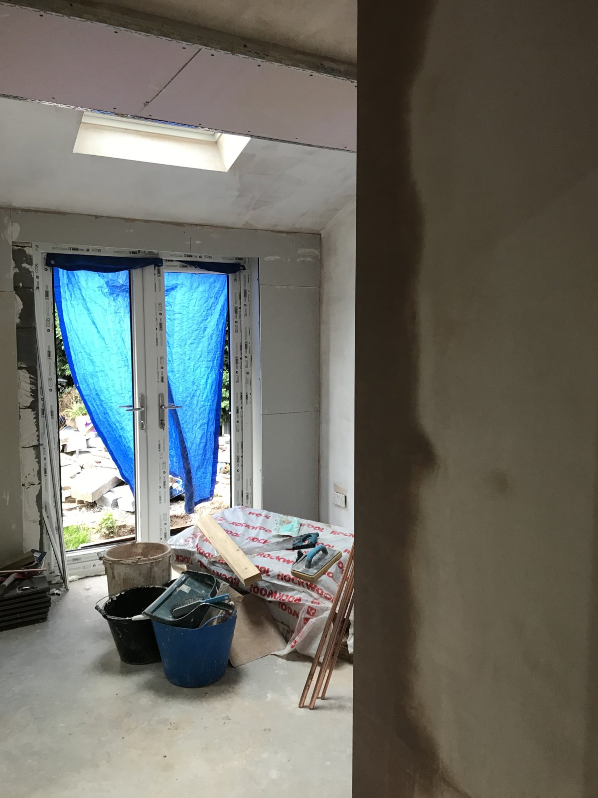

After a few months off with the arrival of second daughter (ok more like a few weeks off) started on the single story rear extension in March, and now plastering and awaiting the boiler to be moved and bifold doors to be fitted before looking at the knockout for the kitchen diner. Utility room going in which will also serve as a makeshift kitchen when doing the knockouts. Still loving every minute despite having even less time for it now.
