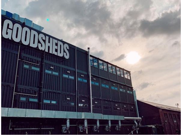

As said, by the time you fix two together to have something wider than 7’8” you have to weld/bolt them together. Finding an engineer who would provide structural calcs up to habitable specs for PP may be an issue. It’s one thing to make a container based food court or workspace but living there?
