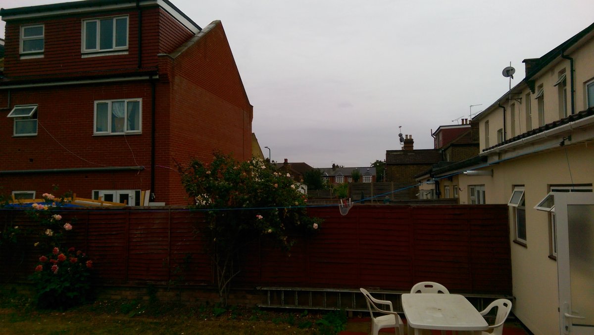

Chappers - Regarding harm, my Mum just doesn't go in the garden anymore, she just feels uncomfortable that her privacy is being overlooked by 3 different sets of tenants. Reverting the building back to a single family dwelling would be good (but they would be compelled to destroy the 3 kitchens though right?), altering the building back to 2 storeys even better, demolishing the building outright would be job done.
Just thought I'd attach a view from Mum's garden of the house built in red brick.
