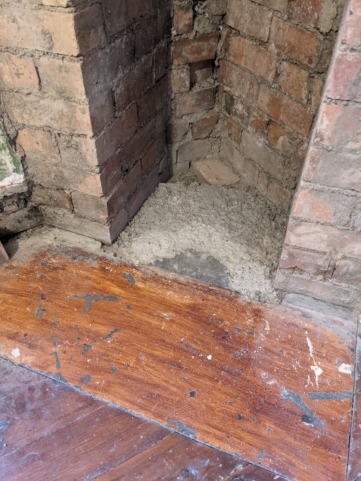

I've opened up an old fireplace and want to tile the hearth and the inside (floor) bit. I want the tiles to sit approx. with the finished carpet level (the carpet is not fitted yet)
Can I use self-levelling compound to 'raise' the hearth by say 10mm or would it not be strong enough?
I don't really want to remove the current hearth (which sits level with the wooden floor) as it is in a fair (and flat) condition

Thanks, I should add that the fireplace won't be used. It will just be decorative! So the "fireplace" is now just an opening with new lintel fitted and boarded up inside. I just want to have the hearth and interior floor of the opening tiled
Good idea about the cement board, I'll take a look, although I will still need to level the inside of the fireplace (I'm sure that bit has a name) as it is currently quite bumpy. I'm not sure what it consists of but it is rock hard and has stones in it, the house was built around 1900 if that's useful.

Slightly old picture but just to give some context, the sides and back has been boarded/skimmed now and the hole at the back fill with cement
