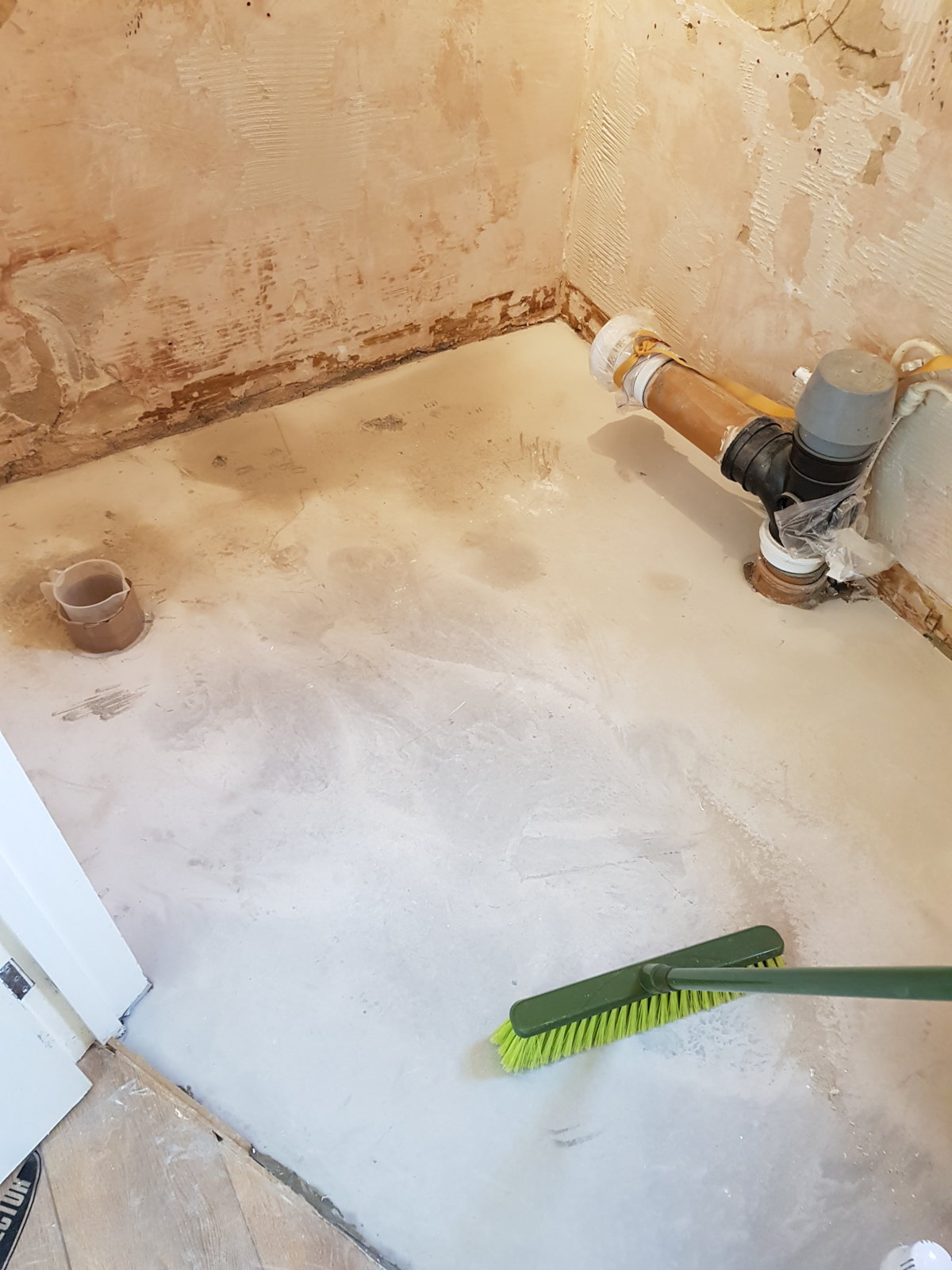

My husband and I thought we would try self levelling a small wet room (with existing concrete floor) to fit a shower cubicle and lay some vinyl on top. We primed the floor then after a couple of hours drying we mixed the Mapei Ultraplan 3240 from Screwfix in two batches (probably first fail) and then laid. It seemed to go on well, although the batches were slightly different looking. Fast forward to 24 hours later and half the room the compound is either still damp and not completely hard or has a white powder film and can be scraped off easily :(
Any advice on what to do would be appreciated as we are currently without a wet room and I'm 7 months pregnant!

If it's cement based without accelerator it wouldn't go hard so quickly. What does the label say for setting time? Was the dry material stored correctly and in date, hasn't got damp or been stored in damp conditions? Did the wet mixture dry out too quickly after mixing? Needs to set first and then dry, but it sounds like it's still wet which means it's still gaining strength

Instructions say "bonding time" is 3 days (which is when I presume it is fully hard):
http://www.mapei.com/public/GB/products/4048-ultraplanrenovationscreed3240-uk.pdf
So you may still be okay.
Big thing with this material is exact water addition of 4.25 to 4.50 liters per bag (did you do it by eye or use a measuring jug?), and good mixing (did you mix by hand or use a drill and paddle mixer?)
But as said, leave another day with door and windows open and see if gets better.

We used a measuring jug with half the bag, and mixed with a drill and paddle mixer, but perhaps didn't mix enough as there was some stuck on the bottom? The darker area by the door is hard and seems set(from batch 2), but areas further away are still soft (I can make a dent with fingernail) and they are damp. The areas further away from the door flake quite easily, so unsure if they will get harder? It has been about 27 hours now since laying it. I guess we could give it a day to see if it improves?

We bought it from Screwfix the same day so it was stored ok from our end, but cannot be sure what they did to it. The bag had tape in the corner so may not have been stored too well? The mixture didn't dry out that quickly and some patches are still damp now and a bit soft. Someone told us it was a DIY job, but thinking now we should have got someone to do it who had some experience!
SLC Drying time is typically 48 to 72 hours. Don't rush it. Did you get all the air bubbles out? That can make it feel soft and delay the drying time.

Hi, yes there didn't seem to be any air bubbles. It has been about 48 hours now and is definitely harder than yesterday. It seems quite easy to sand down in places though and I would have thought it would be harder to sand?
