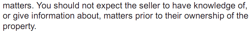

Looks like another case where they should have, if not used, taken a cue from the Law Society one, which says in the instructions to the buyer
That obviously makes sense but, if that is the guidance, the question should probably be re-worded so that "what it actually asks" is answerable (other than with "Don't Know") by far more people.
As Simon has said, the question is going to get increasing silly as we get further and further from 1/1/2005. Maybe it should ask about work undertaken during the seller's period of ownership?
