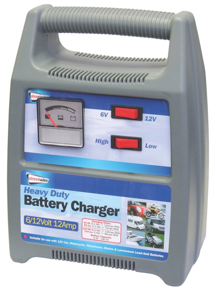

i have a SELMAR BATTERY CHARGER TURBO 12 it doesn't work any more after charger my car battery that i find out that is has a short circuit so i think is that what damage my battery charger :'( So i open it then i found that the Bridge Rectifier SB151 is cracked and it cause a short circuit, i search about it in internet but it looks that is not easy to find it, and i found others Bridge Rectifier that can support to 35 A, so i have tow question;
1 : what Bridge Rectifier can replace SB151 if i don't find it exactly
2 : after removing all wires, i tired remembering how this battery charger was wiring! but i can't :( ! I will be very thankfully i really need the wiring schema :)
The old battery chargers have no real regulation and relied on the transformer and rectifier being very poor quality so charge rate would drop as battery was charged, but although they can recharge a battery from dead, where the protection on the more modern types need around 7.5 volt to be left in the battery, one must consider if it is really worth repairing?
Today we tend to want battery chargers we can put on a battery and forget, it goes through stages and auto reduces the charge rate without boiling the battery dry.
With a heat sink yes you can fit a different bridge rectifier, but as to how wired I would need to open mine up to see, and mine still works so not doing that, it is only used with completely discharged batteries, once they show 7.5 volt I swap to a fully automatic charger.
Older Optimate smart chargers need 2v, newer ones 0.5v to sense battery connection and start recovery.
Personally I would put that charger in the bin and buy a new one!.

I use a Lidi battery charger, similar to CTEK but a lot cheaper, gone is the ammeter, it has a volt meter, plus a row of LED's the whole idea of these modern chargers is however to recharge a battery and maintain it ready to use, they do not fast charge. This charger
ae235
is nearly the same as what you have, and it still has a place when for example you have not closed the boot properly and now the car will not start, you want reasonable rapid recharge, 1/2 hour often enough to then start car, but the Lidi charger
has only a 3.8A output at best, a 60 Ah leisure battery is fully charged in 48 hours from completely flat without any need to top up electrolyte or disconnect, it can be left one for weeks, but instead of 1/2 hour before you can start car it will likely take 2 hours, and if it becomes disconnected it will not auto restart once power returns, you need to press the mode button. Great for my caravan battery, or the wheel chair battery, normally if the car has a flat battery I am in too much of a hurry to use such a small charger.
