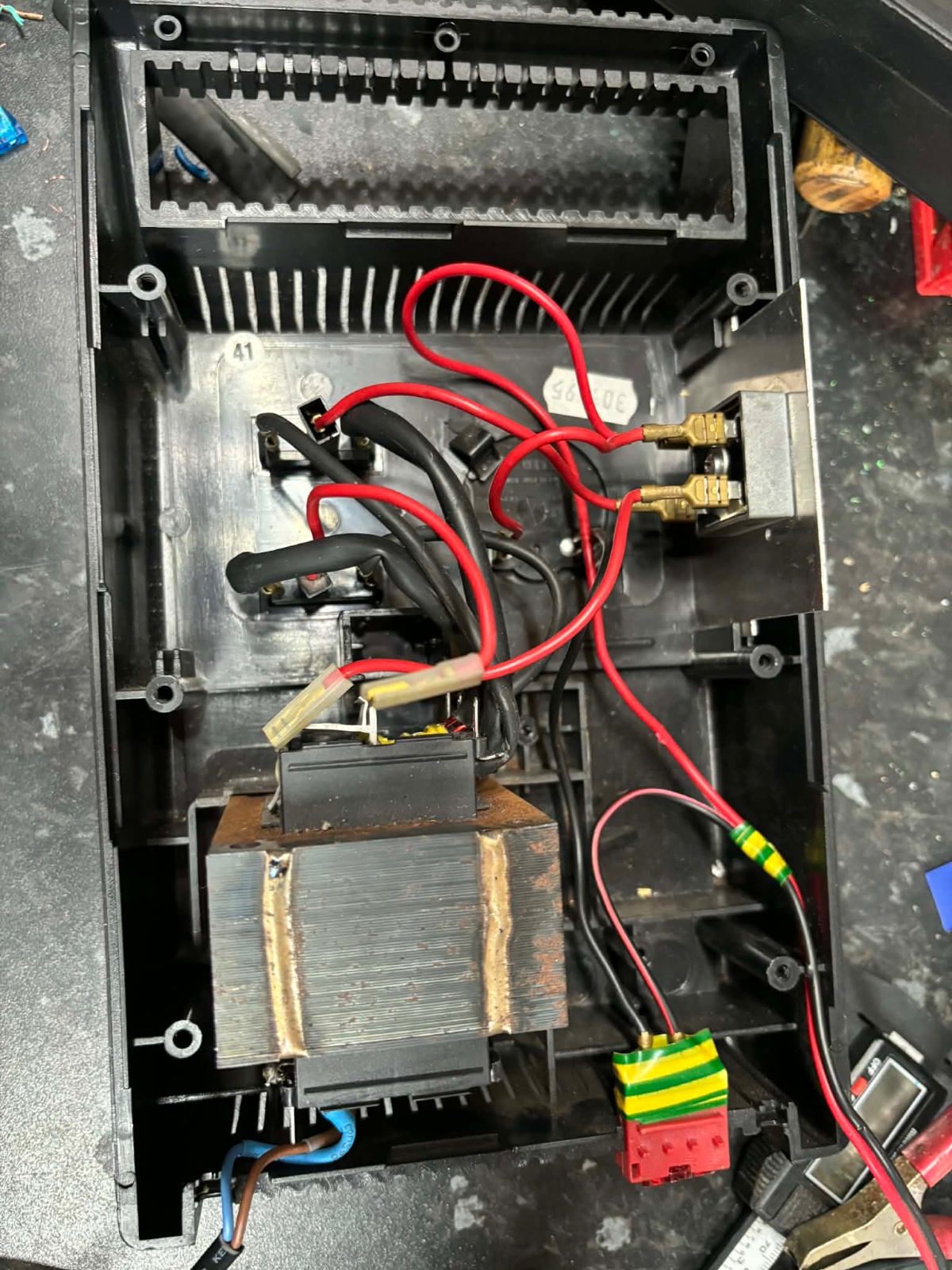

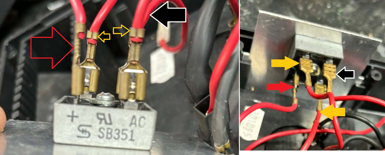

Hello Everyone,
My name is Jay and I have a Big favour to ask this community so I have an Automotive friend in his 80’s who still rolls around the floor repairing and maintaining his Classic cars like his Morris Minor and Talbot Sunbeam, he bought some joblots on eBay and it had a Selmar Turbo 8 Battery charger but was completely disassembled now he has tried to put it together and I believe it’s not far off.
What I’m asking is I think he’s wired the Bridge Rectifier Wrong as he melted the 15 amp Thermal switch attached to the transformer which I have a new one coming for it but whilst I wait I’m reaching out to see if anyone can look at the pictures I have to see if the wiring is wrong or can show me photos of other Turbo 8’s to see the actual way the wiring goes as I don’t want this man to hurt himself or set fire to the History in his collection.
I can relay some information if needed but I don’t have much on the item itself and I have minor understanding of electrics enough to wire up things and Soldering PCB’s etc but with the age of this Charger I want to cast a call for help.

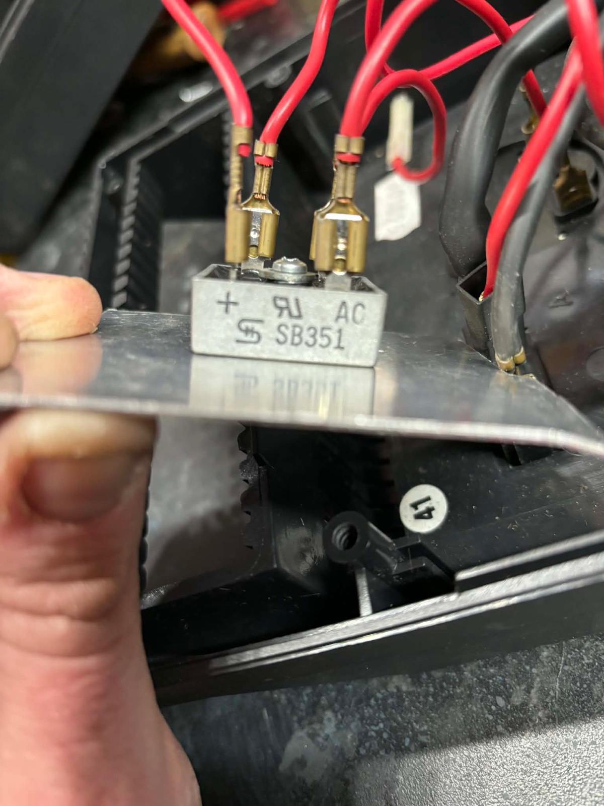

The AC transformer outputs should go to diagonally-opposite terminals of the bridge rectifier. The other pair of terminals are the rectified DC outputs. Observe that one of the terminals is rotated compared to the other three; I think that one is the positive output (Edit: indeed it is marked as such in your last photo).
Does that help?
Does that help?
So the + on the side indicates that spot is for the +Dc output (aka Red lead) and if I’m reading what you say correctly your saying the -dc is diagonal to the positive and
The AC on the side case means +AC goes there and diagonally to its counter part ?
Correct!
There is no positive or negative to AC, either on either terminal, is fine they are marked by a.....
Alternate current, AC symbol

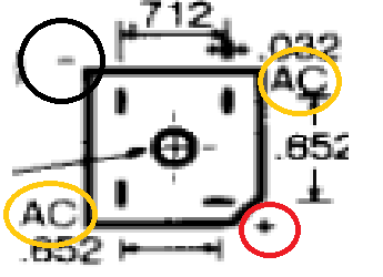

These rectifiers are usually constructed with opposite pins AC but the markings do need to be checked.
'A' spec sheet for them
confirms that but do try to check the device you have.

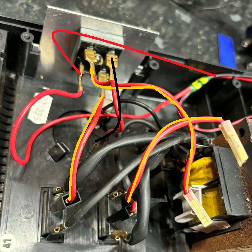

The markings seem to be clear so the 2 AC pins need to be wired to the centre of both switches (via the thermal trip) and polarity doesn't matter. Shown yellow
The black output wire via the fuse and meter to the '—' pin shown black
The red output wire to the '+' pin shown red

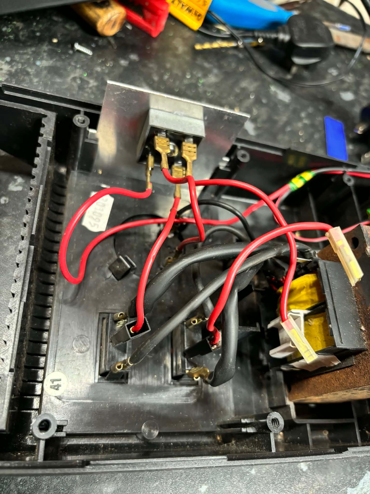

It does look as if the 2 top spade connectors are swapped over
Does this help with how I think it should be
My concern is the 4 black wires from the transformer have been moved which would require very carefull testing to put right
'A' spec sheet for them View attachment 404152 confirms that but do try to check the device you have.
The red output wire to the '+' pin shown redView attachment 404150
Does this help with how I think it should beView attachment 404154
So as far what he’s told me was the transformer connections (black cables) where never touched or removed from the 6v-12v or 4amp-10amp switches it was the original main lead was junk all Red leads were removed from the Bridge Rectifier as well as the Rectifyer and the base reverse polarity Blade fuse.
Yes the diagrams you provided have helped drastically I know i don’t have a wealth of knowledge in this area but appreciate all the help with this as I would rather me make a mistake than him in case he dies and I have on many occasions said he needs a more modern charger doesn’t have to be the latest models but something better than this but like many Classic Car enthusiasts he stuck in his ways so if I can get this working properly I know he will be safer than what he tried to do.

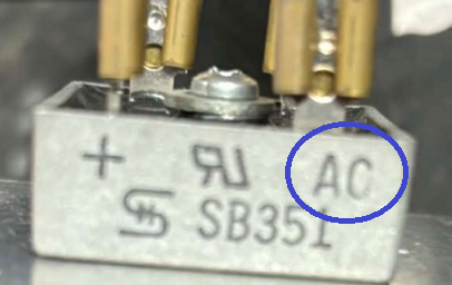

I may be blind but I couldn’t see the Tilde symbol on the rectifier or the spades can you see them in any of the pictures I uploaded so I can be aware of the area for future reference.

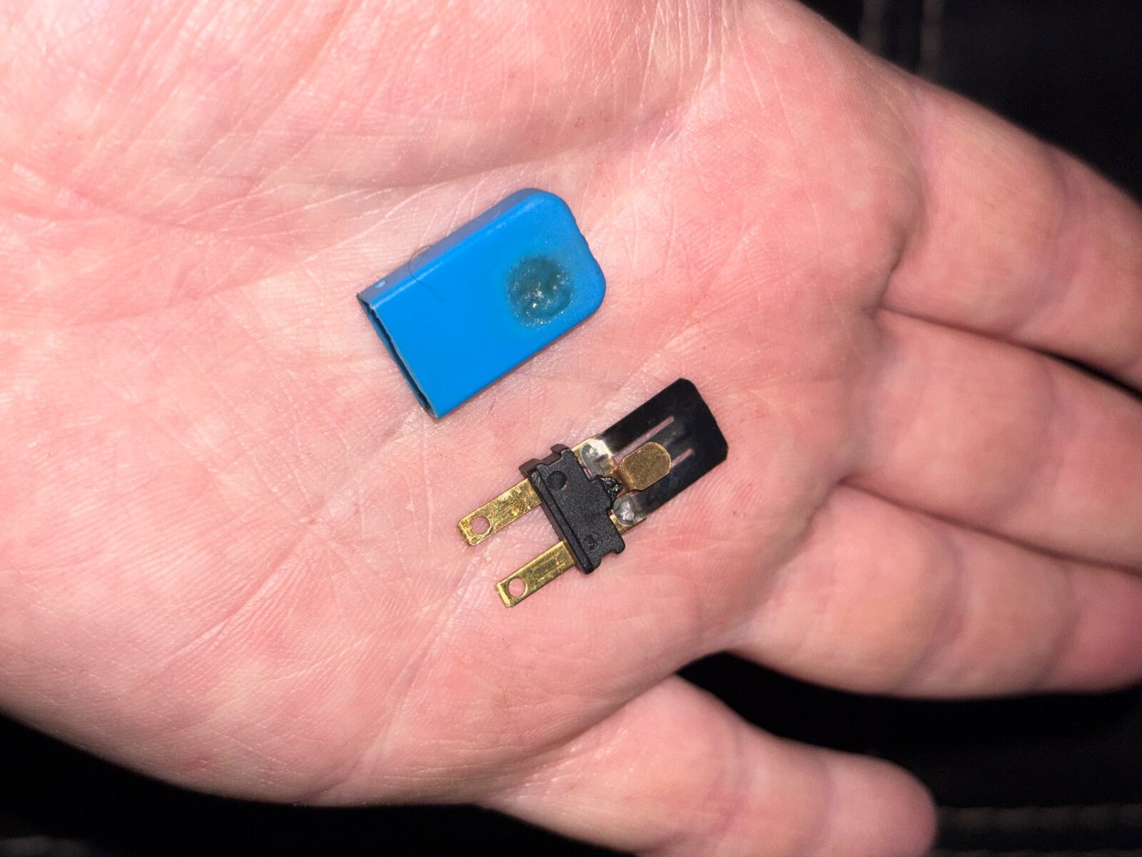

Yes he melted the Otter G6 Thermal switch
Kind regards
Jay
The rectifier in the picture is marked with ' AC '
rather than
