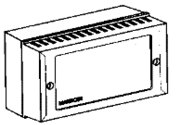

Does anyone know of an SELV fan that has a transformer unit that will fit a 2G box?

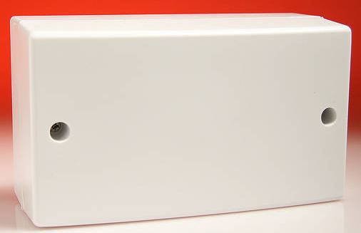

Per what BAS says, I think most current Manrose ones are the shape/size of a 2-gang accessory (my daughter has one), and are designed to be able to be attached to (but not in) a 2G back box. However, they are 60-70mm deep and all of that will then 'stick out'.Does anyone know of an SELV fan that has a transformer unit that will fit a 2G box?
I don't fully understand what they mean by "will go in a 2G box" - since the Manrose box itself clearly won't 'fit into' a 2G back box.Just rung Manrose Tech. They say it will go in a 2G box. Apparently, the front cover of the unit is different, but the unit will still fit.
that part could be attached 'onto' a 2G box, but would still stick out 30mm or so in front of the box.
still sticks out a fair amount though.
I've personally over ever 'surface mounted' them.
Indeed. If the innards are all attached to the front half of the box (which I'm pretty certain was not the case with the last one I used, albeit 2 or 3 years ago), then 'flush mounting' just that front half of the box would mean that it would only stick out about half as much as if it were 'surface mounted' (i.e. ~30mm, rather than ~60mm).So, if I "flush" mount it, it will stick out less than if it were on its surface box. That's what I'm after.
