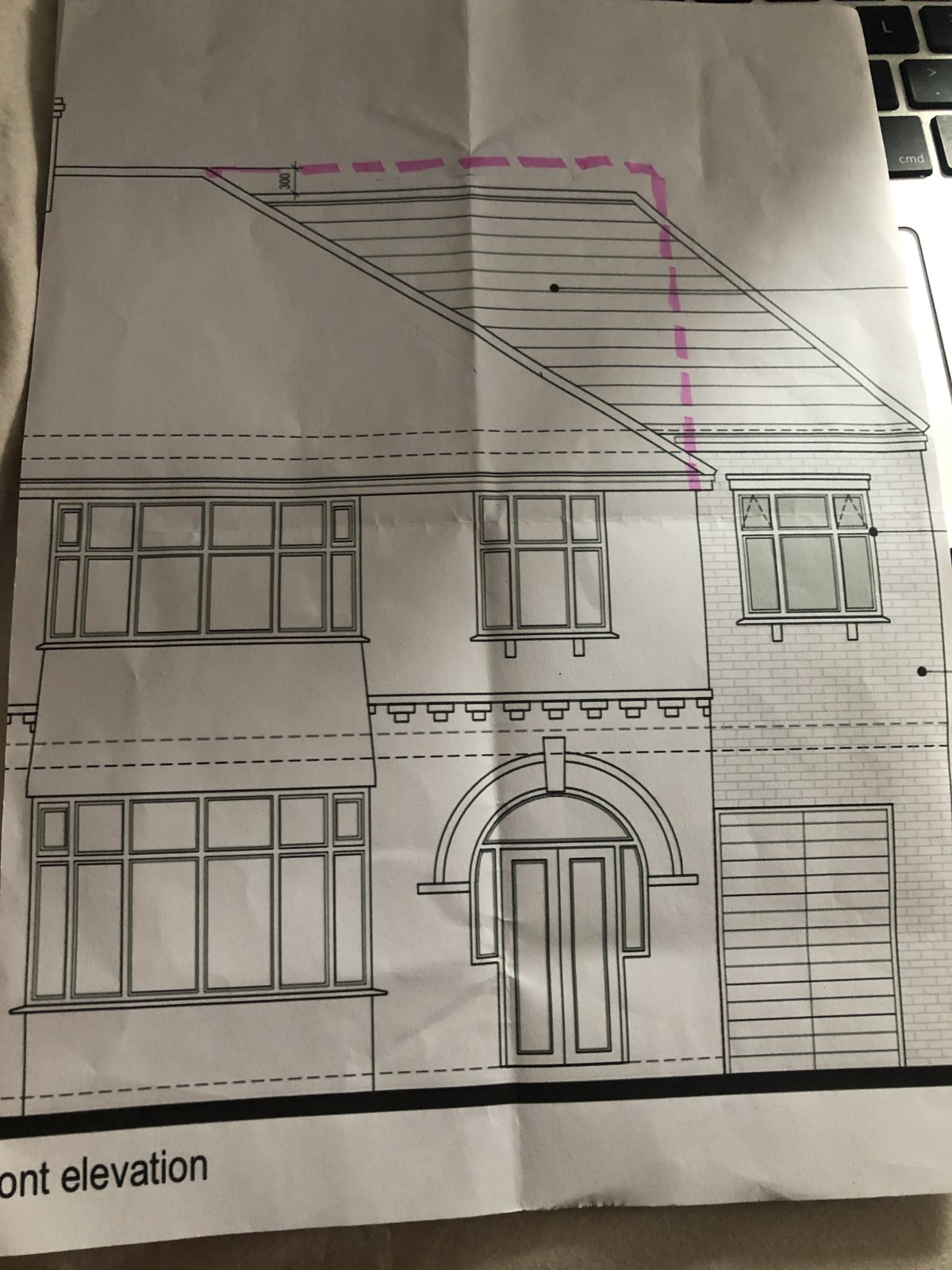

ok so here goes, il try explain as best as i can. My head is a bit battered at the moment
I have a 1920 semi detached house with a hip roof. Ive built a double side extension (2m wide) that’s currently at eaves level. We have decided to make space of the large loft space and convert it so Ive recently applied for change of roof, we put in for a continuous roof with the 2 hips starting at the start of the extension (external wall of the original house). The idea was to completely strip out the traditional cut roof, install steal ridge beam and re build with 6x2 and get rid of the purlins, this would of gave us plenty of space for the bedroom and bathroom. However the council are not supporting this at all, they want a dropped ridge so that means an extra hip and valley at the front which massively cuts off head height internally.
Im aware a hip to gable conversion is covered under PD, how would planners react if i lodged an application changing the original house roof to a gable and then building a hip roof on the 2m wide x 8m extension that would tie into the side of the new gable wall.
Im thinking it wouldn’t be as simple as that for some reason, maybe because i have an extension being built at the moment, Is timing an issue.I.e would i have to convert the house roof before i changed the current application for the extension roof.
I do plan to put a dormer on the back under PD but ive not informed the council about that yet, they are being arsey as it is
Massive thank you to anyone who takes the time to offer me some advice or tips to get around this.
Purple dashed line indicates gable roof

If you’re planning a hip to gable roof extension under PD and then also wanted a hipped roof over the new extension that would join to the new gable wall, Planning would expect you to first build and substantially complete the PD works first. Once you have built out the PD works, you would then have to submit a formal Planning application showing the PD works ‘as existing.’

I’ve already been in talks with them about allowing me to have a continuous ridge line that ends at the external wall of the house and then goes into the hips when the extension starts but they will not allow it, they want a dropped ridge that’s 300mm lower than the house ridge so this would create the extra hip rafter in the middle of the front of the house.
I don’t mind the hipped roof on the extension being stepped down, I can use this for storage as the extension is only 2m wide, my main goal was for a continuous ridge line so I didn’t have to have the extra hip on the front of the roof. However with a gable conversion I will have no hips over the main house which is basically what I need.
