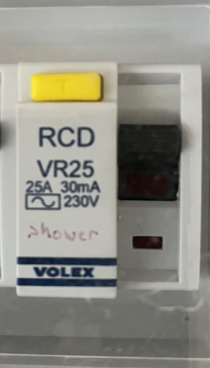

Hi Chaps, I'm thinking of putting in a 3KW handwash for a new bog and want it wired to an RCD for safety. There's already a 30mA RCD for a 150w power shower. Could the handwash be wired into that or does it need its own separate one?

Well - IF this RCD that you mention is an RCBO (i.e. 18mm. wide device that looks like an ordinary circuit breaker), it supplies nothing but the power shower and has a 16A rating or higher, then you could connect the handwash to it.
It is unlikely that this will be the case unless the power shower is protected by a Fused Switch as well.

Thanks for those very helpful replies. I appreciate you taking the trouble to respond. It's a Volex RCD (VR25) rated at 25A / 30mA, and it's 35mm wide. The shower does have a fused switch. I'll try to put a photo below.
Next we need to know what rating (Amps) is the device (fuse or circuit breaker) in the consumer unit that controls this circuit.
Thanks EFL. The fused switch has a 3 amp fuse. Then the mcb in the CU is 16 amps. The shower is the only device on this circuit.
Ok, then all is well.
You should connect the hand wash cable directly to output of the RCD or the input of the Fused Connector Unit - assuming the cable from RCD to FCU is not too small for the current.
1mm² T&E or 1.5mm² flex or larger will do if the cable does not pass through any thermal insulation or other suchlike.
It might be a good idea to fit a 20A double pole switch before the handwash in case it develops a fault so you can switch it off and still use the shower.
Fantastic. Thanks very much for that EFL. That's really helpful. Thanks also for the suggestion for the 20A switch, which was going to be my next question. All the best.
