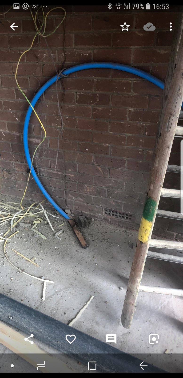

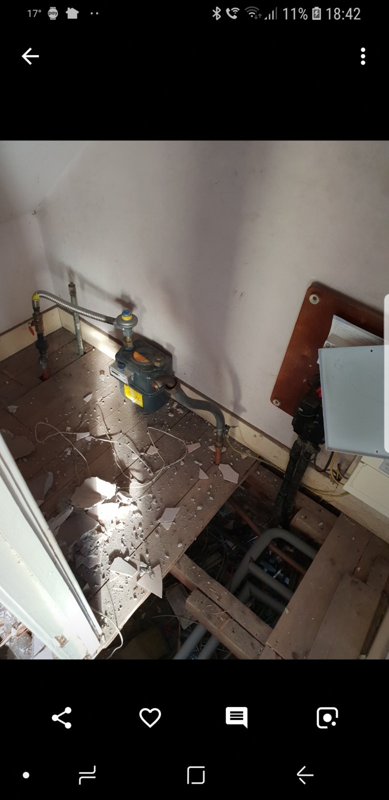

Hi,
Been having soon building work done (extension and renovation) and things seem to have gone fairly well up to now.

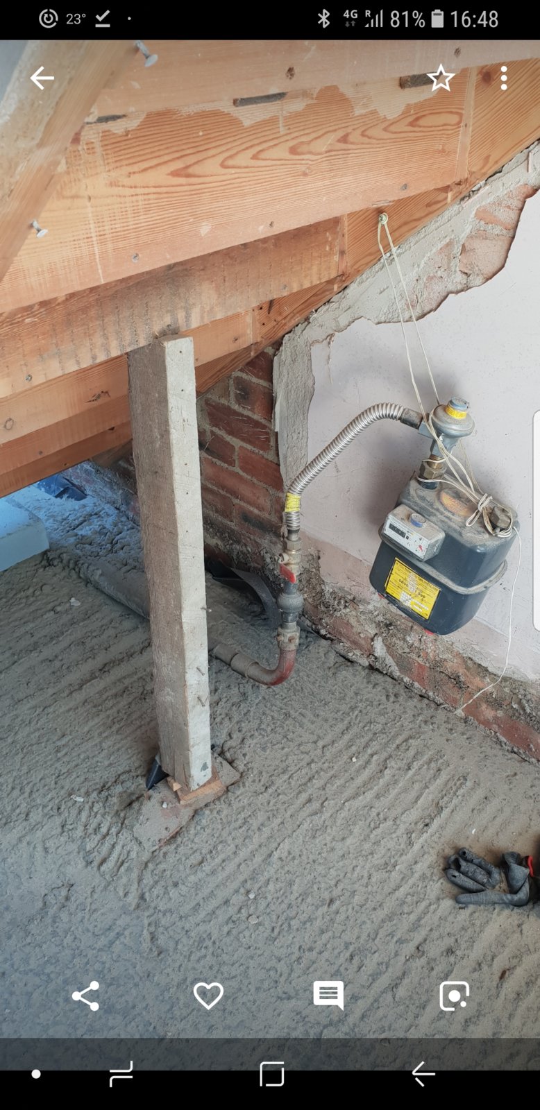

Anyway, I had an existing suspended timber floor taken out and filled with concrete to convert to solid.
Under the previous suspended floor was a 400mm void and the gas, electric and water came in at the front door and laid across the concreted sub-floor to their respective points of presence up through the suspended timber. For gas and electric this is under the stairs.

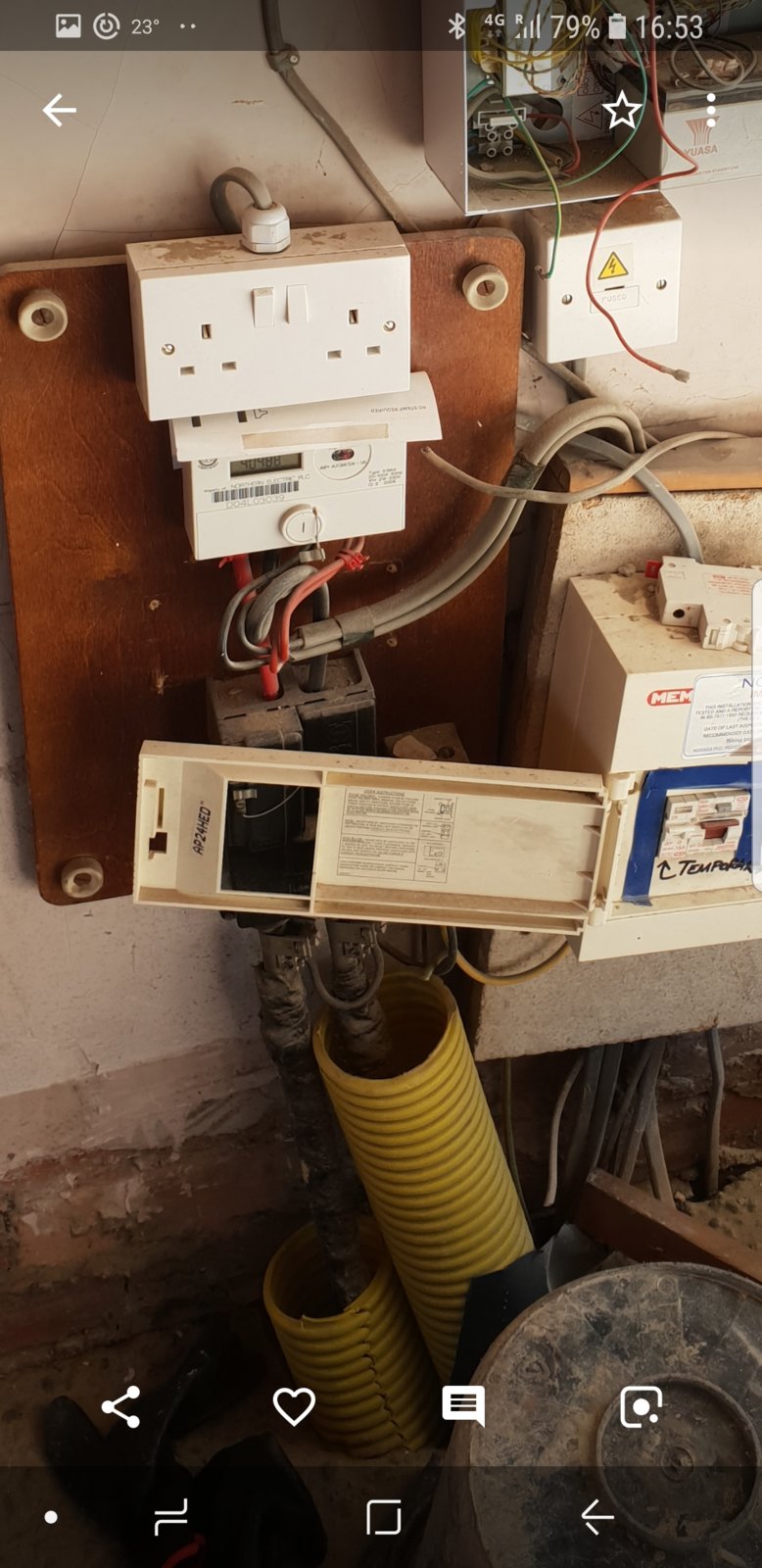

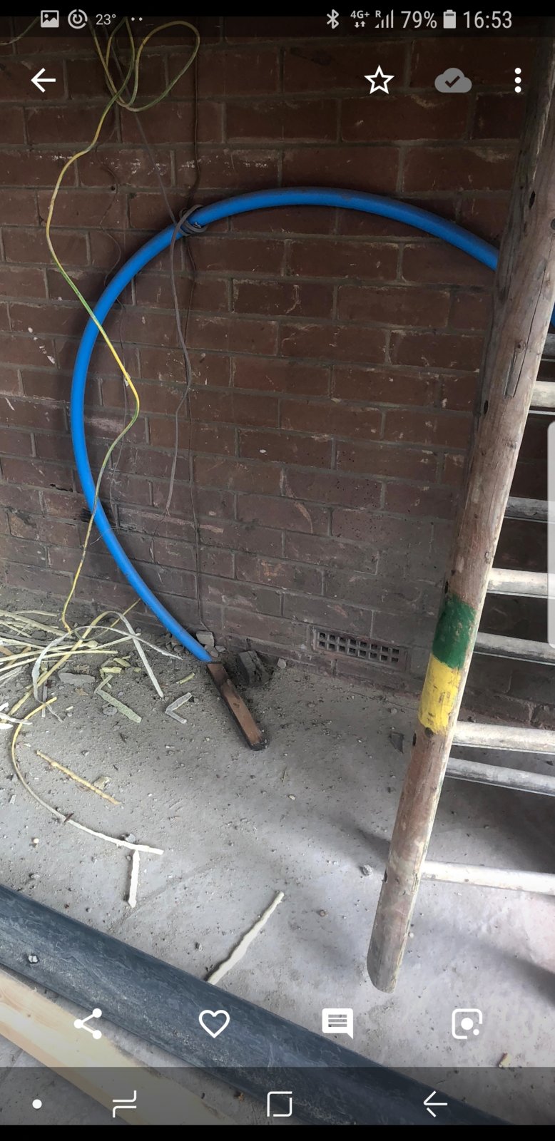

However when the builder potted the concrete they have only encased the electric it seems in conduit and not the gas. A new blue water pipe has also need installed but again no sleeving of any kind.
I asked the building inspector about it and he said building control are not responsible for services entering the building, which I don't l find crazy, especially where just a h&s risk such as gas is concerned.
Anyway, I've attached some pictures for comment. Any advice as to what I should do here? I've notified the builder but not had a response as yet.
Screenshot_20180617-165337_Photos.jpg Screenshot_20180617-164825_Photos.jpg Screenshot_20180617-165306_Photos.jpg
Thanks.
Cavester, good evening.
The one that is giving me concern is the Gas pipe
As I understand things, the gas pipe and its installation is the responsibility of the supplier, up to the meter, and this work must be undertaken by a supplier who has the "Authority" of some body like "British gas"
The Meter is as I recall the "Property of" the Gas Board, not you.
After the meter, the gas pipework is your responsibility and your Chosen Gas Safe fitter, as an aside does your builder have access to such a person??

I'm not sure that method of supporting the meter is the one taught on the ACS course.
Did they bend the pipe up and concrete under it?
Conduit for electric should really be identified with black colour.
I think your best bet is to get the gas and electric services moved outside, unfortunately that would be a couple of grand, but short of leaving it as it is there's not much else ii ca think of.
Thanks, yes I'm a bit annoyed by this given that now the concrete is poured there is no easy asy out. On the electrics, assuming they have put conduit along the whole cable then I'm fairly comfortable with this, yet I'll never know! Ok it's the wrong colour but I'm not concerned about that. The incoming supply to my house then routes through the party wall to next door so no way I'm I going to recable.
The gas is the most concern to me. I don't understand why they would put conduit along the leccy but not the gas!? If that pipe fractures then it's going to be A: dangerous and B: an expensive nightmare to put right.
However, looking through pictures on the net I do see a lot of pipes just coming through concrete without conduit. Is this how it used to be done before h&s regulations etc. were brought in?

What exactly is the problem?
Water - looks ok?
Electric - looks ok?

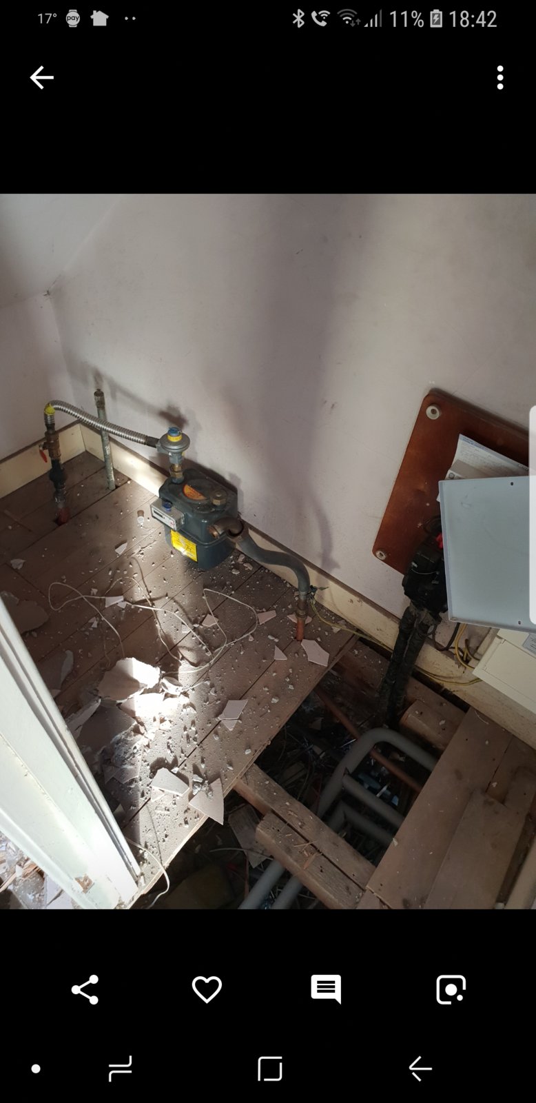

Gas - usually the builder leaves the gas where it is, builds up the external walls and builds-in an external gas meter box on the line where the gas enters the building. The gas company then dig down and locate the service and install the meter into the new box. This is usually done once the joists etc are in place so that the domestic supply can be re-routed and hidden if needs be.
Typical progress of a building site at this stage.
What else could the builder do whilst excavating, prepping and pouring a concrete floor beneath?
Cap off in place of the anaconda? Or leave itit fixed it to the wall. I suspect it's like that because they have levered up the old service pipe from the sub floor
Given itsi already capped off after the meter the anaconda isn't conveying any gas anyway
So is the method of installation acceptable? I've spoke to the builder and he said they will cut it out as sleeve it if I want, yet didn't seem to feel it was an issue the way it had been embedded in the concrete because it was lagged.
