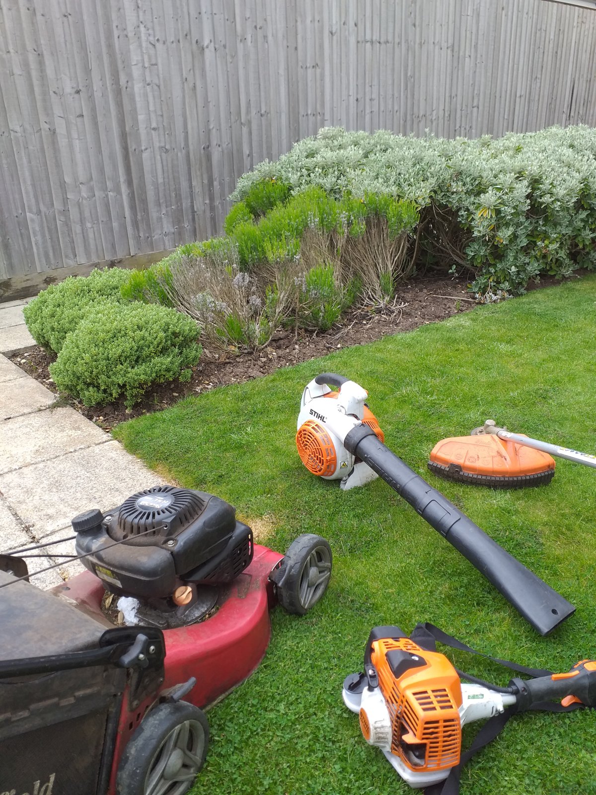

The mower's petrol cap keeps letting petrol out. Any idea why? Regarding my tools-
Stilh bg86 blower
Stilh Km 94
Plus my hedge cutter attachment strimmer attachments, prining saw attachment for km948
I have a small husquvarna hedgcutter-
https://www.toolstoday.co.uk/husqva...MIssf9m7qO4gIVWfBRCh0GYw9hEAQYASABEgIh7fD_BwE
How often should I get them serviced? And what kind of servicing? I use them once or twice a week. Usually once week. Mower maybe more
Regarding the mower, either its the wrong cap, the gasket is missing or the threads are worn.
Regarding the two strokes, keep the carburettor area clean and clean the air filter.
The mower needs an oil change, plug and maybe an air filter every year, plus a blade sharpen.
As for the hedge cutter, the gearbox needs regular lubrication.....are you prepared to DIY?

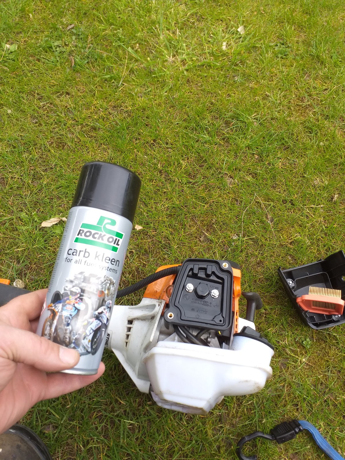

I've taken cover and filter off my stilh km94 do I spray carb cleaner on that black plastic thing?
The engine seems to not rev too well and cuts out in last week
The machine looks brand new!
The paper type air cleaner can't be cleaned, just get a new one as necessary but it looks unused from here.
If the machine seems to be low on power, try it without the air cleaner and see if it improves.
Are there any screws on the side of the carburettor marked L and H?
John :)
John :)
I take it the black plastic thing under filter is carburetor. I'm looking for screws but cant find any marked L and H. I took paper air cleaner out ut same thing . Keeps stopping if I rev too hard. The power isn't there. Had same problem just after I bought it. The guy said he cleaned carburetor out and it worked well again. I might have been adding two much two stroke oil to the mix, is that the problem?
Yes, the carburettor is behind that black plastic housing......8mm nuts holding it on.
If you have added too much oil to the petrol mix, the smoke produced will be excessive....it will have to have been seriously overdone to reduce the power output though.
The carb may well need a clean, which is pretty involved if you haven't done before.....if it starts to stall after high revs its a sure sign of fuel starvation. A dealer will sort it for you, and he'll probably fit a diaphragm and gasket set - genuine parts being around £16 from Stihl and maybe an hours labour.
You are certain the choke is completely off when you are using the machine? Some chokes come off automatically, some manually....I don't know which system yours has.

The choke is off. It automatically comes off on that machine when u rev. When u say fuel starvation, do you mean the carb needs cleaning? I'll try and get that plastic thing off and maybe spray in there
