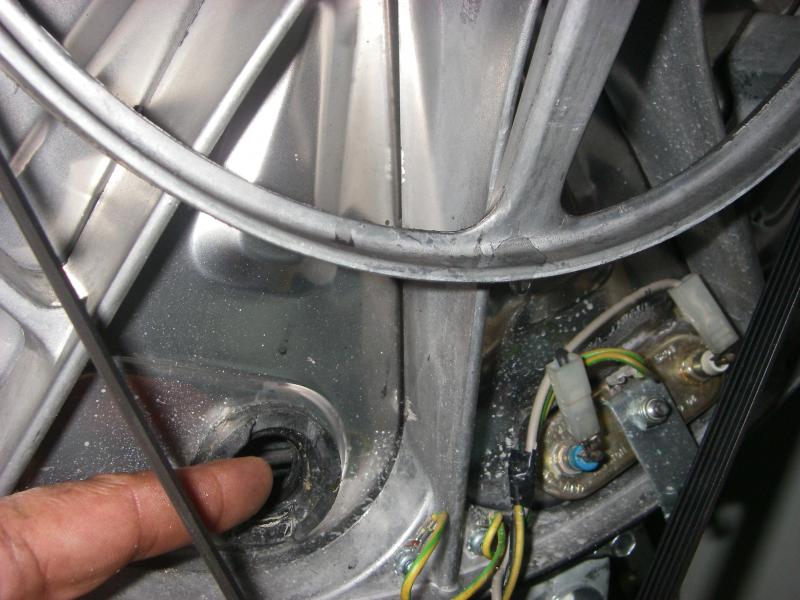

Hi all, I'm new here but hope someone can help me, the above washing machine has developed a leak which comes from a sort of rubber seal on the back of the drum and it just pours out as soon as the machine is switched on, I would like to know if this is repairable and if so is it cost effective? Hope someone can advise me many thanks in advance,

Can u put a pic on. Think it might be a thermostat gommet.
Sorry I don't know how to attach a photo! the place the water is coming from is like a drain plug and if I look through it I can see the inside of the drum, I hope this helps you in your quest to help me,
thanks again
Looks like it's a blanking plug is it split have you tried silicone sealent or chemical metal to seal it for now.
Sorry if I have'nt described it very well, it can't be a blanking plug it appears to have a hole through it as a drain hole would, approx 1" dia with a groove around the outside wher it fits onto the drum, I don't think this is the problem just where the water is escaping from,
sorry if I've confused you,
regards
I think I may have managed to put the pics on
As i said I beleive this is just an escape route,
thanks
rocks1, sorry m8 I do appreciatte your advise but I need to go to work now, not being ignorant but I will look in again tomorrow, once agaiin thanks for your help.
It's a blanking plug some drums have a thermostat in then yours don't and it's perished. I can't answer after 9am tomoz as I'm going to egypt perhaps someone else can help tomoz
Ok thanks anyway, I don't think it is a blanking plug because it has a man made hole in it and this is like a type of overflow for a problem further inside the drum, although I really know diddly about washing machines.
