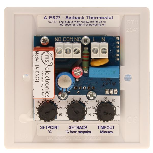

Very expensive at £208.64, but why? Found some instructions but clearly not the one I found in the caravan used for our holiday. The problem was 23°C too hot, and 18°C too cold, and waking up at night at a very low temperature not I would hope down to 5°C was not funny.
It was not helped when one could see daylight through the door jamb, and the wall were so thin, sure thinner than my old touring caravan.
I would guess the 5C, was the temperature minimum, when the place was unoccupied, to prevent freezing. The 18C was the normal-occupied setback temperature, though it suggests even that, will time out, after 10 hours. I wonder if it might have an occupation sensor/PIR, to retrigger the 18C?
That is the MI for the one in the pic?
The stat seems to work in dumb mode, in other words it has three positions - 5deg setback frost setting, 18deg normal setpoint and 23deg boost.
The 10Hr run won't be controlled by that device I don't think. I think that may be the sites heating/power system timing that dictated that, was it electric?
OK - So It may have been that the actual heat source would only have been active via it's own timer for those 10 hrs, though that does seem a bit strange given the fact that if it was very cold the caravan would obviously drop to a very low temp outside those 10hrs.
That would probably have been a conversation that would have been had with the site managers at the time methinks.

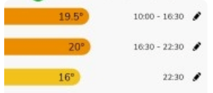

Yes, I set living room heating at home to 1760353988083.pngwhich does not seem to cost us much, but my house a bit better insulated to the caravan.
