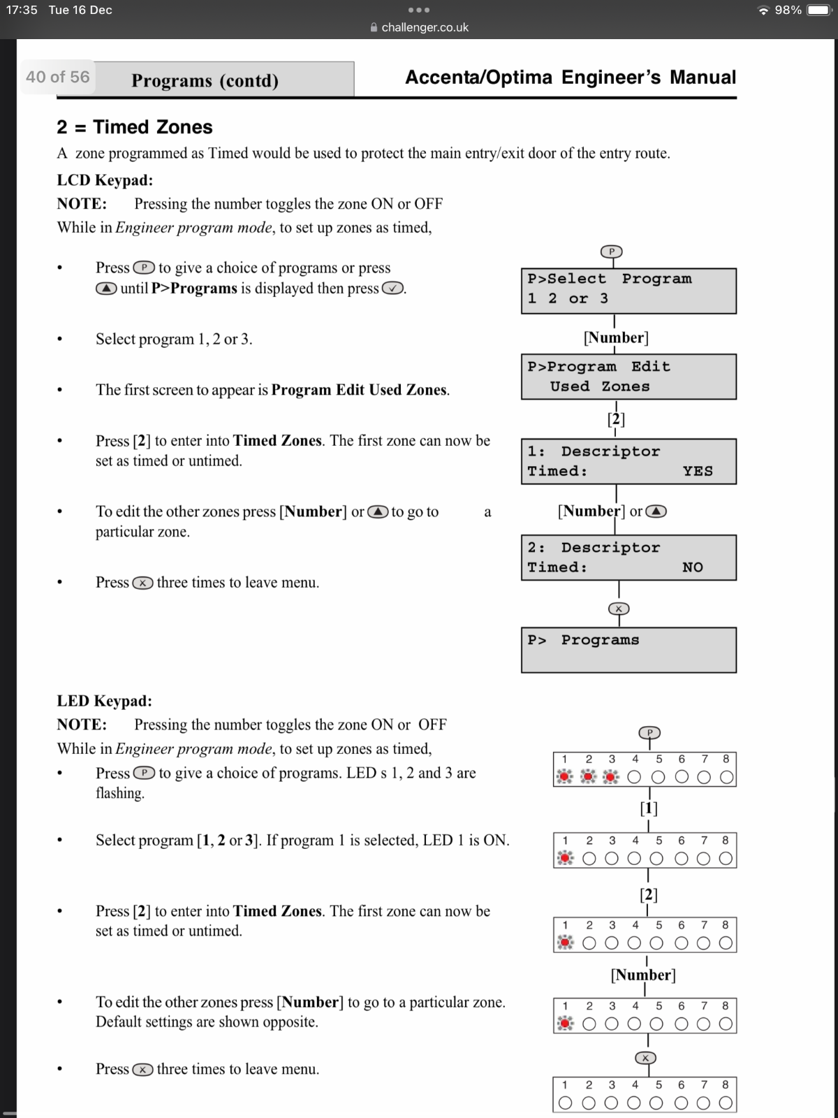

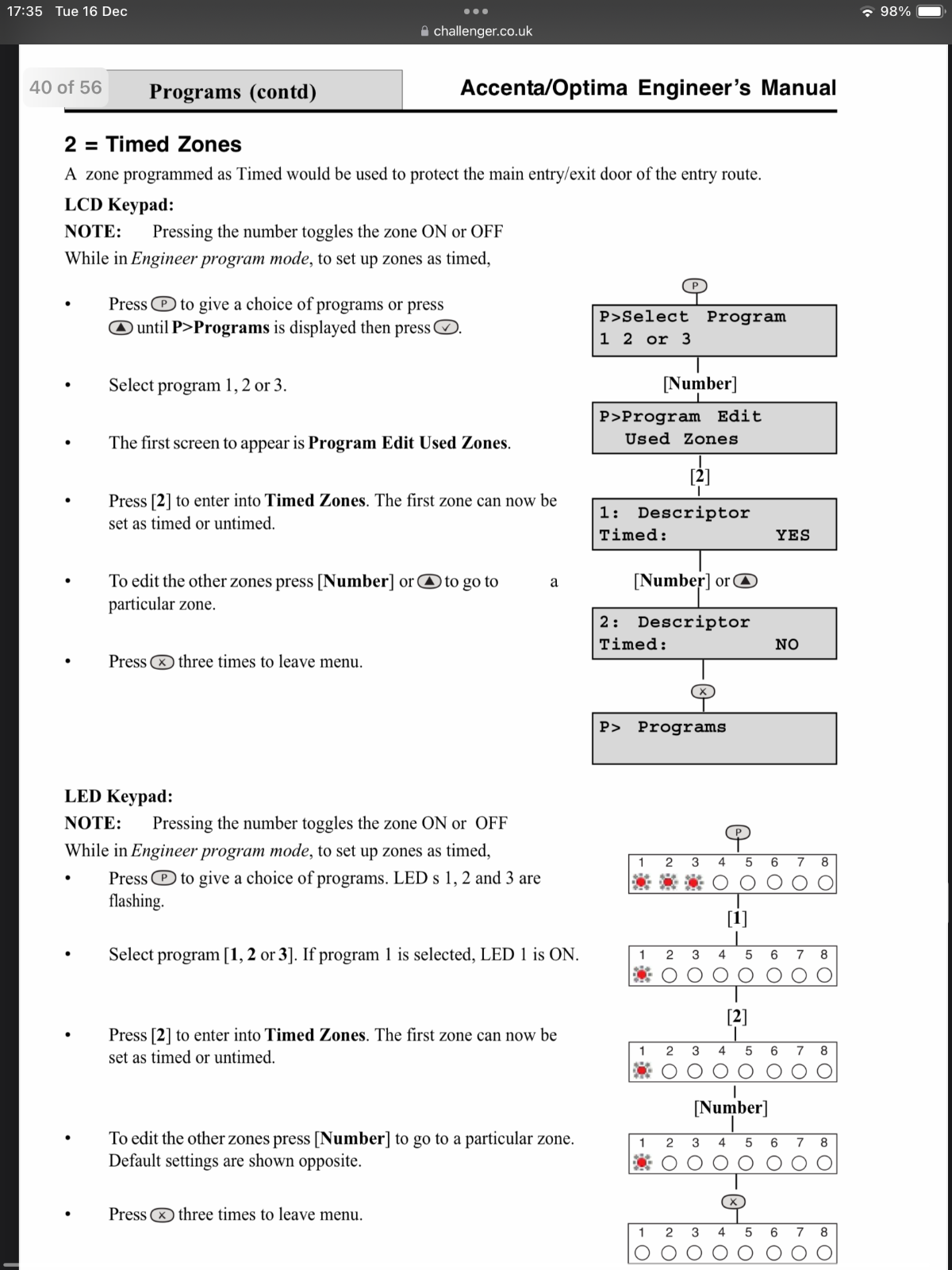

Compliments of the season one and all,
Having just replaced an Accenta Gen4 Mini, I am now trying to set it up within engineer mode. As a non-alarm expert (ie, alarm numpty!), I do find the language in the engineer manual to be confusing, but....
Have everything set, zone names, exit countdown, time, date, walk test, etc and have a 30 second timed entry set, but the alarm activates immediately on entry. Obviously, I need to set the entry door for the timed entry but am lost as to where to find that option.
Really grateful for your advice.
Many thanks
Rex
As per manual
Thanks, I do in fact have the engineer manual; it is just my lack of understanding. I thought I had posted again earlier to say that I have done it but somehow, that post got lost in the internet.
I was setting it fundamentally incorrectly. Following the above instructions with three presses of X, then user reset and check the operation. Seems that what I should have been doing, after pressing X three times, press Set(tick) before user reset. Then my options are saved.
Will be able check when I check / re-set the garage RKP.
As with many things, easy when you know how!!!
