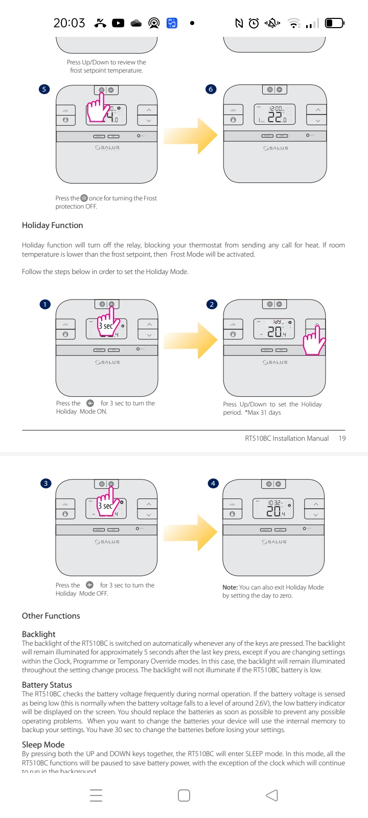

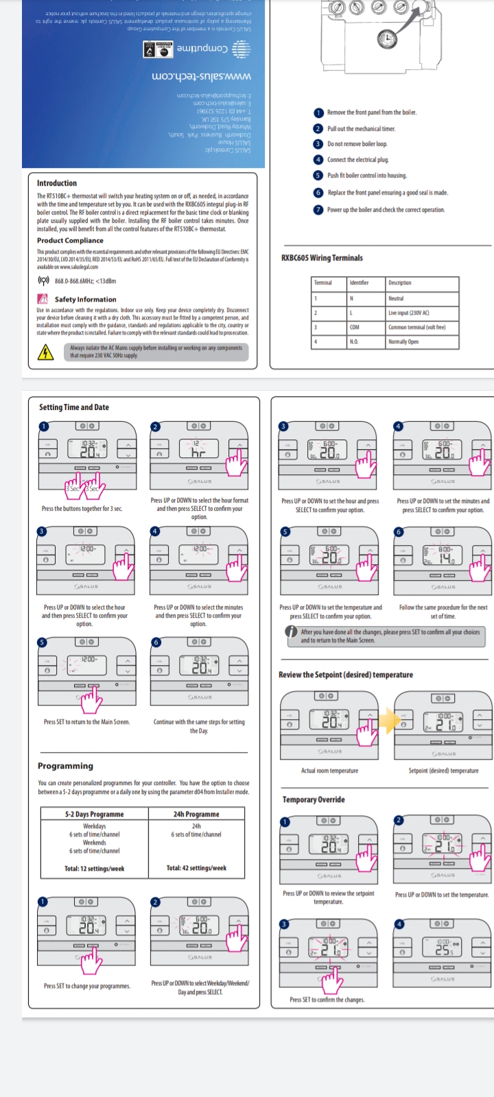

Is anyone a pro at setting salus digital programmers. There's is 6 programs to set a day. But what if you only want it to come on twice a day.

Not sure it has 6 programs on and off per day.
Also it looks like holiday mode is basically frost stat?
on my Honeywell, the holiday setting just does "don't change the temperature setting for x days"
so it returns to normal programme on, or the day before, you come home.
You can Up or Down the set temperature once it is in holiday mode, and it will not change until x days have passed.
IIRC the "unoccupied house" home insurance policy says 12C minimum. It's very cheap to maintain, because in UK it is rare to have long continuous periods very cold, night and day, with no sunlight to give solar gain through the windows.
Holiday mode is basically frost mode, but you can set for how many days it's on?

So it would be advisable to change the frost stat setting in the stat to 12c?
Check your home insurance. Pretty sure they will also have an advice booklet or webpage on winter protection
I found 12C pretty good. House dry and comfortable, did not feel chilly when you went in. (This was a second home)
For 'on' twice a day I set it as follows
06.00. 20 C
08.30. 10 C
12.00. 10 C
13.00. 10 C
17.00. 20 C
23.00. 10 C
That shows that it is aiming for 20 C from 6am untill 8.30 am.
And aiming for 20 C from 5pm until 11pm.
At all other times (for example between 11pm and 6am) it is aiming for 10 C (ie off unless very cold).
You could set the 11pm one to be 14 C so that at night (between 11pm and 6am) it never gets too cold. Like this
06.00. 20 C
08.30. 10 C
12.00. 10 C
13.00. 10 C
17.00. 20 C
23.00. 14 C
This also works well to start warming house on cold night a little before I actually wake up.
04.00. 16 C
06.00. 20 C
08.30. 10 C
13.00. 10 C
17.00. 20 C
23.00. 10 C
Note that the times have to increase one after another in each programme slot otherwise it can fail to work properly.
