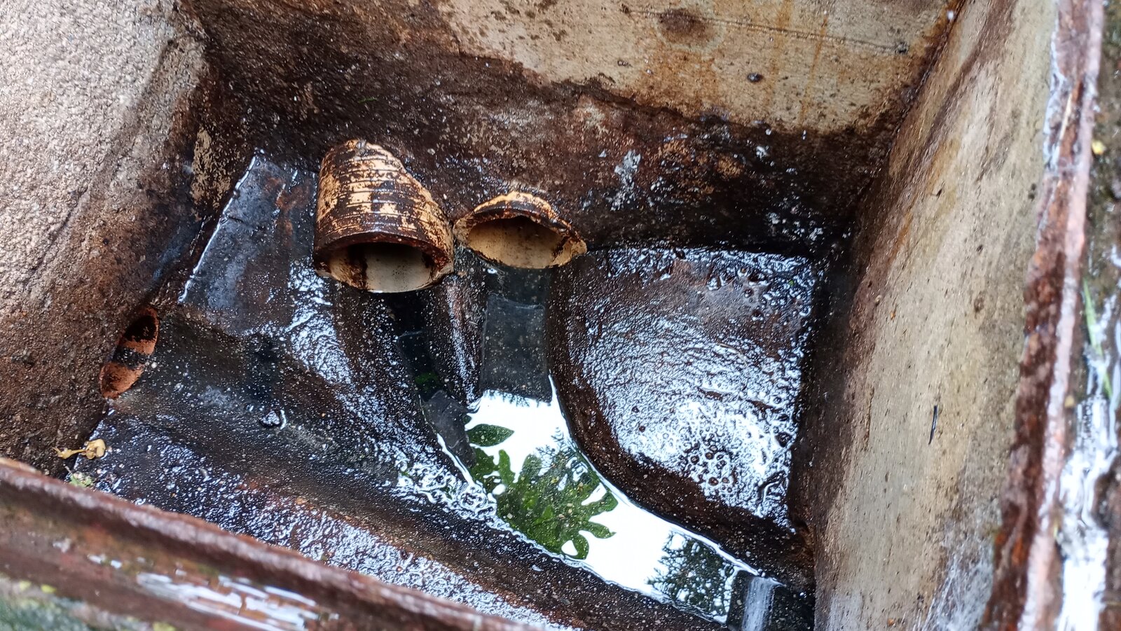

I have a problem with constant blockages between two manholes which are 11 metres apart. I've been chucking a bucket or two of water down it every couple of months to keep it clear but if I forget to do this it blocks. I've had a drain insurance for 20 years and never claimed so got them in. He jetted it out and ran the camera along it and to my surprise declared it fine. It did look ok even to me on his camera screen. This particular run doesn't look like it slopes enough to me but I am stuck with that. He says that the channels in the manhole are rough (and my responsibility!) So my questions are can I use something like this to smooth it out? And is it worth painting the inside of the manhole as it was when I moved here 20 years ago?
In the pic it's only the pipe on the right that needs sorting because the one to the extreme left is rainwater only and the middle one is an old toilet long since removed. Thanks for any help offered. :)

I'd just lobbed another bucket of water in it before I took the pic but there is always a little water in the channel part. Does anyone think lining the channel with the upvc would help as the drain guy suggests?
That section is all ours. It runs out of the manhole a further 8 meters down the garden into a deep manhole (ours I presume) just inside the boundary where next doors turds also arrive! Then goes out to the un-adopted lane (part of the SW Coast Path) outside our back gate. It only ever seems to be the section which runs across the back of the house which causes the problems. I'm sure if it had a steeper slope on it, it would be better but I don't want to get involved with major ground work. I'm really just hoping to give it the best chance I can. Thanks everyone for your replies. :)

Where does it block? In the manhole or in the pipe? If it is in the pipe then messing with the manhole is unlikely to help?

I think it blocks at the end of the pipe just as it joins the manhole in the pic then it backs up. Not much rainwater comes down that pipe, most of the rainwater comes from the other side of the house directly into that manhole so it is after the dodgy pipe.

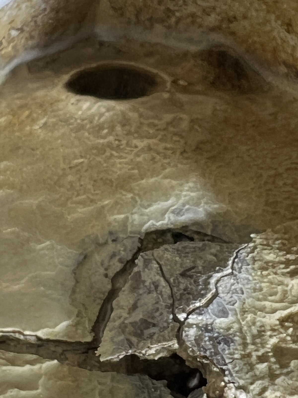

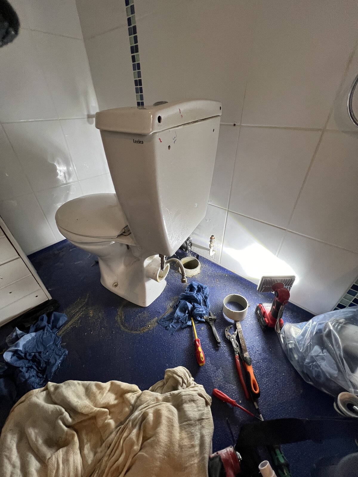

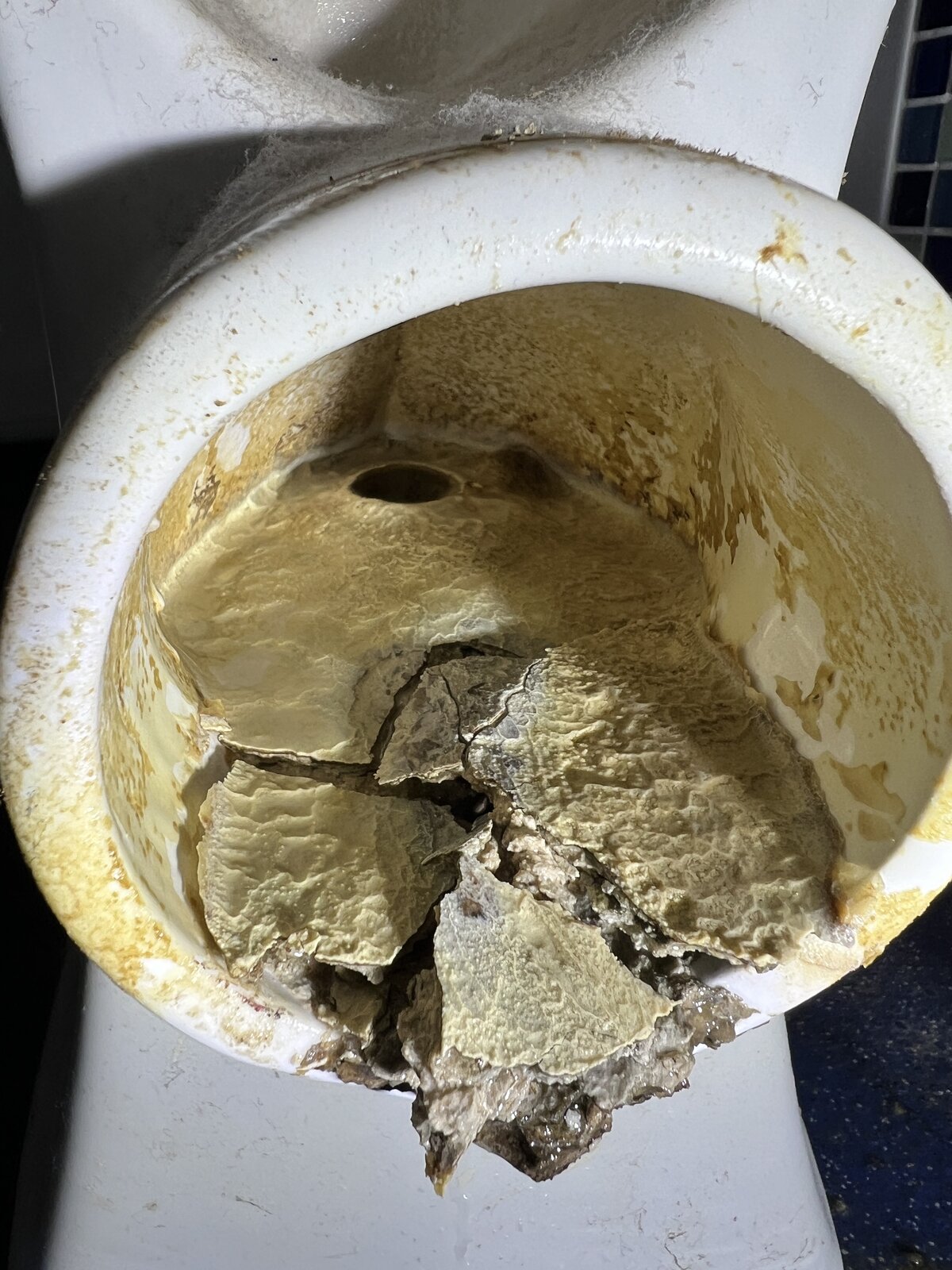

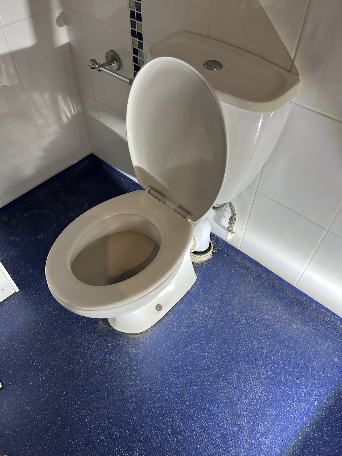

This happened when the customer didn't flush their toilet enough.
