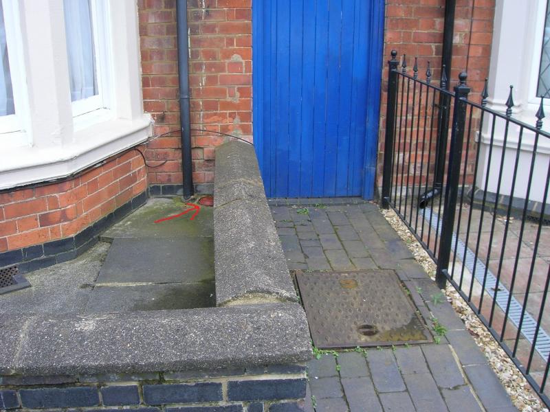

1. Why are there two exit pipes into the main street sewer ? If you examine the picture one has white toilet paper in it but there is a second just above it.
2. The bottom exit pipe (one with white toilet paper in it) has a nasty habit of getting blocked on a regular basis. Quite often the bottom trench is full of waste and the top pipe is draining off any liquid. No materials to my knowledge like baby wipes etc are present that could cause a blockage.

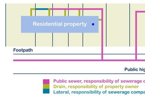

3. I'm pretty sure that as illustrated in the first picture that unblocking this drain is the responsibility of the water authority (Anglia Water). I resorted to clearing it myself as it was quicker and also if I called them out every fortnight I assumed it would be only a matter of time before they suggested it was in some way the residents faults.

4. The manhole (pictured above) has a badly corroded drain cover which is no longer air tight. If the drain is the responsibility of the water company, is it also their responsibility to replace the cover or is this up to me.

What you have is called an intercepter trap, they are known for blocking especia;lly on combined rain/foul water systems, they were used to stop the foul air from the sewers so not really needed nowadays, you could ask the water company to remove it, not sure how successful you will be but you never know.
That is what is known as an 'Interceptor', basically a 'U' bend in the drain. the top pipe is actually a rodding eye, to allow the section of drain beyond the trap to be rodded out to the main sewer. When the drains were laid there would have been a plug in the top socket to seal it off.
The Victorians had a thing about 'drain air' believing that (rather than the effluent itself) was the cause of their many ills, and the interceptor was fitted to seal the house drains off from the road, thus preventing 'drain air' and rats from entering the house drains. Often a low level vent was fitted on this manhole, with the idea that air could be drawn in here and pulled through the house drains, exiting from the vent stack to ventilate the house drains. The main sewers in the road were fitted with their own cast iron vent stacks.
These interceptors have a habit of blocking on a regular basis, it doesn't take much.... The water and waste should flow through under gravity, but as you've found out, it often doesn't. Keep ringing AW, they should attend, they'll probably jet it which should remove and build up of fat/scale/silt and maybe sort the issue. If not they'll probably investigate further. I'm not sure about the cover, but suspect that may be up to you.
The pipe in the road could be anything from 6" diameter upwards. Nearer you get to the end of the run (i.e. pumping station or the receiving sewage works), the bigger the pipe usually.
Interceptors are still made today, in the rare event anyone wanted to fit one! http://www.knowlesdrainage.co.uk/pr...oryID=12&subcategoryID=20&parentproductID=714

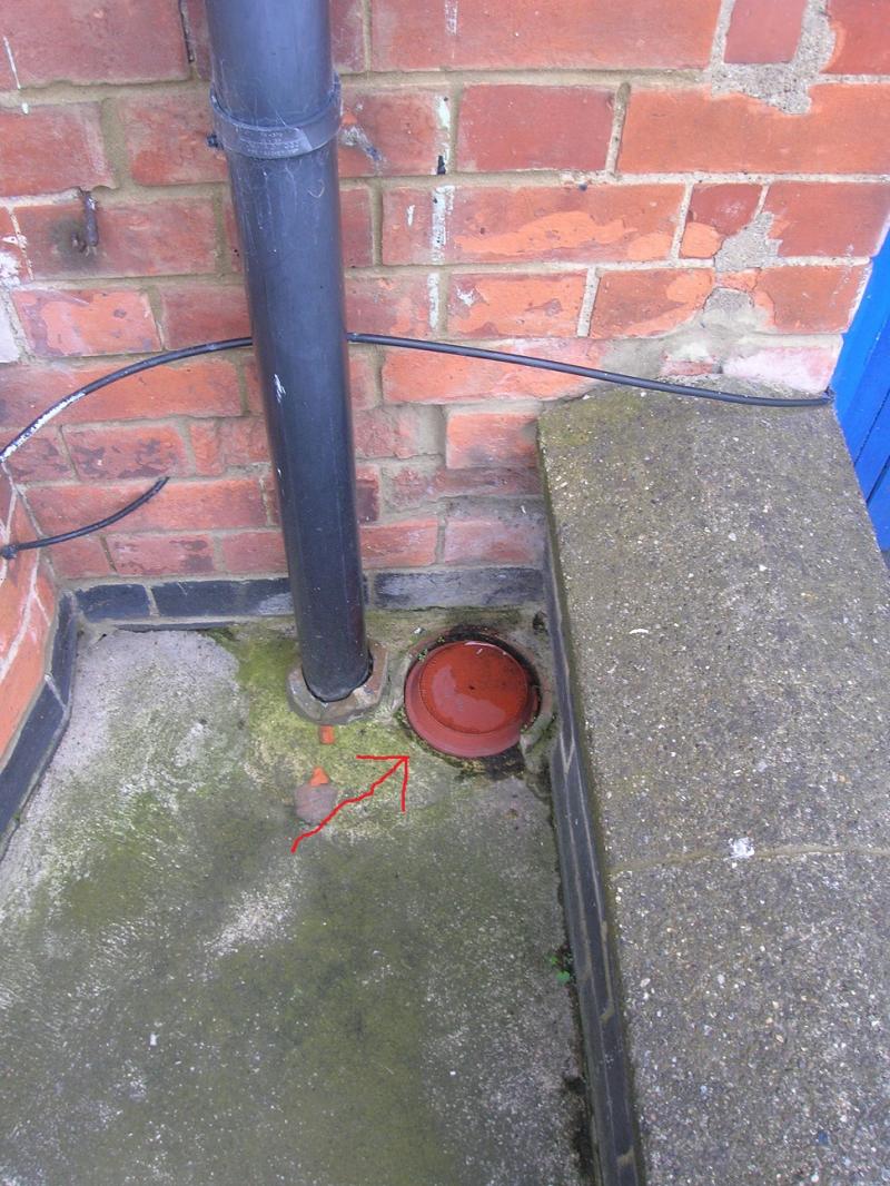

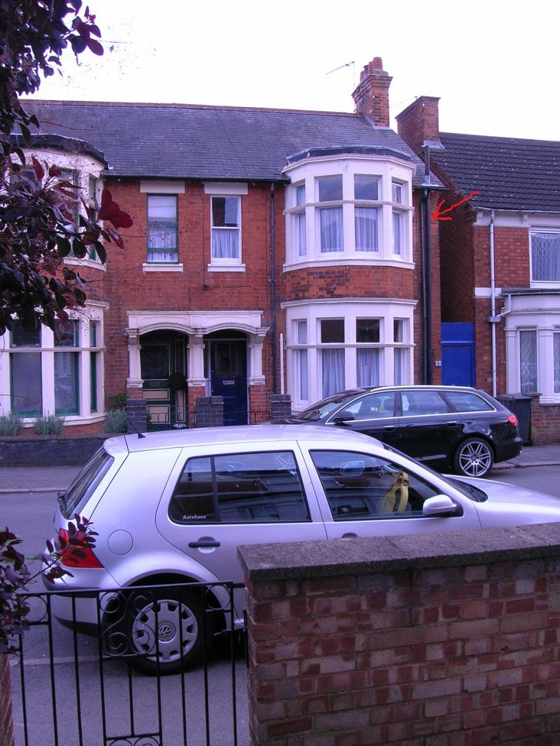

The sewer ventilation pipe (cast iron) originally ran up the front of the house (see red arrow)
and joins the manhole (which is situated just in front of the bright blue gate). You can see where it joins the manhole (see grey arrow)
When I inspected the pipe it was in a terrible state of repair and had to be removed. It served no purpose as it was full of rust, 8 feet of the pipe was pipe was packed solid with rust. Whatever happens regarding the blockage I now see that replacing the manhole cover and ventilation pipe needs to happen else the smell will remain.

The vent pipe at the manhole (grey arrow) usually led to an early form of air admittance valve (AAV) at ground level, just inside the gate. The vertical stack against the house to act as a vent in this capacity is more uncommon, but reinstatement of the connection between this and the manhole may have benefit. Ventilation of drains is important, blocking off of vents can lead to problems as you have experienced.
Windy days can often cause a change in pressures in drains as the action of the air passing over ventilation stacks acts to draw air up the pipe and thus out of the drains. The original design often was for air passing over the roof level vent to cause a negative pressure inside the drainage system, and air would then enter via the low level vent inside the gate and ventilate the system. The main sewer in the road was sealed off with the water in the interceptor trap and the plug in the rodding eye. Without knowing the full layout it is difficult to imagine the designed intention of your system, but I would think this (now blocked off) vent played its part.
All drains have potential to harbour gases and smells, certain gases I believe attack concrete and metals within the system, possibly hence the corrosion of the cover and cast pipework. I wouldn't worry too much about replacing the rodding eye stopper though, not necessary with modern understanding of drains, they can fall out and cause further problems and there are many thousands of interceptors nationwide without a stopper in the rodding eye! :lol:

The original cast iron vent pipe I removed as it was so badly corroded it was in danger of collapse. Flakes of rust had blocked it totally all the way to the end of its meeting point with the sewer (see above picture - grey arrow).
The ceramic part of the pipe is now clear but I placed a temporary plug where it exits to avoid leaves, muck entering the sewer. There is a small hole in the plug to prevent any build up of positive pressure however this is inadequate for proper ventilation purposes. (see red arrow)

Jetting uses water at high pressure to blast any detritus away, it also has the advantage of be able to go right around the trap and thus clean out any build of of fat, scale etc that may have accumulated. Technically it is Anglian Water's responsibility, (and always has been as the drain was laid prior to the Public Health Act of October 1936), and jetting would provide a superior clean.
I wouldn't recommend going down into the chamber, it is classed as a 'Confined Space' and there is always the danger of noxious gases. Without the correct testing equipment you cannot be sure it is safe to enter.

If your having similar problems I would advise contacting your water company straight away as they are responsible for more or less everything (assuming you have a similar sewerage design layout). I did myself a disservice by attending to the problem for well over a year on the false belief it was my responsibility as the drain was within the boundary of my property.
