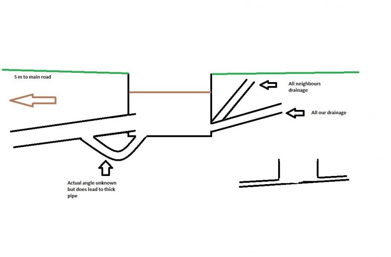

Hi there,
See Pic please.
bottom right hand diagram shows inspection chamber of the type I have seen before: staring down onto a half pipe that enters and leaves the 'box'.
My neighbour today alerted me to a blockage where our two fould wastes join entering an inspection chamber. The inspection cover is under a hedge. Once lid removed I found it was blocked to brown line. Almost to surface.
Rodding what I thought was main outlet- very large bore pipe, cleared it. Though my neighbour who has been into pit before told me to keep going to clear the lower pipe. He said upper pipe was overflow and there is a u-bend lower down. Sure enough there was. We cleared it. But I cannot work it out. We never got the rods to go around the curve -too tight- but pressure did blast water back up main larger pipe as we cleared the lower one. I.e. they are connected as diagram.
Is the lower pipe going to a bottle type gulley? It felt almost square? Though I only gauge this from rodding.
Why a u-bend down there? Is what we have normal- can someone explain please?
I only ask as suspect, given appearances, that it will block again.
TIA. :D
Originally designed to stop sewer gasses coming back, but not used now. Usually find the plug missing, or stuck in the system.

They are not essential, but by allowing the waste to flush out the trap each time waste is run out, stuff like congealed fat cannot build up in the inspection chamber, to block the system later when chunks of it break off, and block the main pipe - which is why it probably needed rodding out this time.
Interceptor's were a Victorian idea to prevent 'drain air' (something they thought was source of most illnesses), getting into the house drains. As Noseall said, a PITA and surplus to requirements nowadays.
Dont worry about replacing the stopper, there's thousands out there without it, and it's one less thing to cause a problem in future.... You may wish to note that as the drain at that point appears to be shared between you and your neighbour, it may well be the Water Authority's responsibility to maintain and clear.

When a section of drain has 2 or more properties discharging down it it is now the responibility of the Water Company to maintain it (has been for last 2 years) I use to have a U bend that blocked every now and again and so cleared it. Since it became Water companies responsibility called them out 3 times to clear it and eventually they came and piped it straight through, something I was going to do but never got round to. Good old Severn Trent.
This section has at least 3 properties using it.
