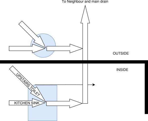

I have a kitchen extension built over an inspection chamber. Looking into this chamber, there is a junction where two pipes (from kitchen and upstairs bathroom) drain into a bigger pipe that then carries on outside of the extension (no neighbouring houses are using the bigger pipe - just me). If I create a new inspection chamber just outside of the extension (i.e accessing the bigger pipe) in order to create a new rodding point for the junction upstream, is this sufficient to cover any blocked drain issues? In other words, is it possible to rod a junction point (i.e. with branch pipes) from a point further down? How would you control which pipe you rod (kitchen or bathroom) if you were accessing the junction remotely? Just trying to see whether this is a viable solution as I want to tile over the extension floor without leaving the old inspection chamber visible (it is currently raised and sealed to scree level). Thank you.

Thanks for the response Bernard. I'm hopeful for what you've described, but your layout isn't quite what we have.
The situation we're in is like this:
The blue sections are current inspection plate locations. The "inside" area is the new extension.
The two branches outside lead to the downstairs cloakroom and the upstairs en-suite, but both will remain accessible, so I didn't bother labelling them.
The pipes inside and the pipes outside never intersect (as far as we can tell).
The kitchen sink one would be fine, we think, as it could be rodded from the kitchen or from a new inspection point on the main drain, outside. It's the one that leads to the upstairs toilet that we have concerns about. And then only if the blockage occurred in the upstairs toilet branch, at the bottom of the soil pipe.

It's brand new, screed was laid today. We were told it'd be a small, round inspection cover that would fit under a single tile, but they put a large rectangular plate in place instead. Is conversion a possibility? Can we make the entrance to the chamber a mini inspection cover, the 250mm round ones or the 300mm square ones?

I would discount any chance of clearing a blockage from the external chamber.
The only practical way forward is to express your concerns asap with the contractors and see if you can find a solution.

Understood. I'll speak with the project manager as soon as I can. Helpfully, the project manager has changed since the start of the project. The guy that said moving it would be "too expensive" and that it'd be a small inspection plate isn't the project manager anymore.
We'll speak with the tiler as well and see if he can reassure us about it's visibility. Maybe just getting the grouting to match the tile colour as close as possible would mean you really can't see it. The tiles will likely be dark grey so maybe it'll be ok.
As for the pipework in the roofspace, I'd never really considered it backing up to up there. I guess eventually it'd come out of the roof? It's got to go somewhere, I suppose! Currently I think the flexible pipe is in place because the roof vent isn't directly above the soil stack. Two 45 degree elbows will sort that out though, I suspect. I'll speak with my plumber about getting that replaced.

Look at the internal covers, full size and designed to be infilled with the appropriate floor covering to blend in. I'm not aware of any smaller covers that can be filled. An example here, http://joe-cornell.co.uk/s/cc_images/cache_2412651684.jpg?t=1329824065
