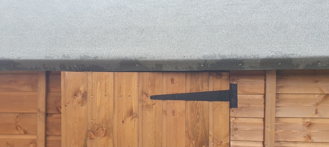

I would appreciate some help. I've attached a picture of my shed. It is a Hipex (tall door).
How can I fit guttering to this?

Trim 100mm off door top and fix to door frame. Move hinge down 100mm which should give enough room to fit standard gutters or use mini guttering.
