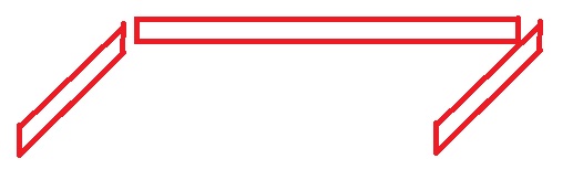

Thanks all, I will be having support at both ends and at the back of the shelves, upon which the shelves will be sitting on (see crude diagram below) - will that make a difference?
If i decide to use pine timber board, do I need to treat the wood before I paint them white to make the last longer - they will be fitted in the living room?

pine indoors needs zero treatment and will turn to a mellow antique pine in about 2-4 years but without the yellow
whilst its good practice to have a batten at the back you will be ok without it iff the ends are well fixed the disadvantage are any books within 44mm off the full height will be forced forward by the thickness off the baton
its worth planning the shelves according to the books you have as in many many large books then more shelves for large books

If you are building a frame to support the shelves, you have the opportunity to flip the shelves when they start to sag. 18mm will sag over time, even 25mm will do so over time (albeit more slowly).
