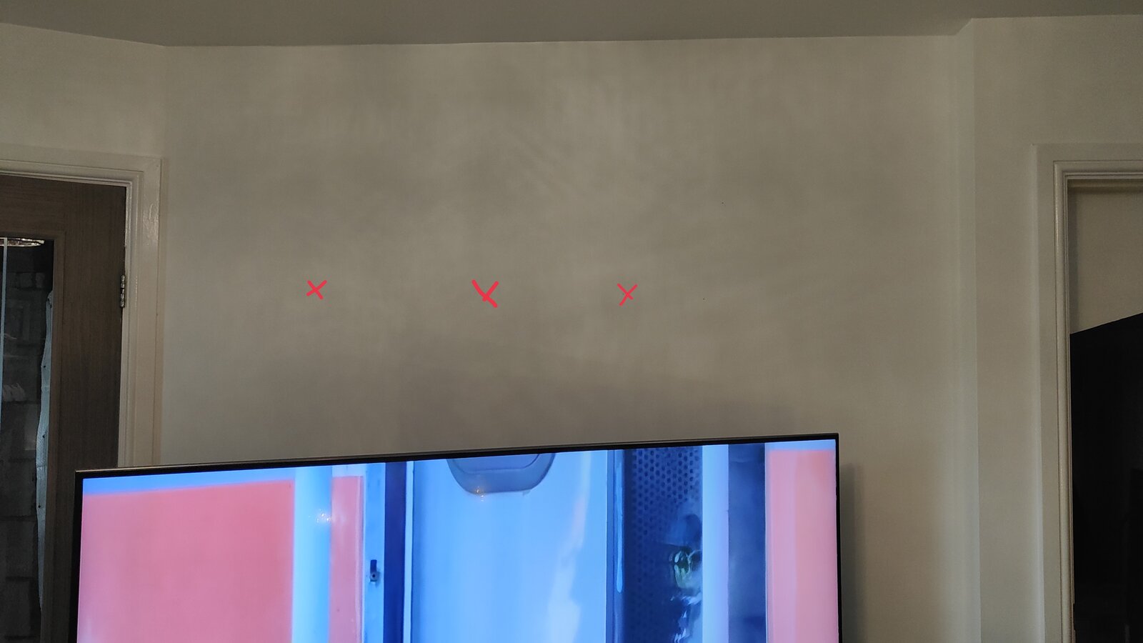

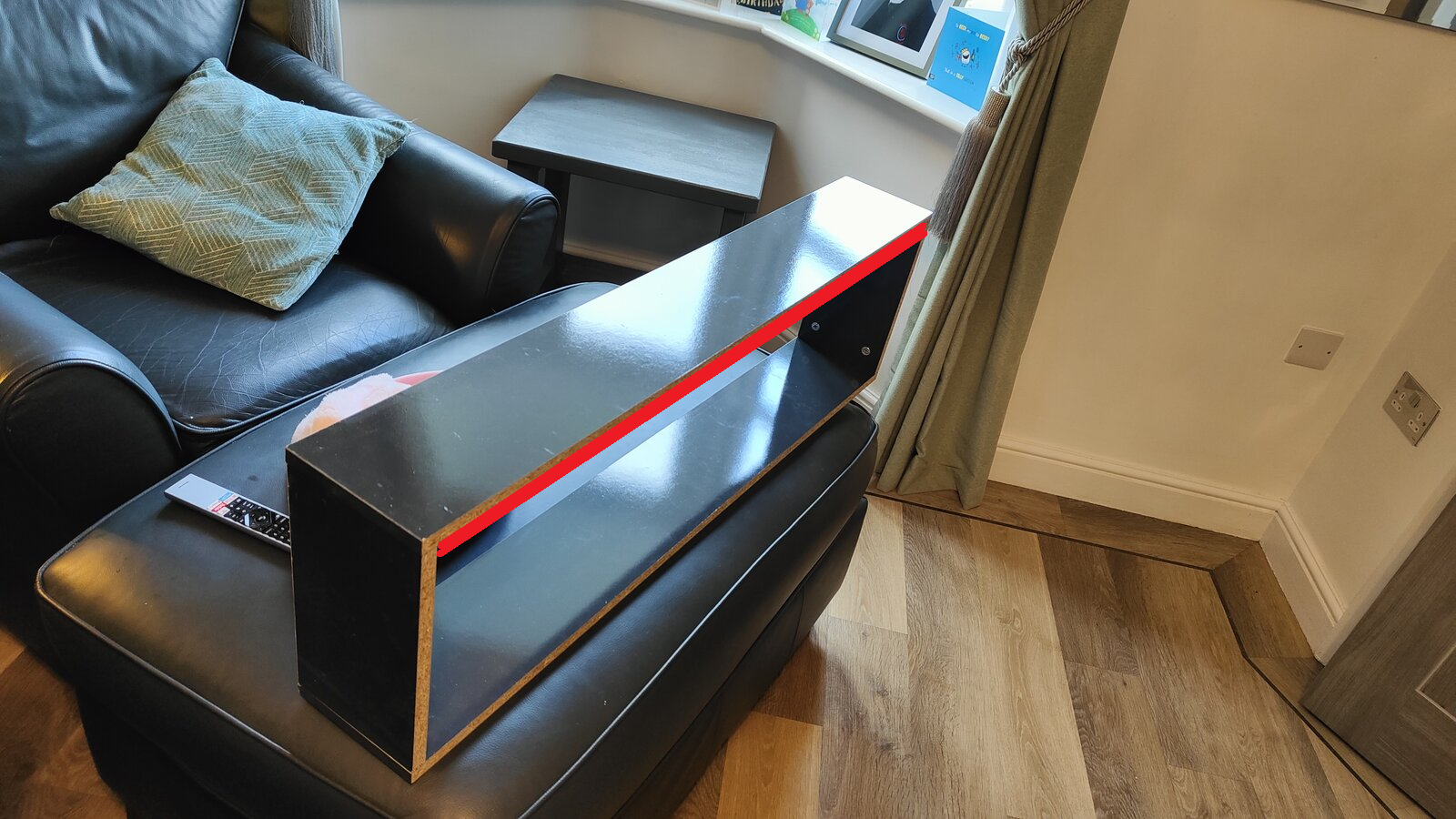

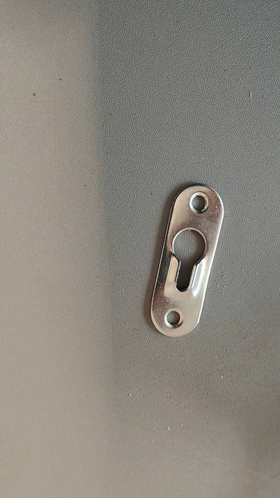

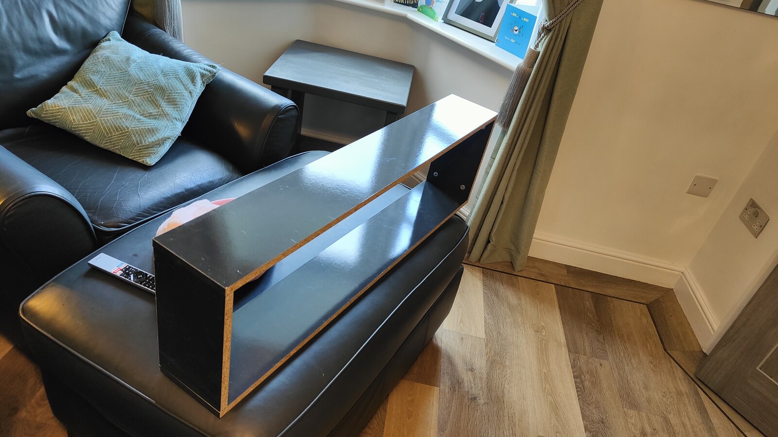

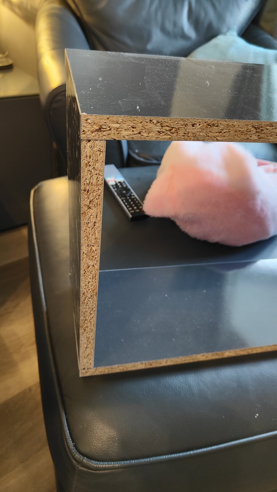

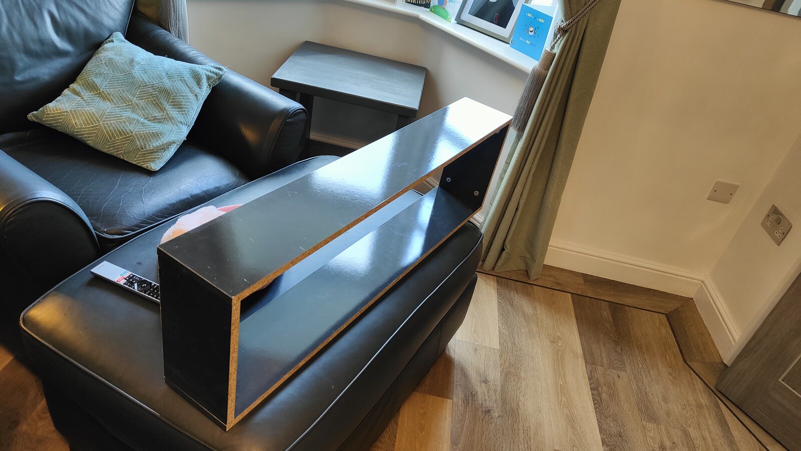

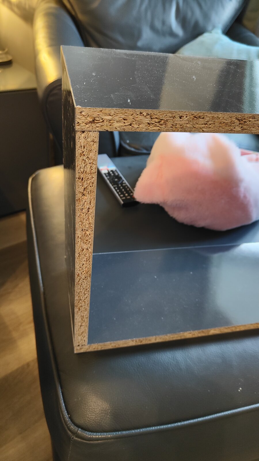

Hi
Can anyone help?
I have the attached shelves to go above the TV.. there will be 2 butt up together.

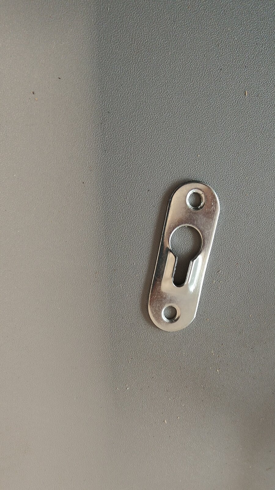

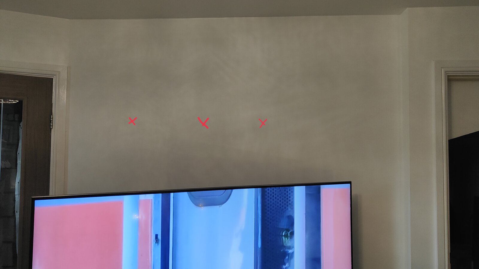

The thing is it is these rubbish fixings on the back, and it will be a stud wall.. I have marked where the studs are..
Any advice in fixing securely??

I'd cut a strip of planed wood to the length of the inside of the cabinet, and screw this into the studs, then screw down from top of unit into the wood. Paint colour of wall.
what are you planning to load the shelves up with
i agree with jp suggestion providing load is not extreme
The wood should be on the inside top of the shelf. Big enough to allow a long screw into the studs, and then a few screws from top into it to stop it sliding off.
