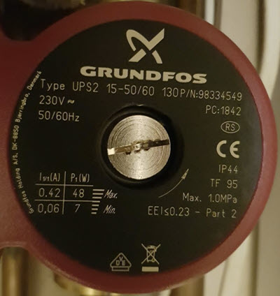

If I press i while the radiator is flashing I get S.7 - Pump over run
The pump is a Grundfos type UPS2 - see the image below
When the pump is running one blue LED is lit.
I will have a look through the manual for d0 settings

Change D0 to 15 once you look at manual. Is this a new issue or been like this a while? if its new, it could indicate that the pump is not moving enough water through the system or a partial blockage in the system starting to form. Although in most cases these boilers were fitted with no knowledge or regard to the system requirements and are too big for the systems there fitted to. Not sure if that pump has a selector switch to choose between the 3 power settings on it, if so it should be on 3(highest) power for that sort of boiler.
ScottishGasMan - that's one scary rabbit!
Ok - I have changed d.0 to 15 and as soon as I did so, the boiler behaviour changed. My conservatory radiators are hot to the touch for the first time in a number of years!! The outflow from the central heating pump remains hot (boiler on or off) and d.41 (return temperature) hovers around 61/62 degrees. The pump has 3 speed settings and is (and was) running at maximum speed.
