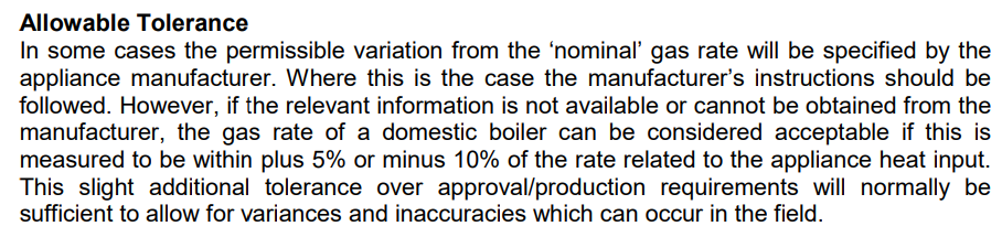

Should a boiler be classified as ID/AR for low gas rate/pressure?

It's a stretch but if say the meter governor had collapsed and the boiler were barely working due to lack of gas which he could see, he wouldn't have needed to measure anything. That doesn't cover all he did/didn't do though!
He said the gas meter was fine but said the gas hob needed replacing because of no flame safety device.
I'm still trying to get a feel from the point of view of the gas safety inspection.
For a system boiler that is non-modulating would you ID/AR/NCS if the gas rate/inlet pressure is say 20% below the nominal rating from the factory?
UPDATE: Independent Gas Safe engineer came. He said the valve just needed adjusting. He cleaned the burner and all good except an NCS given that the kitchen cabinet it sits in is slightly too small for the manufacturer's ventilation dimensions.
