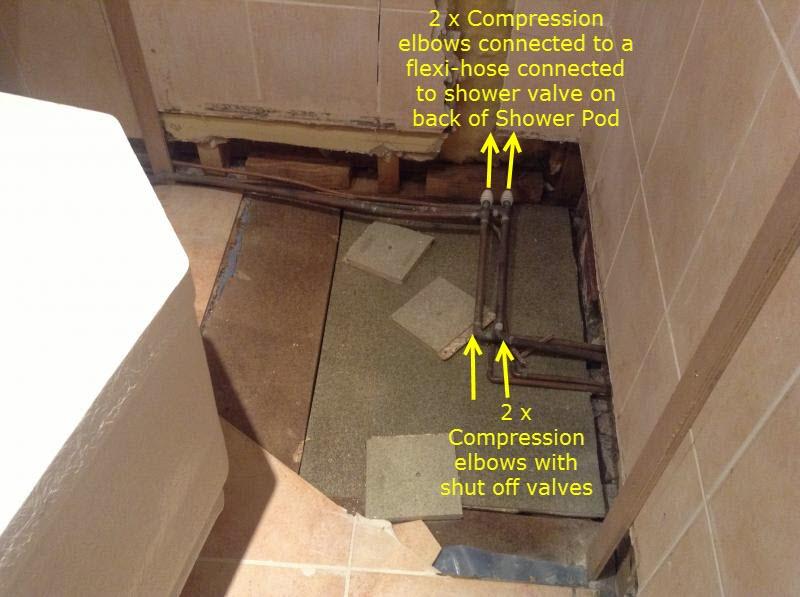

This is what I plan to do:
Then add one of these, a 900MM one to back of shower vale:
http://www.screwfix.com/p/flexi-hose-1-2-x-1-2-x-300mm-bx10fpfp30s/66800?_requestid=119124
The reason for the flexible hose, is because it is a two piece shower pod I am fitting, and if the pipe is rigid I cannot see how I can get behind once the base is in place.
This is the shower I am fitting:
http://www.byretech.com/acatalog/shower-pods.html
What do you think on the piping plan?
I would under no circumstances leave a compression joint or a flexi hose in an inaccessible location. Will you be able to access the joints after the shower goes in?

No, not once the shower pod is screwed to the battens on the wall. That is why I thought of the shut off valves nearest in the image, because I could reach them underneath the shower base cover, should there ever be a leak, with a screwdriver and turn water off.
The manufacturer supplied push on plastic connectors all around, but I thought compression would be safer, after reading plastic connectors could 'blow' off.
Must admit I've never fitted a shower pod. I've done traditional tiled showers with enclosures, and make sure the pipework is either accessible or soldered. Personally I think any system requiring push fit / compression in inaccessible locations is at best poorly designed. But if it is unavoidable to use such a joint in an inaccessible location, I would reduce the number of such joints to the minimum possible.
Ah, OK.
So compression joints only in areas that are accessible and everything else soldered?
I might have to get a plumber in after all then to solder the pipes leading up to the mixing tap valve area.
Mybuilder.com it is then. :x
Might be best if you're not confident / don't want to buy the tools to solder.
Maybe it's done a different way these days, must admit I prefer traditional copper pipe and soldered joints (I'm not old enough to prefer even more traditional wiped lead joints - now there's a skill!).

Is this a DIY project or a proper repair job?
At the risk of sounding like a broken record, make sure you go for full bore flexi tubes too, they are very restrictive in standard form.
Why not use plastic connected to the pod, bring it to the front of the pod and fit isolation valves/compression fittings there ?
