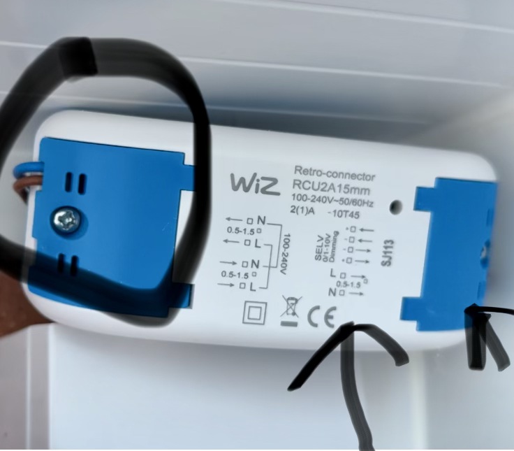

I have a Wiz (starlite) smart dimmer relay wired by an electrician that goes to a on off switch. Wiz are not making sense, they have updated the app so i cannot change the mode of the dimmer. originally it was on dimmer mode working great for years, soon as I reset it to change wifi , it has reverted back to ' on off' only mode
Wiz have deleted the old app so i cannot change the mode... So the simple option is to replace it, but I'm just wondering because the way this - it has a live and neutral In and a live and neutral out. I don't need to mess around with anything else but I'm just getting confused if this new one that I want, do I just wire the same. I think it's pretty straightforward, but I just don't want to take any risks.

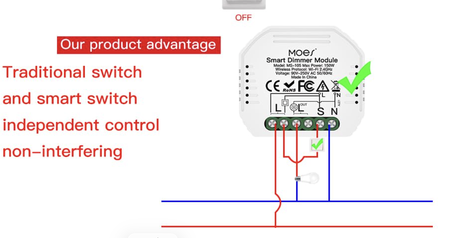

This is the one I want to use ( https://amzn.eu/d/i56gIhn ) but has 6 connections so which connections would I used...I have Live/neutral in and live/neutral out only going to Led all 230v
the link of old connector
Wiz not helping.

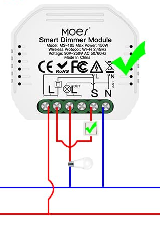

Ok , so I need to work out which side LIVE goes to the rocker switch then put that where the tick is
any chance u can break down exactly what I have to do as Im confused.
Should I just be looking for a dimmer module like this or is the one Ive linked ok?

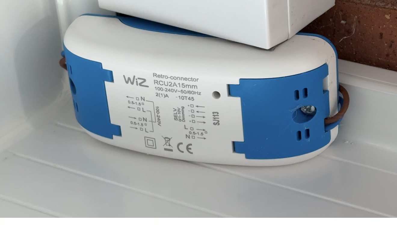

this is the current item wired. 2 wires on left then 2 bottom right. thats it.
So I just want to put LIVE/neutral in one side and same on the other...switch is wired behind all hidden.
So I'm just getting really confused. I just wanna keep all the wiring the same as this connector.
LIve/neutral input and Live neutral output... the rest of the wiring is already done behind it... like the Earth and the wiring to the rocker switch that's why I'm getting confused. I just need to know what type of module do I need so it can work like it did before where it turns non-smart bulbs into dimmable bulbs.

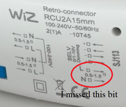

In this situation the connector I am using does have the option of SELV... but I don't know if you can make it out in the picture. I am not actually using that because it was wired in by a professional ELECTRICIAN...
I'm using the 230 V option
so where the arrows are
It is 230v AC input on one side and 230v AC output on the other.. ALL bulbs are gu10 230v...No 12v being used here anywhere
So in essence, it's a live and neutral input from a normal UK power supply
and a live & neutral output from a normal UK power supply
The SELV section is not being used at all
Like I said, everything was working absolutely fine before when this connector was in dimming mode but unfortunately it's now stuck in on a relay mode only ( ON/ OFF )
As you can see in the manual, it does have a different modes... it's not possible to change these modes now because they have stopped updating the app for this function
https://assets.cef.co.uk/downloads/pdg/starlite_wzrtr2a_datasheet/starlite_wzrtr2a_datasheet.pdf
so I just need to know how to replace the connector. How to wire this ... I just want to replace the stupid thing with something exactly the same.

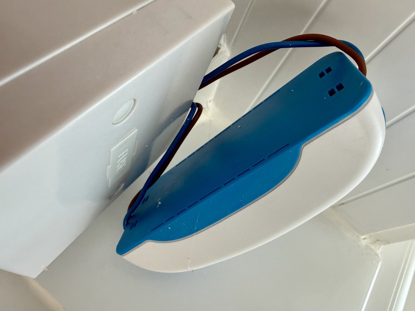

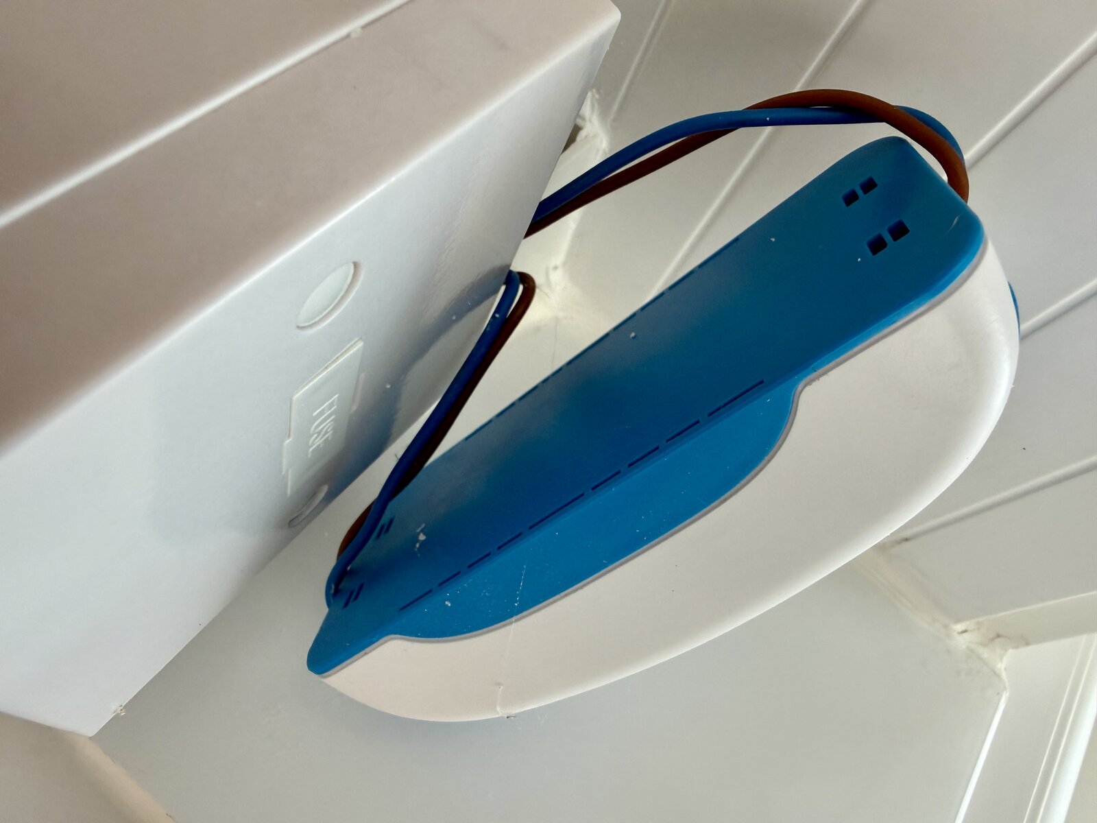

Took the connector out..as we can see...2 wires in. 2 wires out...

If the switch being off kills power to the unit, it is on the input side. If it turns the light off but you can still hear the unit clicking when you turn it on and off with the app, it's output side (probably preferable for a wifi unit).
If I understand correctly you have a standard rocker switch for turning the light on and off but the dimming function is solely through the app?
If so you should be able to use the new unit by joining the 2 blue wires to Neutral, 1 brown to live in and 1 to live out. If the switch is on the input side, it may cause delays and lose the memory of its last dim setting as it'll be rebooting the electronics every time you switch.
Edited to add : it's possible you wouldn't hear any clicking either way, so you might just have to hope for the best. Make sure you isolate the power before doing any work.
The rocker switch kills the unit as I just tried to turn it off, the unit went offline so thats 100%.
Yes, app only dims the lights, (and through Alexa). I always leave the switch ' on ' so Im ok with it being ON all the time and using app only.
I'm sure I'm overthinking this, but I've just never looked at the unit until now.
Ok so...two blue wires I join together and put BOTH on the N (neutral terminal) on the new module.
When you say " 1 brown to live and 1 brown to live out'... which live exactly on the module as there are more than one.
Live wire to first screw and other live wire to third?

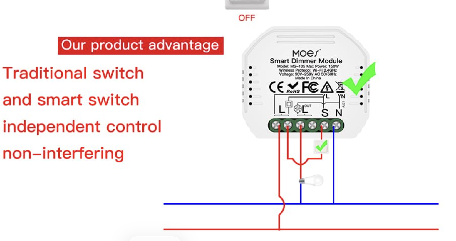

EDIT if anybody has another model that is simpler... LINK would be great. I'm thinking if we could find a module that looks the same as the old one would make life a lot simpler but I can use the one in the picture if it would work.

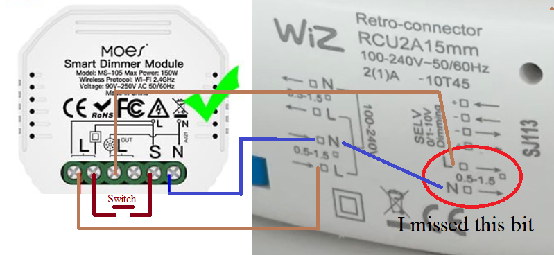

Will try this and report back. Just trying to learn and save myself calling an electrician.
@ericmark I think the new unit proposed wiring allows a switch to be used but overridden in the app and vice versa. Because their current setup doesn't appear to be wired that way though, the switch will just kill the power to the unit.
Yes, current set up only has 2 wires input , 2 wires output, rocker switch is somehow wired to it but I dont know how as its hidden.
I just want to keep set up the same...ie just replace the unit in the same wiring map and got confused as new modules have different connection.
OK so
Switch is on the input side (as it kills unit when off) ...so
Join two neutral wires...put them in the neutral connection
Put one live wire to input (connection 1) then second live wire to output (connection 3)
Item coming this week so if this is right I will do this. The amazon listing just confuses me more.
appreciate the help.
