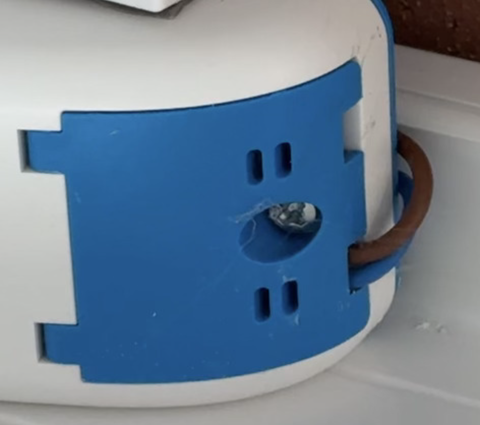

That's fair enough, you may decide to call one for peace of mind anyway. Your existing installation is actually a bit naughty, you shouldn't be able to touch any of the coloured wires without removing a protective cover
The ELECTRICIAN didn't initially want to fit it, but I insisted... because the connector was not being used and it was brand-new because instead of using the connector where it was meant to be used, I ended up installing smart bulbs as that sometimes solves the issue... but why I found with smart bulbs says they're not always as bright as what I need regarding lumens
So sometimes it's better to just install your own bulbs and just use something like this, but considering I had it anyway, that's why I decided to use it..
Yes, I'm assuming he was meant to hide it... even though the actual live wires are covered, I know what you mean because the actual wires are visible that's probably against the regulation?
Yes, you're only supposed to be able to touch the cable sheath, not the actual core insulation. The new one you're ordering hopefully comes with a box because the actual screw terminals would be exposed otherwise, which is much more dangerous.
On the old one, none of the copper braids are exposed because they go under the connector which you screw down

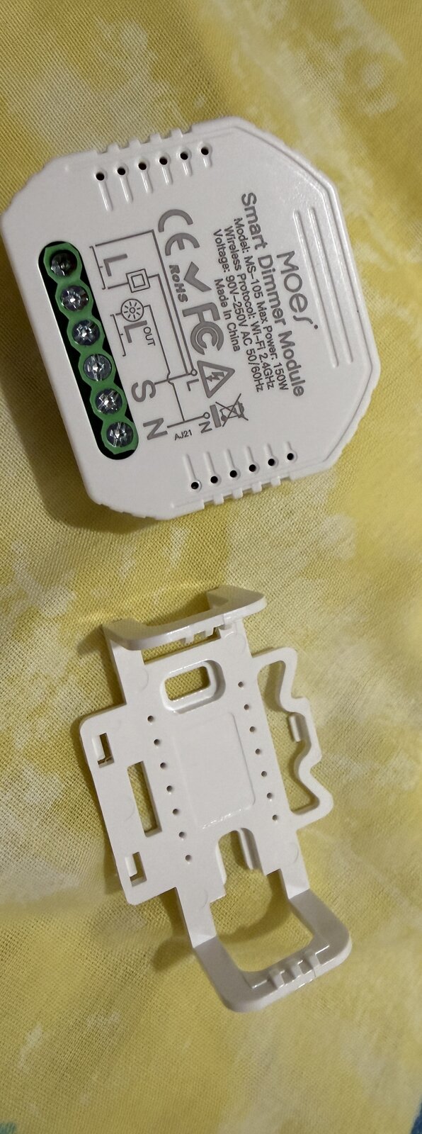

OK its just arrived and Im wondering...does it need to be hiddens as
surely these terminal that show screws are not live, as they are not covered?
this with one screw down
only thing with it, is this clip...
It should really be in a box. Can you take a picture of how much length you have on the cables currently?
