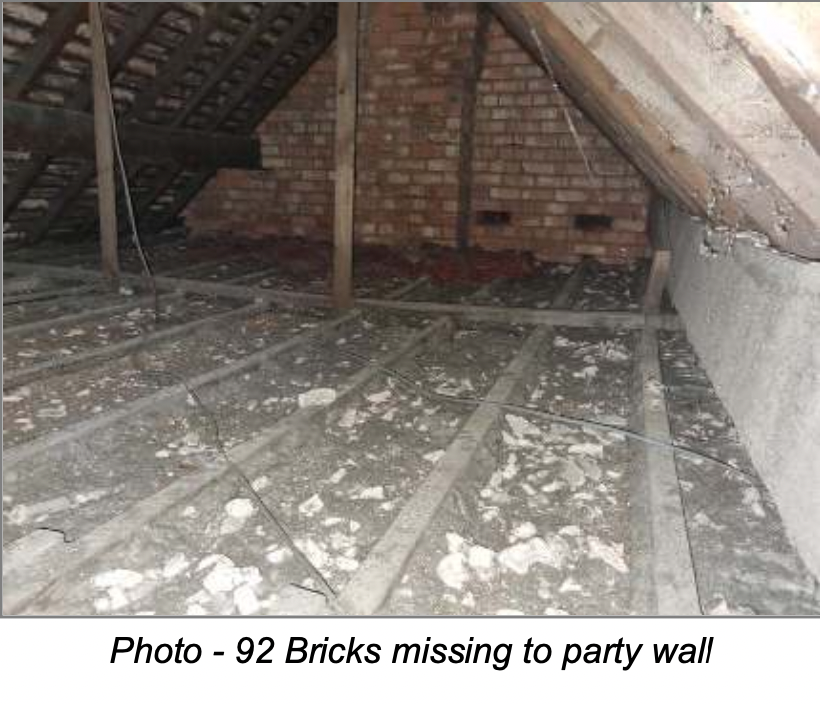

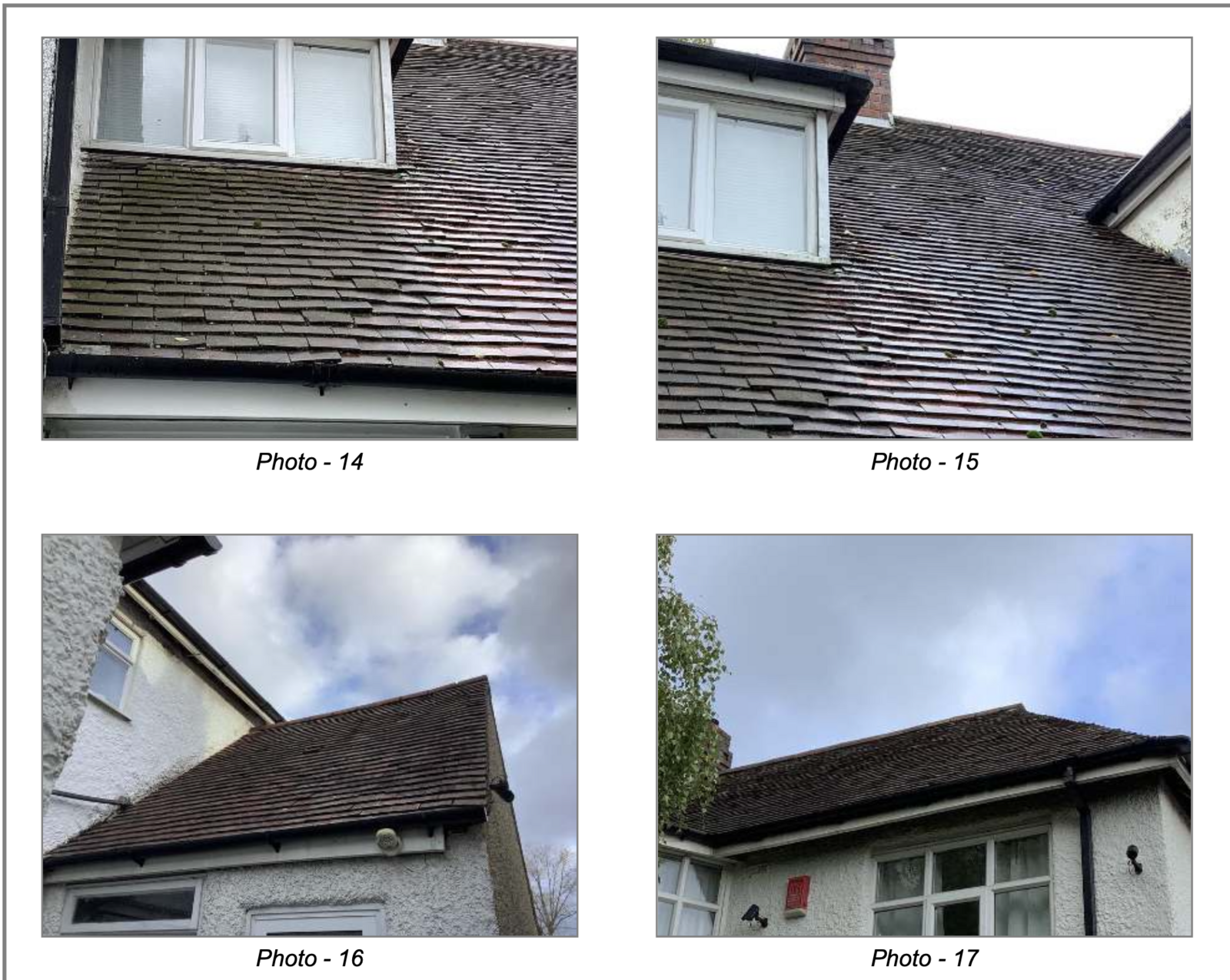

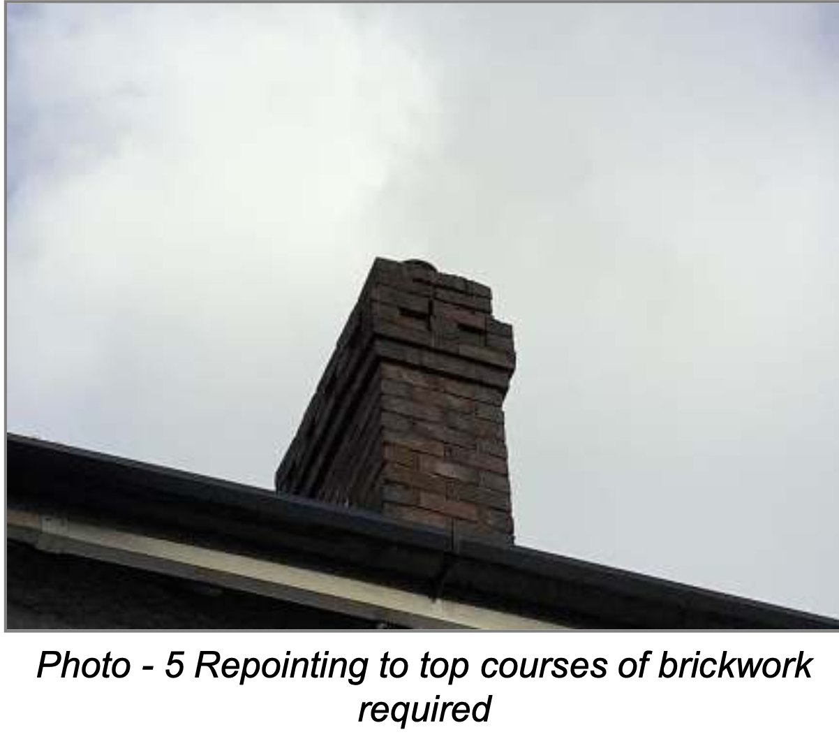

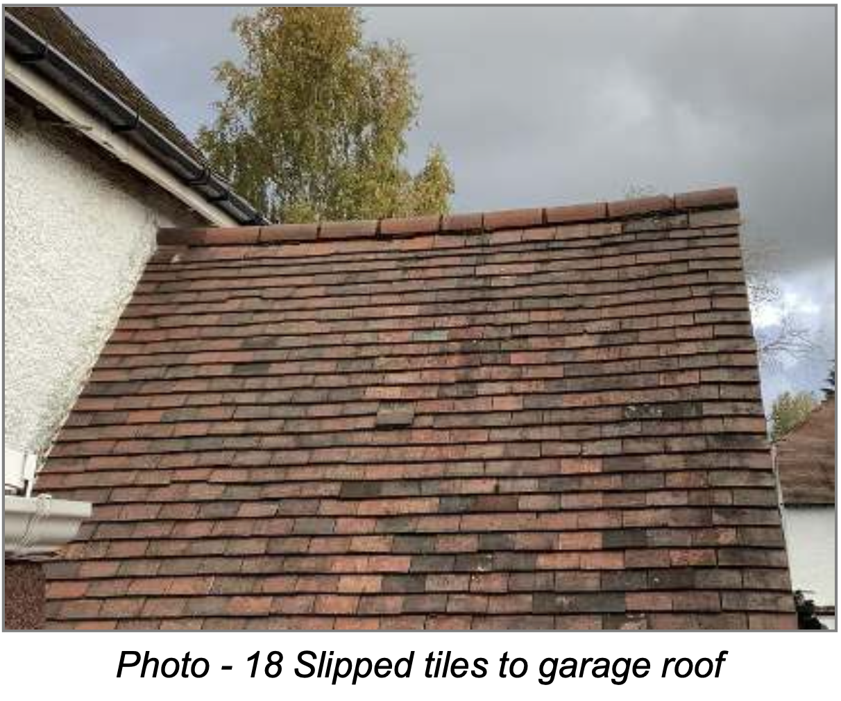

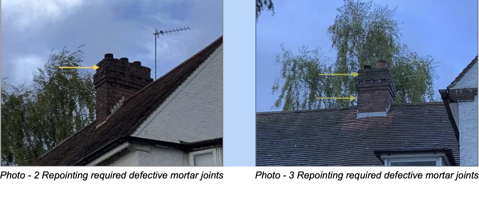

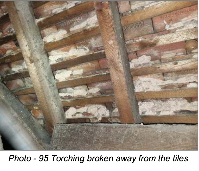

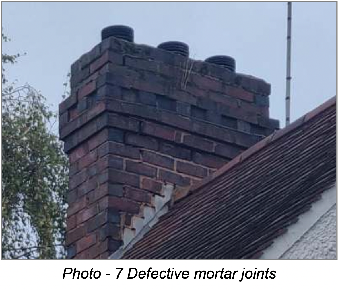

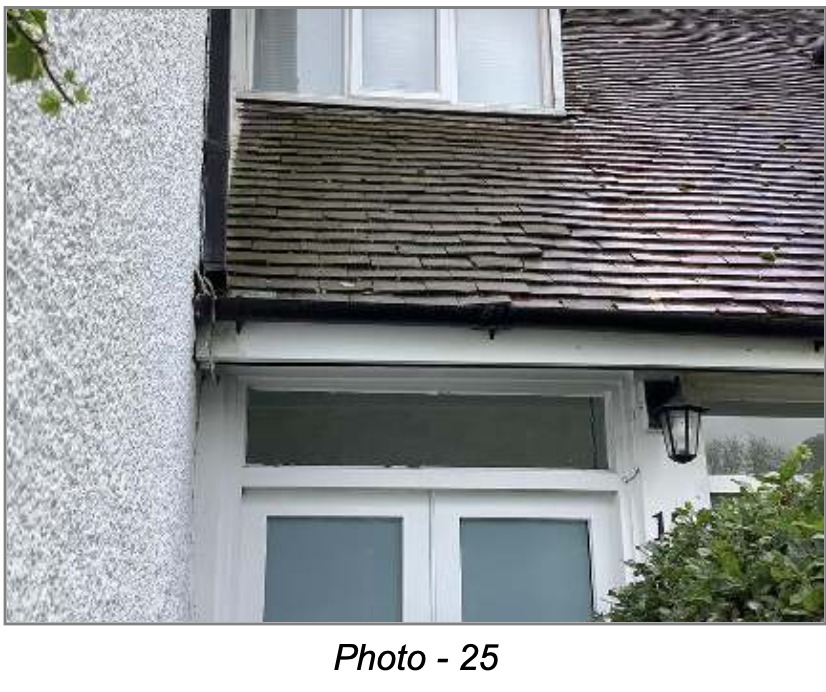

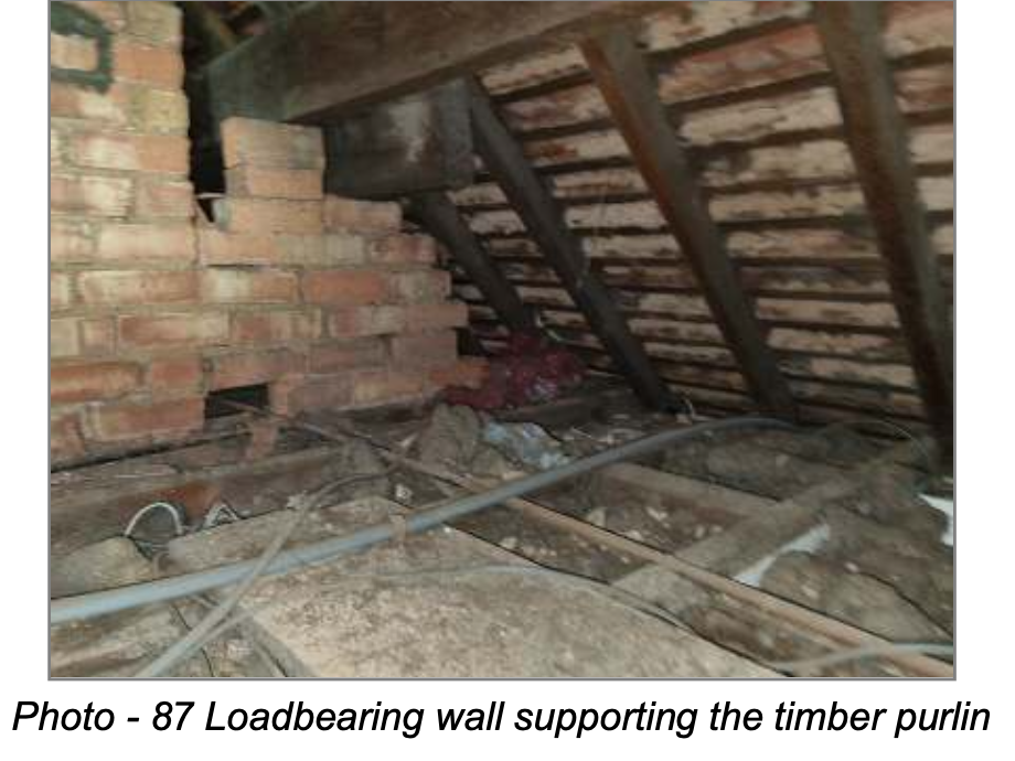

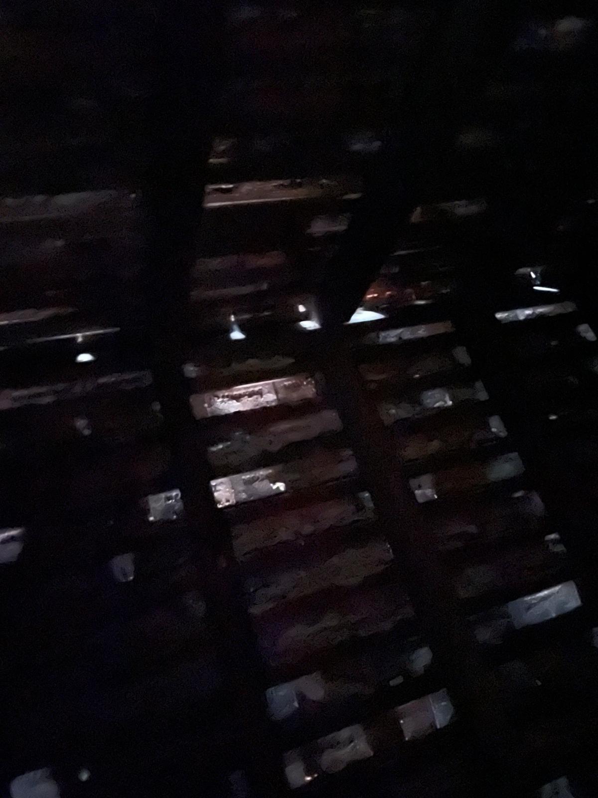

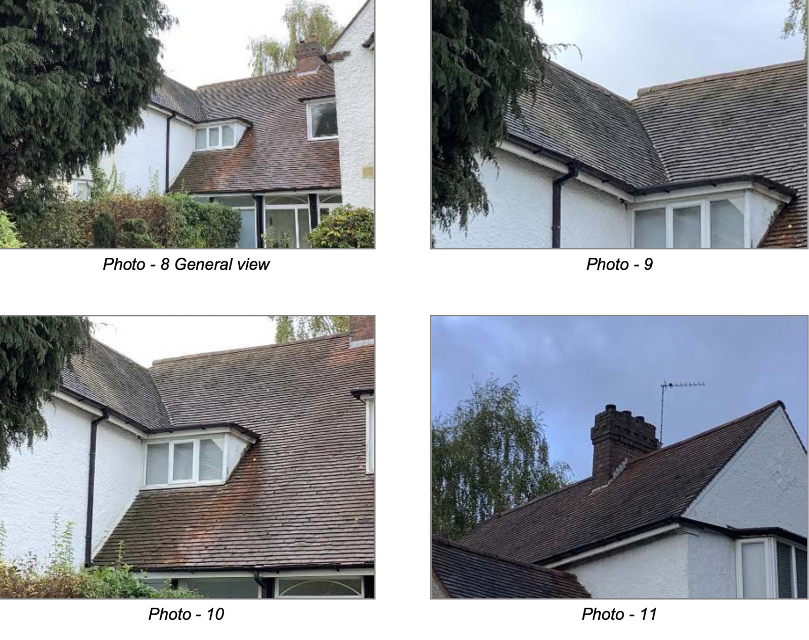

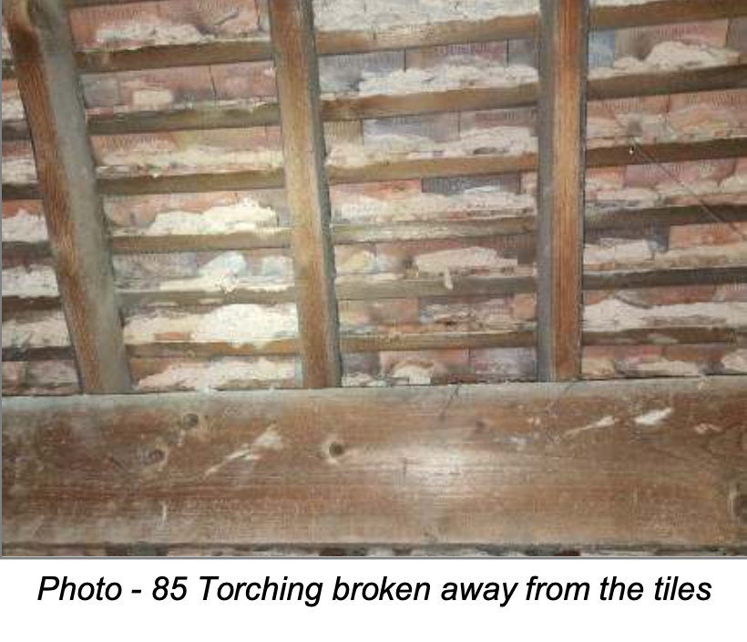

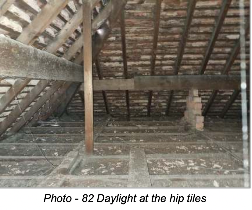

Should I be concerned about buying a house with this roof/roof void?
Surveyor says the following work needs doing:
- Repoint defective mortar joints to the chimney stacks
- Repoint or re-bed roof ridge and hip tiles
- Replace slipped, loose and cracked tiles.
- Brick up holes in the party wall within the roof void
- Repair defective torching to the underside of the roof tiles

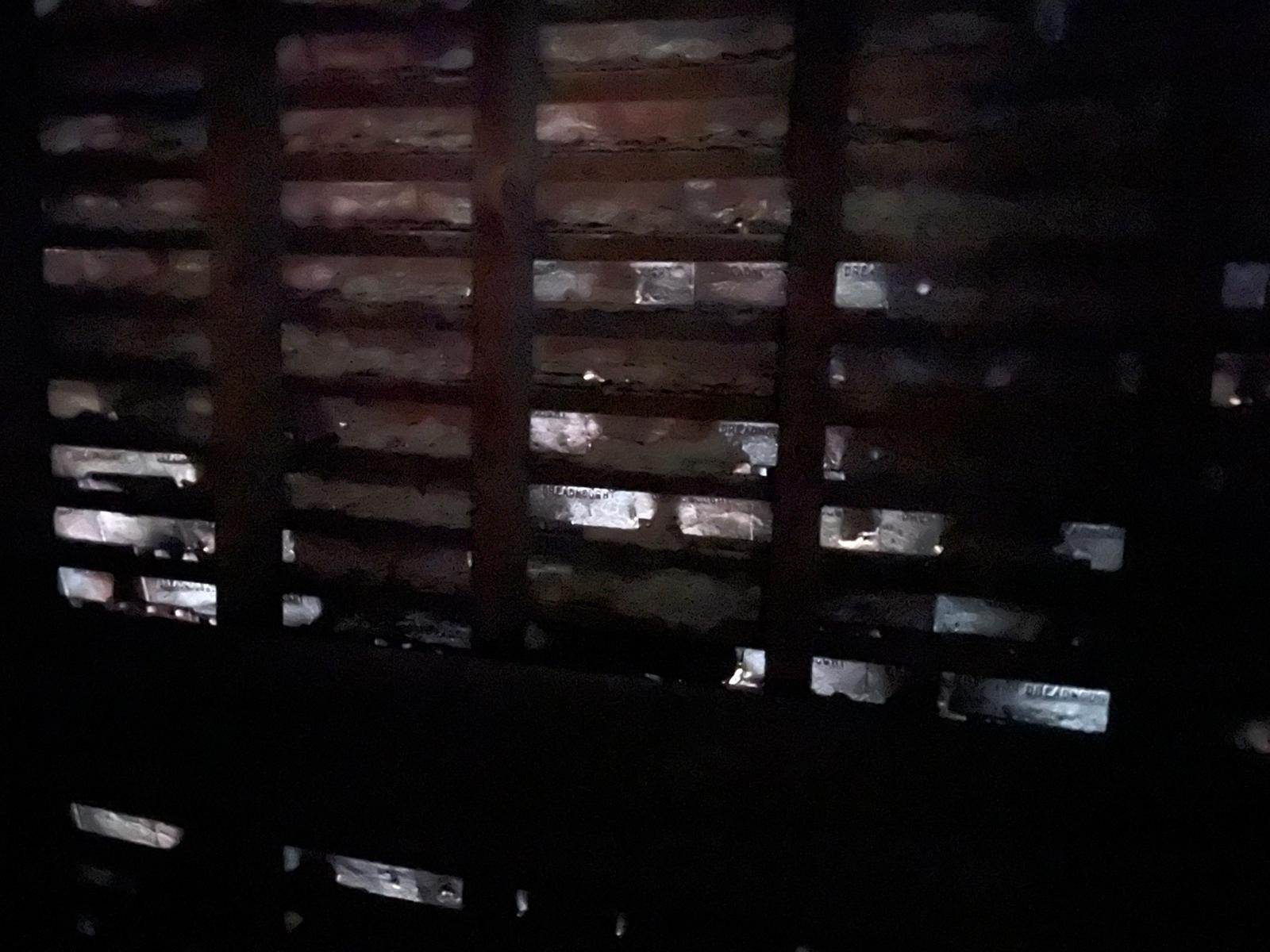

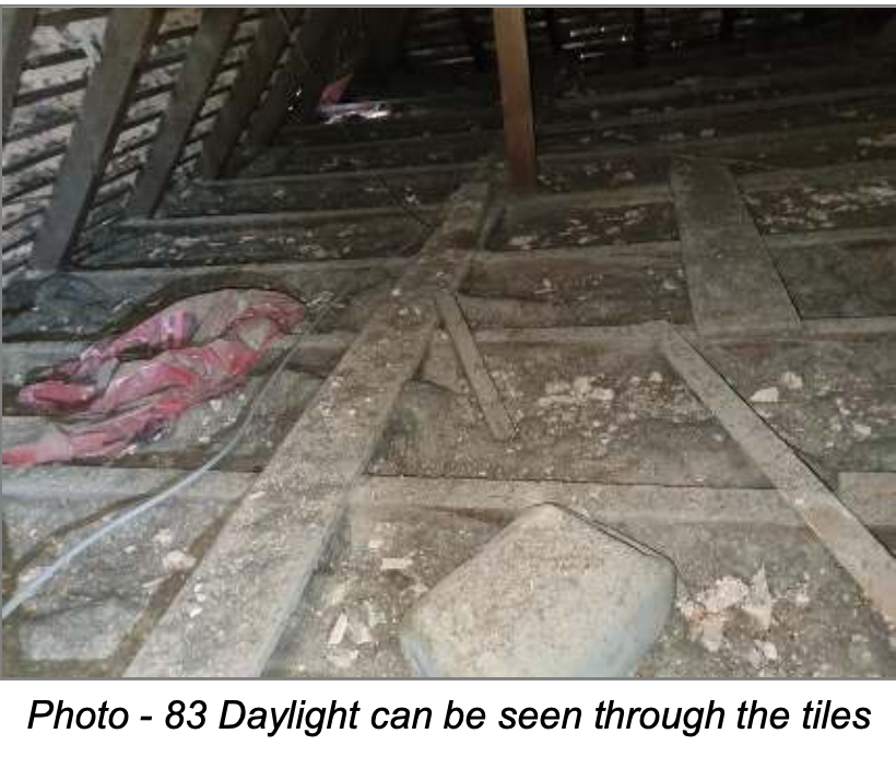

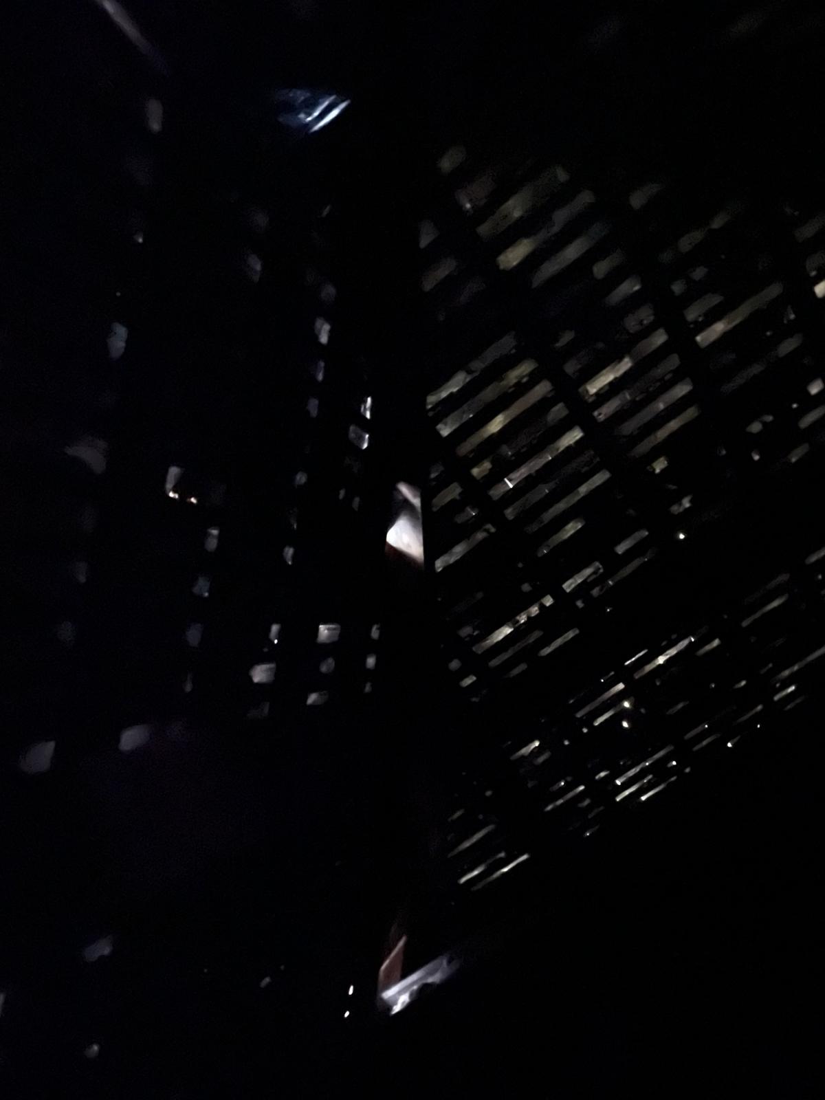

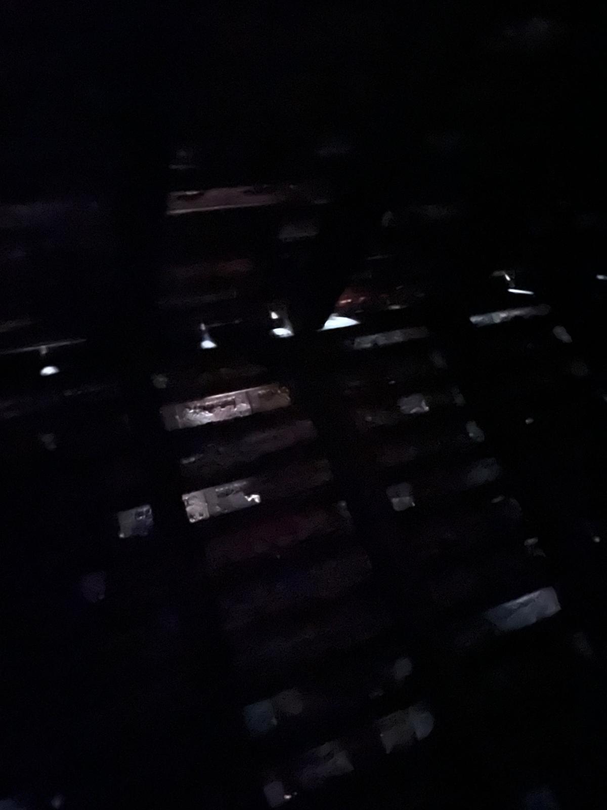

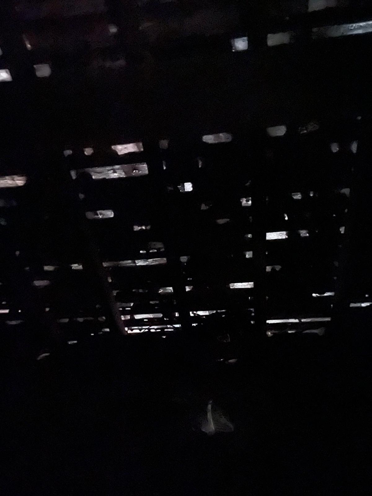

Roof is almost 100 years old, but the owners are convinced that because it's not leaking, it's not in bad condition. I've had the surveyor and almost every roofer I've spoken to give the opposite opinion.

Not enough pics of roof!

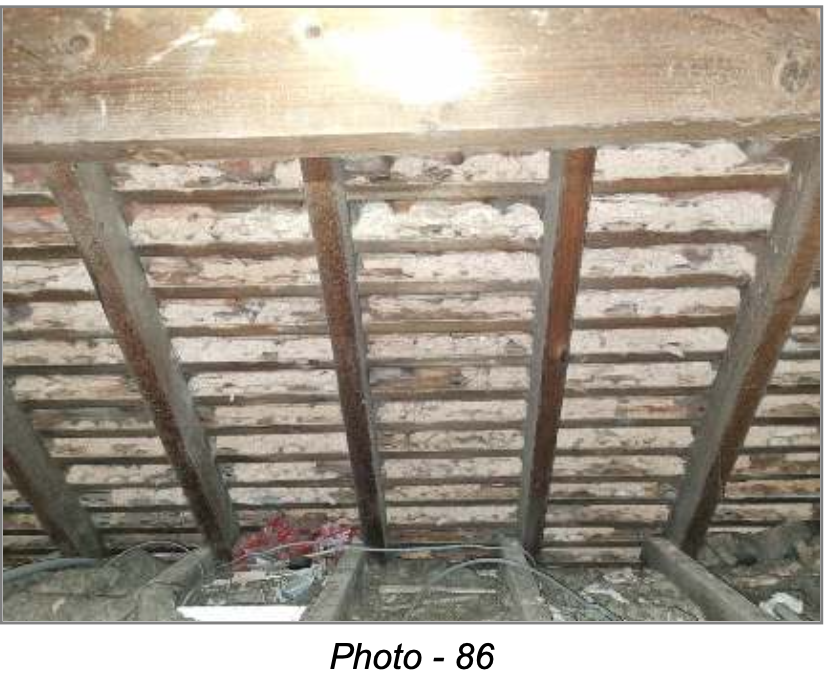

Assuming non-sarcasm :giggle:, I'm sorry these are all I have. The dark ones are obviously showing the amount of daylight getting in and the rest are from the level 3 survey I conducted.
Nothing to worry about. Depends on how bad you want the house. It obviously needs some work. Get some quotes and negotiate with the seller and if you can’t reach a compromise, don’t buy it. Only you can decide whether it’s worth it.
Stunning lack of insulation btw. Climb up in the loft there and have a feel of the battens, see if they've gone soft. Even better if you can do it on a rainy day to see if any parts are getting soaked. Be a good few tens of thousands to get that reroofed I dare say

Some of the earlier machine made tiles were prone to delamination. If the gutters haven't been recently cleaned, check those for shale like debris. It'll mean the difference between whether they can be salvaged or not, come the time you need to re-roof.

Personally it looks like a roof overdue for some maintenance, that means scaffold and therefore a level of cost that likely to be in the thousands not hundreds
If you are asking does the roof need re tiling -the following is great advice, from Noseall:
"Some of the earlier machine made tiles were prone to delamination. If the gutters haven't been recently cleaned, check those for shale like debris. It'll mean the difference between whether they can be salvaged or not, come the time you need to re-roof."
I presume youve made an offer as youve had a survey -how does the offer compare to equivalent properties?
My guess is you need to allow say £5k for roof repairs and maybe a new roof in the next 10-20 years costing say £20k
