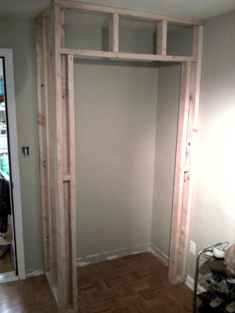

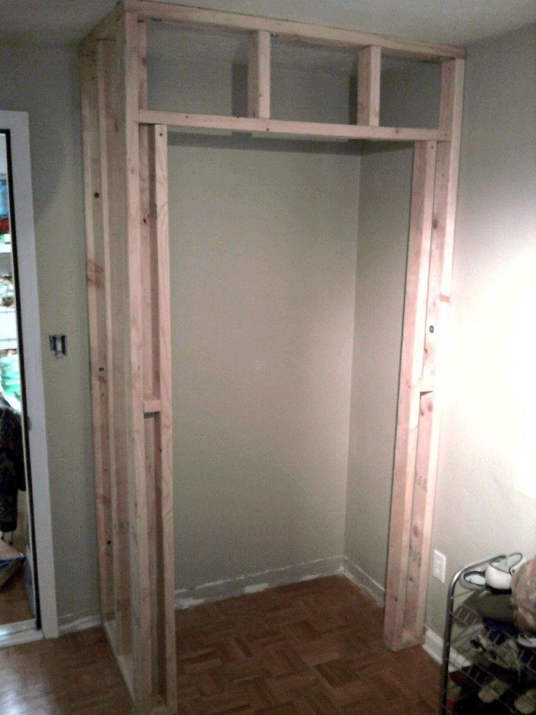

Thinking of building using these
and putting in these doors - with the top as a separate cupboard - room is 2.5m tall, and the outside width of the cupboard can be 110cm, maybe a bit more if needed.
https://www.wickes.co.uk/Wickes-Redwood-PSE-Timber---44mm-x-69mm-x-2-4m/p/9000036462
https://www.wickes.co.uk/Wickes-White-Closed-Internal-Louvre-Door---1829mm-x-457mm/p/187379
https://www.wickes.co.uk/Wickes-White-Closed-Internal-Louvre-Door---457mm-x-457mm/p/187373
Does this look OK?
I made a sample carcass using plywood, personally it didn’t cut the mustard, really you could do with a pocket jig like a cheapo Kregg.
Get your panels cut to size from a timber merchant, as sheet cutting is not that easy to do well, unless you’ve got a track saw.

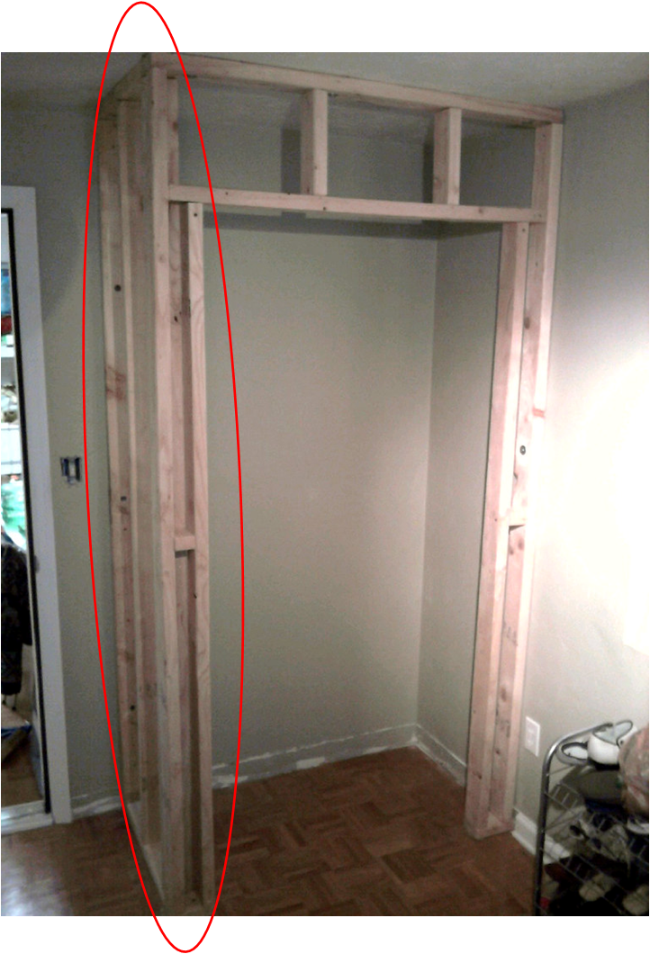

Idea is to do something like this (but maybe with a base of sorts):
Might cover in plasterboard then get my plasterer to skim it when he is next round. Will save me faffing about trying to cut mdf perfectly.
So 110cm wide, but doors can be thinner. So, if I get 2 doors 457mm wide, total 914mm - how wide should the gap be?
That above looks like 2by4?

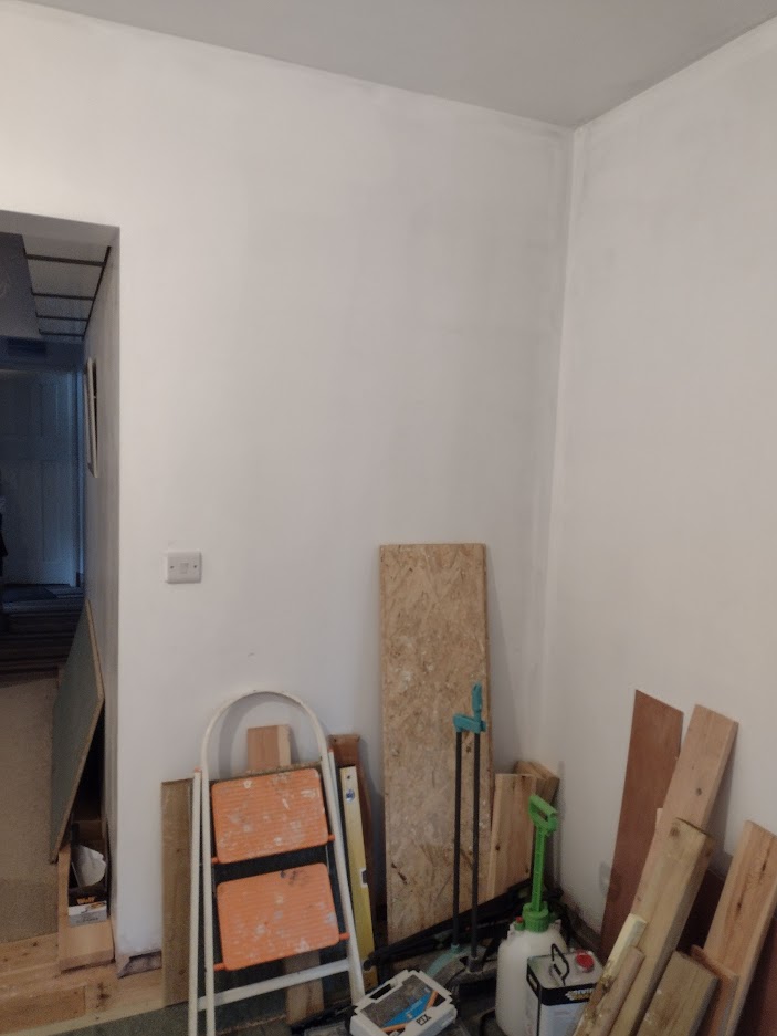

This is my room at the moment
Anything wrong with space at the top if you fitted a cornice around like kitchen wall units?
Another thought, if you have a wall jutting out will you still have have the other side of the door to manoeuvre furniture through which sometimes involved pivoting around the door frame
Not sure what you mean by space at the top. Moving furniture would be OK as the rooms off this both have good external access.
oh yeah - I have decided to build it myself, go all the way to the ceiling.
Yes. My last question was, what size wood should I use, and how big the door gap needs to be?

Door gap will depend on what kind of cladding on the frame and type of hinges you use, once you decide you'll know how far across the front to return the side wall which will beef it up .
