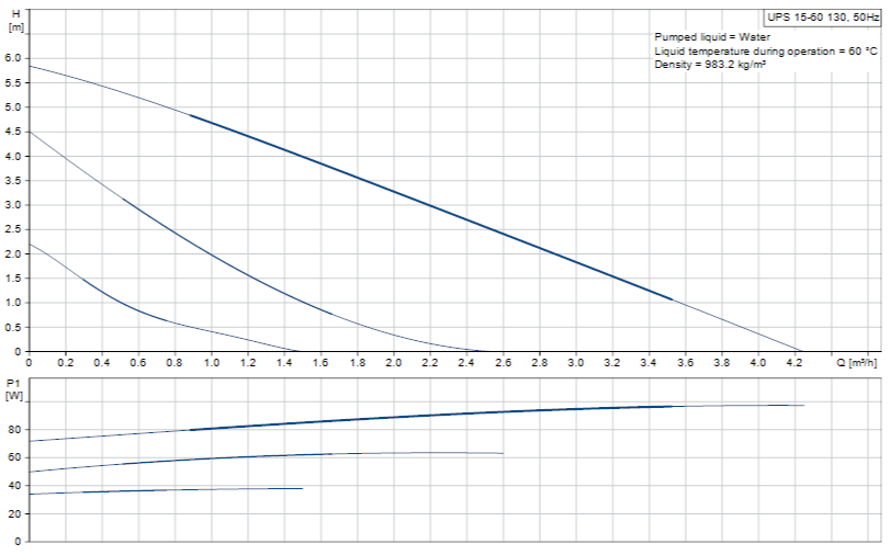

Your pump, if I am reading the correct pump curves has a huge difference in the pump heads at say a circulation flow of 1.5m3/hr which is ~ what you might require, speed 2 will only supply this at a 1.0M head and speed 3 at a 4M head, you may find that a head of 3.0/3.5M is adequate to heat all your rads.

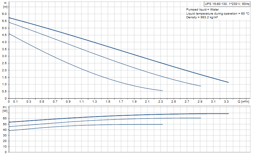

There are at least two versions of Grundfos 15/60 130, with very different curves. This is another version, where speeds 2 and 3 are much closer:

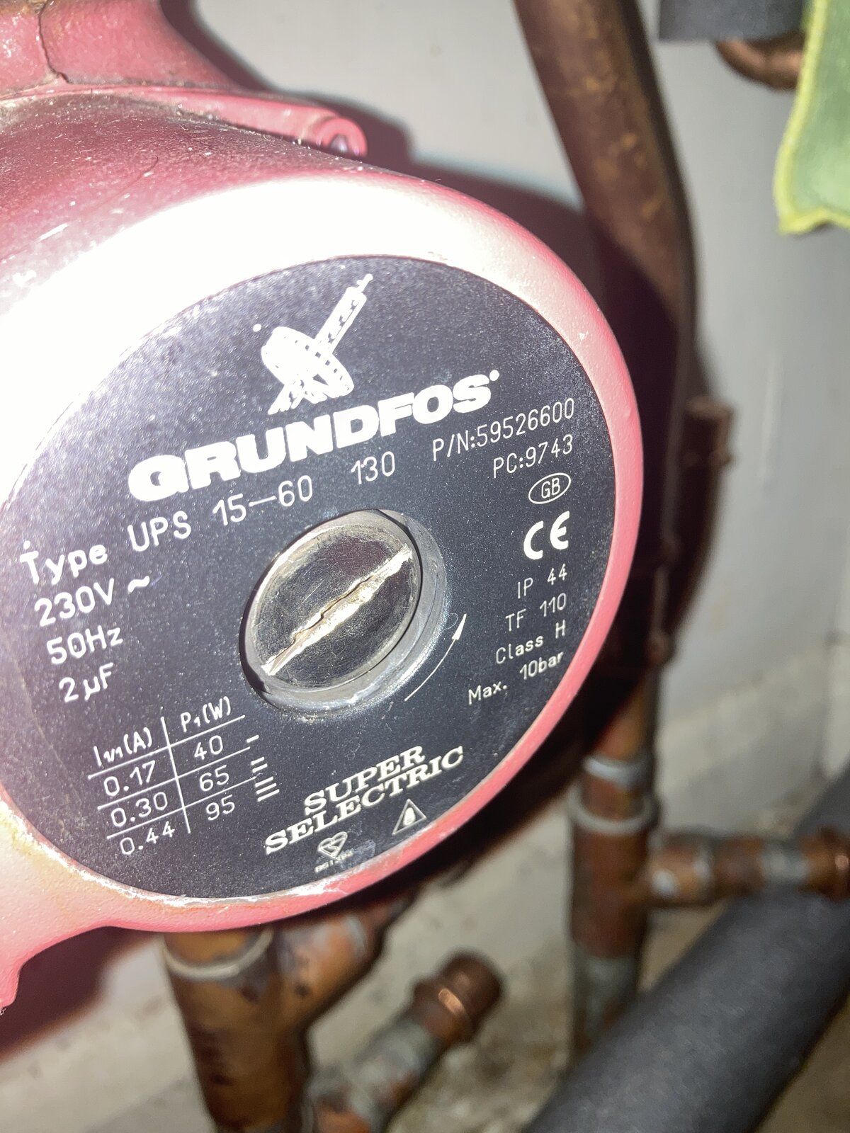

Do you have the Part Number off the front of the pump? Top right probably.
Thanks- I've attached a photo of the front if that helps? Incidentally I have ordered a new pump- I went for a Lowara Ecocirc which has a gradual dial adjustment rather than just three settings for the speed. Hopefully it will do the trick, and really appreciate all the advice.

Your pump is the version @Johntheo5 mentioned above, No. 59526600.
If you are interested in the performance, you can see how different it is, using this chart, and the one a few posts above. On the top graph for each, the difference in output, between speeds 2 & 3 in particular, is a lot bigger in your version. Yours does seem very feeble on speeds 1 & 2! But if you use 3, it is extremely powerful.
Hopefully the new pump will use a lot less power and run more quietly.
Really interesting to see our pump performance in graph form and explains exactly what we are experiencing with the massive jump. And, how old it is!
