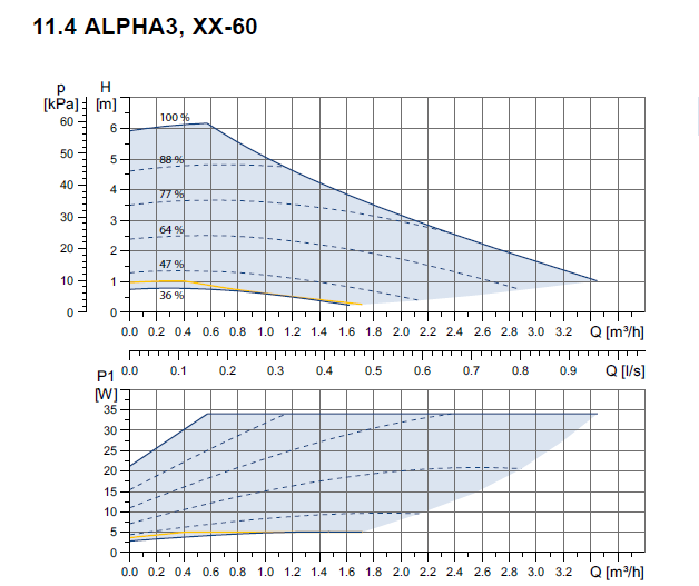

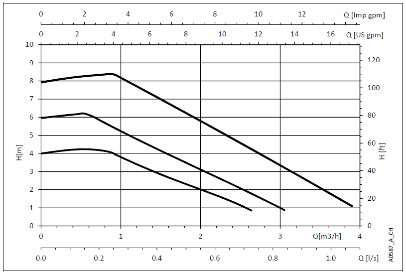

Ecocirc Curve below has the same performance at 6M as most other 6M pumps like the Alpha3.
If you assume tat the 16rads output at a total of 24kw, a rad dT of 15C requires 1LPM so total flow is 24LPM or 1.44m3/hr, say 1.5m3/hr.
Your own pump + the two below all give this flow at ~ 4.0/4.1M.
My only slight concern/suspicion is that the Ecocirc is actually a 6M pump and they achieve a 8M head simply by increasing the RPM, now if this is correct then it may be running at the same speed (at 6M) as your original pump (or even higher) but hopefully won't result in the same problem, Of course the same might apply if you had choosen the Alpha 3 or any other 6M pump.
You may not require a 4/4.1M head so CP or PP settings will result in reduced speed to give the appropriate head if any problems arise.

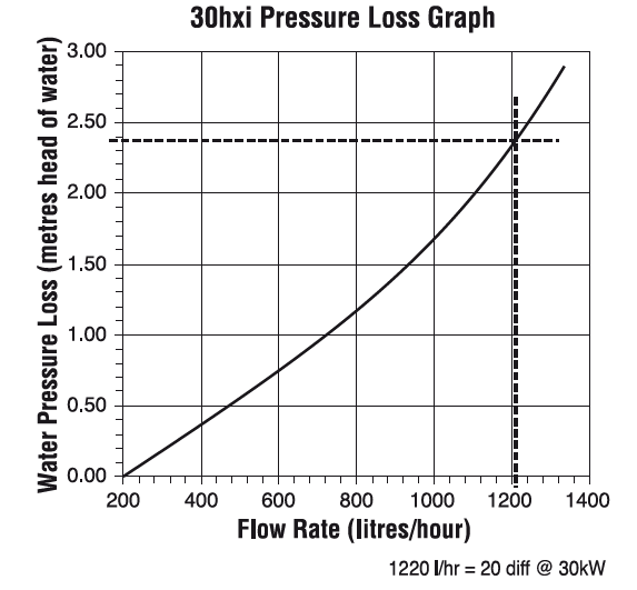

You will often see gas boilers giving a max flowrate based on a 20C boiler dT, your 28kw might have a max flowrate based on this of, 28X860/60/20, 20LPM, 1.2m3/hr and they may also give the pressure drop through the heat exchanger which can often be 2 to 3M so the boiler circ pump has very little remaining head to circulate the water around your system so they generally recommend the installation a low loss header (LLH) with its own pump on the secondary side, the second pump then has plenty of head to circulate the heating system or/and HW coil. Again, some gas boilers have much lower Hx pressure drops than others so you may have little trouble in just using one circulation pump.
Here is a example of a 30kw Glowworm Ultracom HXI which has a dP of 2.4M at 1220LPH, 20LPM, 1.2m3/hr so you can see why 6M pumps can struggle trying to then circulate through the rads after loosing 2.4M through the Hx. An oil fired boiler might only loose 0.25/0.5M through its Hx at this flow.

Its inconceivable IMO that a 8M pump will not give a far higher head at your measured flowrate, above while in CP3 mode. your readings will be most informative.

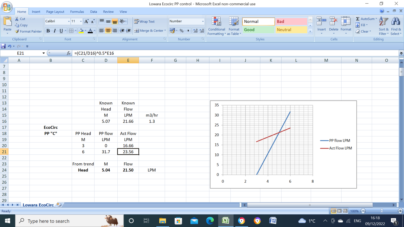

PP setting 1: 1.27m. 0.69m3/h. 7.9w
PP setting 2: 3.21m. 1.02m3/h. 20.4w
PP setting 3: 5.07m. 1.30m3/h. 37w
CS setting 1: 3.60m. 1.13m3/h. 23.9w
CS setting 2: 5.26m. 1.29m3/h. 38.1w
I tried it on PP setting 2 and it didn't seem to be quite enough to get all the rads warm but I do need to sort out balancing as I've had so many rads on and off over the last year or so whilst renovating, and replacing the odd one for a towel rail in the bathrooms.
PP setting 2 too low as its only producing a 3.21 M head and 1.02m3/hr.
PP3 would be a reasonable setting IMO if your original CC2 data of 1.29m3/hr at 38.1W satisfies your requirements with everything, PP3 will then reduce the head required as the TRVs or zone valves close in leading to reduced power consumption. CP2 is almost exactly the same as CC2? so again would be a good choice IMO. You didn't include any readings for CP setting 3?.
