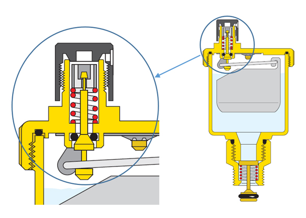

If water comes out of an aav, it's doing its job of expelling air that collects in it. Normally it's full of water and is a high point in the system that collects air, which it then releases. As the air comes out, water comes in to take the air's place, and the presence of the water shuts the valve again

Cant say I've come across many auto air vents with a valve in it that you can push down (Shraeder?), that would defeat the purpose of it being an 'auto' air vent.
Most do have a dust cap that is loosened and any air is then expelled 'automatically' by the internal float dropping. When there is enough air in the top of the bottle the spring pushes the float down and releases the air, once the air is expelled the water fills back in and pushes the float back up and shuts the valve.
As suggested, sure it isn't the expansion vessel? A pic would help
