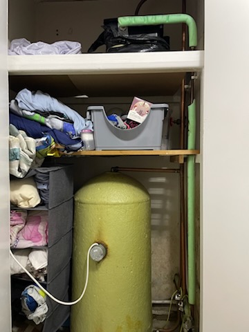

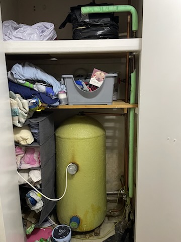

Hi, I live in a ground floor flat. No boiler and all electric with immersion only. I want to boost my hot water so I can use the shower on the mixer tap . Seen quite a few on the market but which to buy. Cold pressure is fine. Thanks.
Show us a picture of your hot water cylinder and the cold water feed to it ,which may or may not be a separate cistern.
A shower power booster is relatively inexpensive ,but easy to fit ,it would boost the flow to around 6 litres per minute. If you want a more powerful pump it may or may not be feasible. More info and pics would be useful.
Hi, will do and thanks for thr reply. I assume its fed by a tank somewhere in the loft soace?. Will get back with pics. Cheers.
Hi, sorry for the late reply as been away. Please see pics. Hope this will help solve my issue. Thanks again.

The small black cistern ( tank you may call it) above the hot water cylinder feeds cold water into the cylinder. It is too small to fit a powerful pump to. A shower power booster pump would be suitable though. I would assume your cold water is supplied to all taps/ shower direct from the mains. Mixer showers really need balanced pressure hot and cold to work effectively,you would not have balanced pressures with the small power shower booster on hot supply, and mains cold water under mains pressure. If your mixer is a manual type ( not thermostatic) it has a good chance of being ok though.

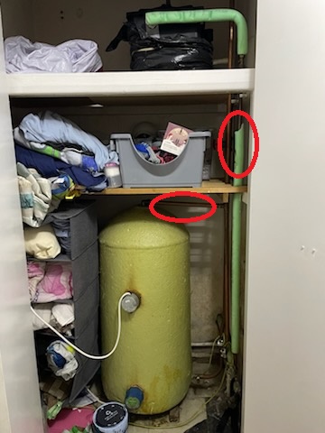

Hi, I have been in touch and they recommend an SP1 due to the flow test being too low for an SP2. I have attached a pic as to where I think it should go as I have circled. The company you told me about were unsure, and that's where I will be buying it from. I have an electric socket near the cupboard, but i can't fit it under the bath on the hot tap pipe as they suggested due to it being a manual one and no power outlet anywhere near. Cheers.

The hot branch pipe to your bathroom doesn't appear to be visible in your picture ,is it anywhere that you can see and access ?
Fitting the pump to the hot water distribution pipe would allow all hot taps to have increased flow / pressure once pump ( SP1 )is electrically turned on.
The pump needs to be fitted after the vent pipe ,not before as in your picture.

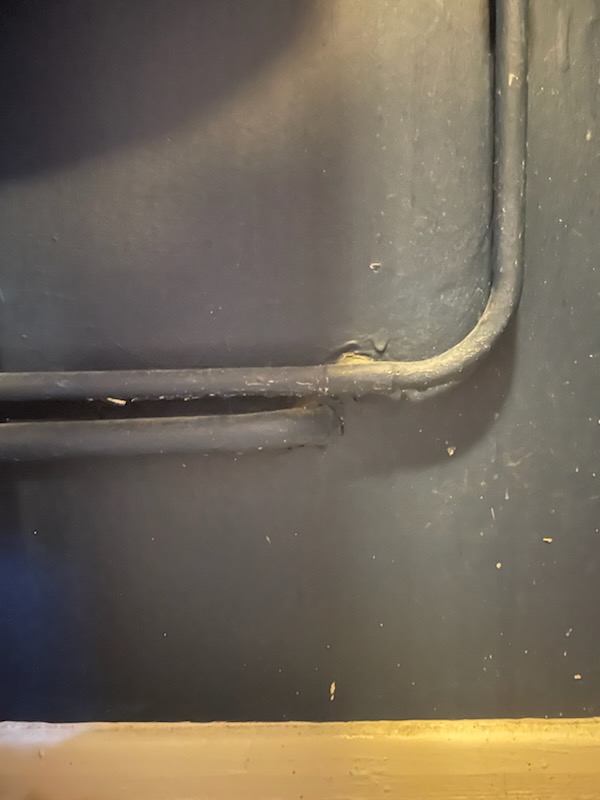

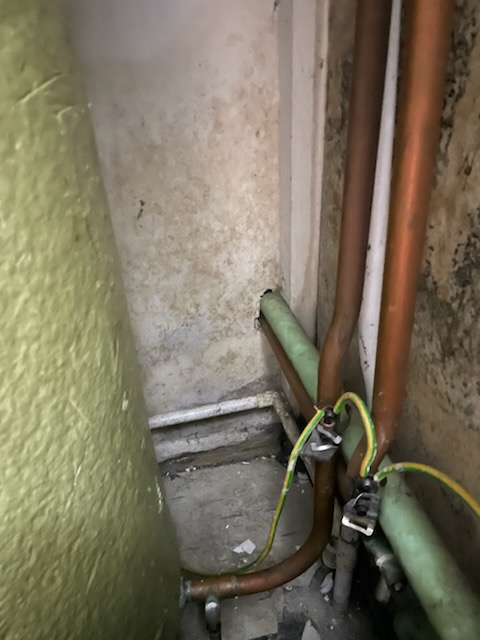

Hi, some more pics. Pipe to bathroom and branch off to sink. Can't shiw any more with pics to be honest. Where to fit then with all pics sent. Sorry not up on this stiff so if you can help and be specific that would be great appreciate all of your help and knowledge so far. Thanks.
I can't tell from your recent pics which of the pipes takes hot water to the bathroom.
If I were you I would fit the manual pump to the 22mm distribution pipe ,that would boost all hot outlets ,but as you will manually turn the pump on when you want a shower it won't matter.

Hi, pretty certain it is the 15mm that's just below the green covered pipe in my latest pic that carries the hot water through the wall to the bathroom. I don't own the flat, so cannot change the cylinder. Only allowed to fit the pump to sort the shower issue out as long as i pay for someone or do it myself. The 22mm distribution pipe? Cheers.
