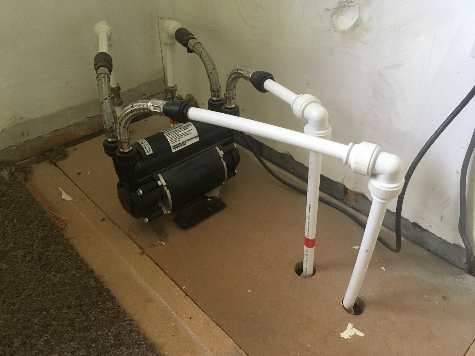

Number of things could be wrong but we need a bit of detail to help. A mains fed shower combined with a pump is not really a thing, it's usually one or the other...
Can we have some pictures of the hot water tank and the pump?

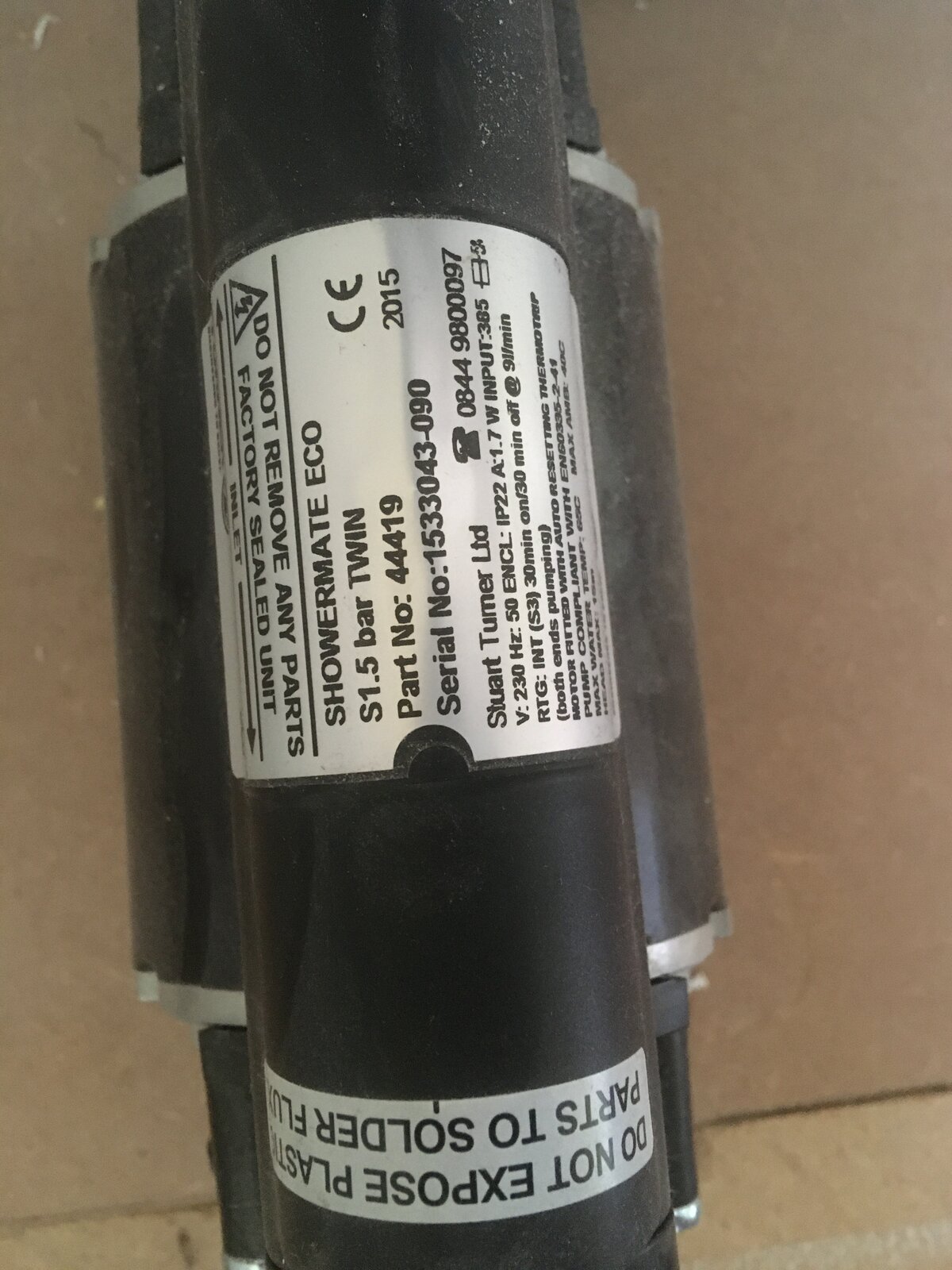

The shower is on the ground floor and the hot water tank is in a cupboard on the floor above. The cold is mains fed and the hot is mains fed but goes through the pump (to increase water pressure I assume) which is on the other side of the wall in the adjacent room.
I actually changed the shower head myself recently as I wanted a wider one, but the issue was present before and after.

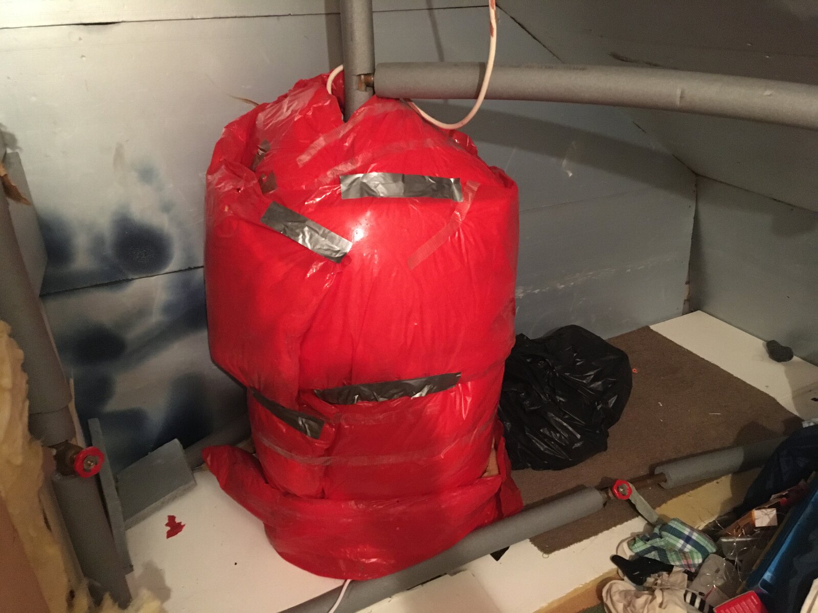

Show us a picture of your hot water cylinder , I doubt your hot water is under mains pressure.

Sorry I am probably not explaining it very well and may have confused things.
Here is hot water tank

Your hot water is gravity fed ,and pressure would be poor ,hence a pump has been fitted . There is insufficient water flow through the shower to trigger the pump . This could be the shower head itself ,or the flexible hose are too restrictive to flow. Remove the shower head and let the hose hang down .Then run the shower and see if pump now starts.

Yes ok. The fact that it occurs after it has been left idle would be indicative of the non return valves sticking .
