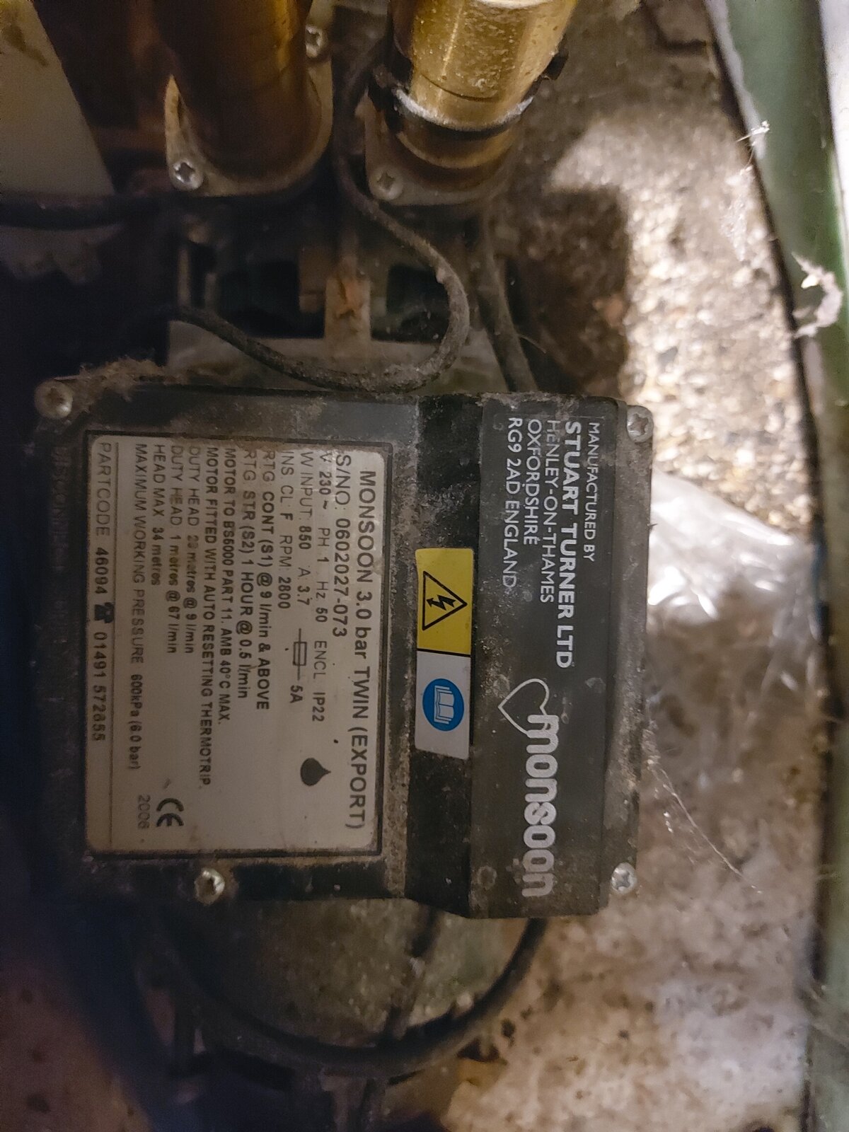

Hi Terry, I have a similar problem to this. I have a new shower and the filters are not blocked. There is a pump fitted for to pump the water from the tank. When I turn on the water valve on the shower, no water comes out. However if I switch on the tap in the sink the water then comes out of the shower. Sometimes if I put the shower head closer to the floor the water in the shower does come out. Any ideas how to resolve this issue without getting a new water pump? Thanks, Jim
Sounds like your problem is there isn't enough head of water to activate the pump's flow switch, as suggested, when you run the tap, the flow increases kick starting the pump. What type of shower is it? Is it a modern bar shower as most are designed for combi's/mains pressure?
You could increase the flow to the shower, be it increase the pipe size or raise the cold water cistern etc. The other is to put in a remote pull switch wired to the pump's power. When you turn on the shower then turn on the pump, the intital kick start of the pump will supply enough flow for the switches to activate, as long as the shower is on then the pump will run, once off you need to turn off the power to the pump, then repeat the next time.
Can you post a pic of the pump then we can see if it is a universal pump or not.
OK so you have a standard pump (ST monsoon .... good shower BTW) and a bar shower that needs at least 0.5bar to work.
Unless you cold water cistern is at least 5m above the head of the shower then there probably won't be enough water pressure to overcome the restrictions in the shower and therefore not enough flow to activate the pump. I'd also check the filters and switches in the pump as it looks like it's been there a while and they may need serviced.
Great thanks. There's no way to have the cistern 5m above the shower as we are in a bungalow.
So the only way to fix it is to get a new pump?
Or fit a low pressure shower so the flow is inreased or make the pump switched. The latter is probably the cheapest and easiest way.
Will probably look at installing a switch. Might have it linked to the extractor fan. Thanks!
