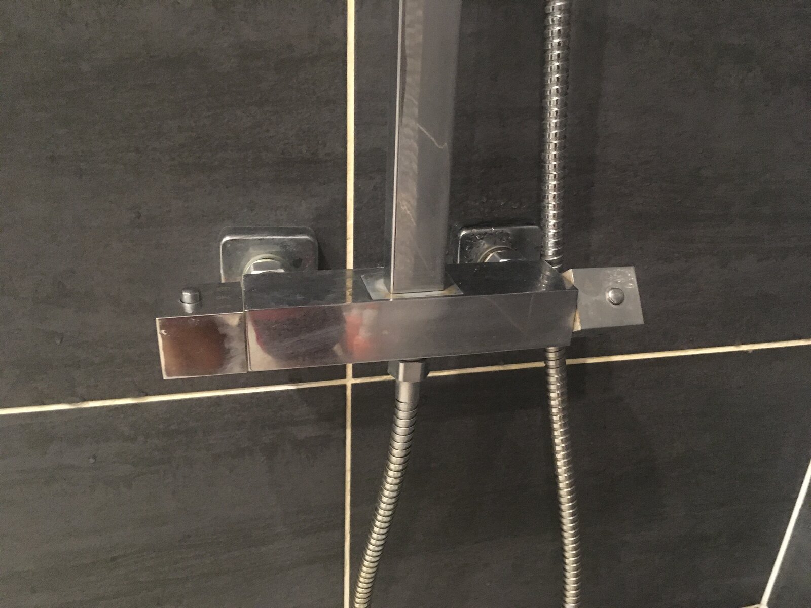

Show us a pic of the shower valve.

The supply pipes are behind the wall but poke out enough to attach the mixer shower barrel
Thanks. See the large, Chrome ,hexagonal nuts that hold the bar mixer to the wall / pipework ,the filters & NRV's are just inside where those nuts are.
