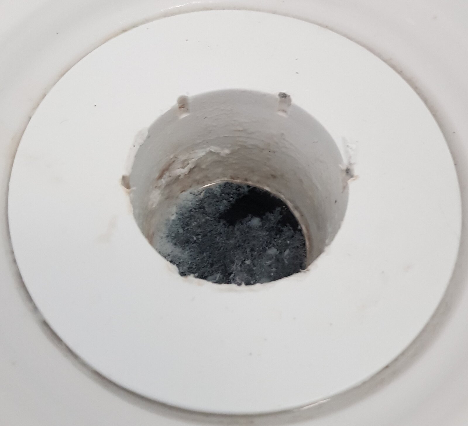

Hello everyone, sorry if this is not the correct forum.
I'd appreciate some help please, my shower is blocked and I've tried various unblocking methods like boiling water, chemicals etc and nothing has worked.
I cant get the drain piece out of the shower to get to unblock it.
Is there a special tool that I need? The shower hasnt any brand names on either, it's in a new build flat so it's about 3 years ago when it was installed.
I've attached a pic of it.
Thank you in advance if anyone can help.

Correct forum, so no apology needed. If it’s a new build, the fall may be running back (known as a backfall). Is there any hair in the bottom of the trap?
Be very careful messing about with it if you've dumped chemicals down the pipe, they can still be nasty, even in a diluted condition. Skin and eye protection is a must before messing about with it now, (This is your last pair of eyes!). Any ideas where it runs to and/or if the outgoing pipework is accessible?
No tool needed, those notches are there to help initial assembly, and probably locate the grille thingy.
Agree try a wet vac, agree it's probably hair.
If it empties slowly, keep adding hot hot water to flush out whatever's been used. Then it's one of the heavy duty gel unblockers, or nasty horrible gloves and face protection type acid drain unblocker.

I cant feel the bottom of the trap as I cant get my fingers far enough down. I thought if i could get the piece off shown in the photo then I'd be able to clean it properly but cant get it off.
I've tried hot water as well and it just wont budge.
I'll be careful, theres a chamber like plastic thing that it runs to under the shower tray and the waste pipe runs off that, it's all so close to the shower tray and floor that I cant really see much else.

I will try that, just would have been easier if that had come off so I could get my fingers down there to pull out whatever is stuck in there
Blockage could be further down the pipe, particularly if it doesn't have a very good fall on it, gunge builds up and eventually blocks it.
Dont waste your money on Chemicals, you may well find they melt the pipe before the blockage. The best method is always a mechanical clean.
I'd try firstly, filling the tray up with as much water as you dare, then use a decent quality plunger to try and force the blockage through. Failing that, a Wet Vac might be your best option, Wickes do a reasonable quality wet vac for £46, which should do what you require. Either way, Eye/Face/skin Protection is a must.
If it is hair, try a rigid bit of wire with the end bent over. That said, the vac option is better.
