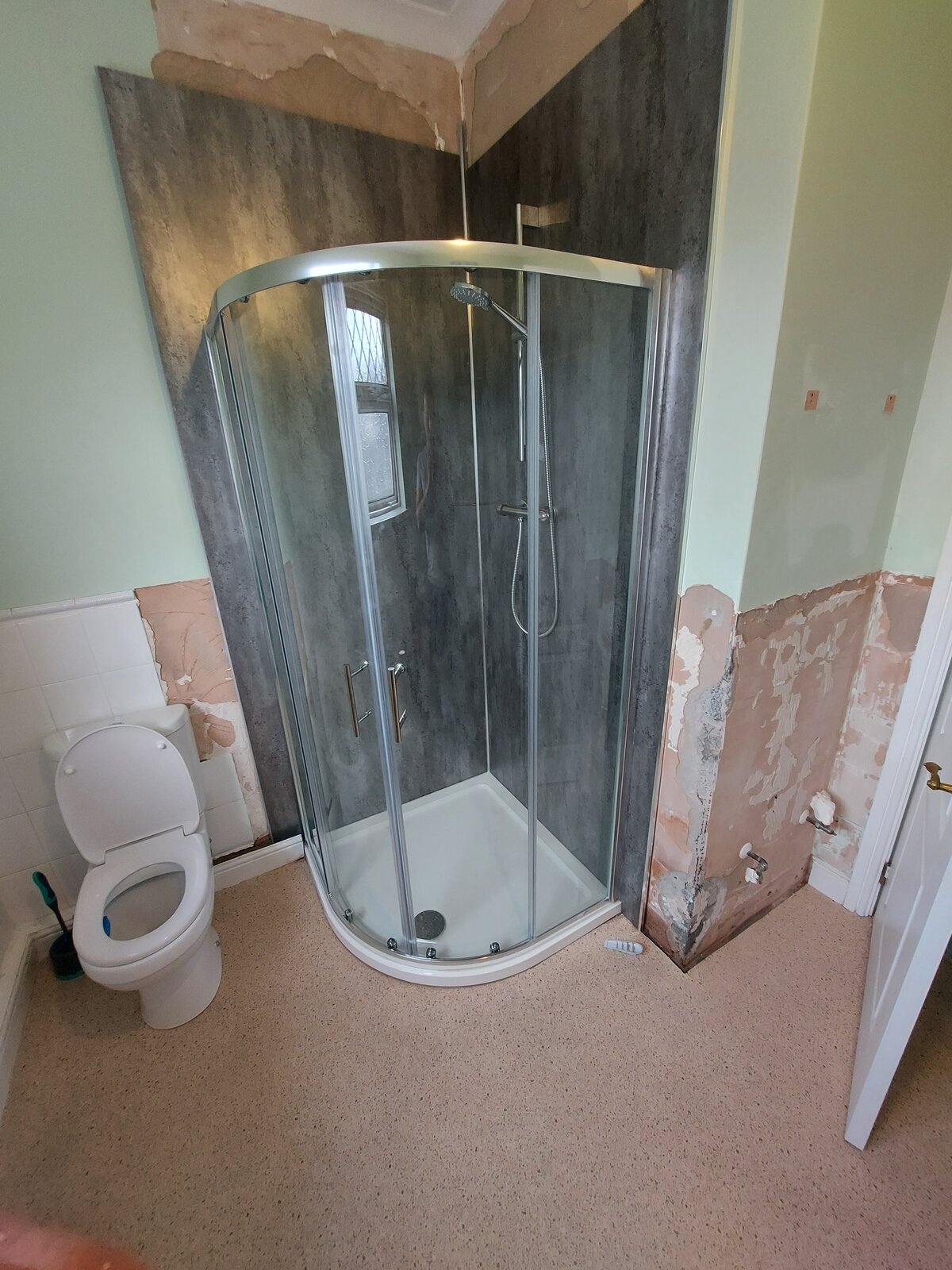

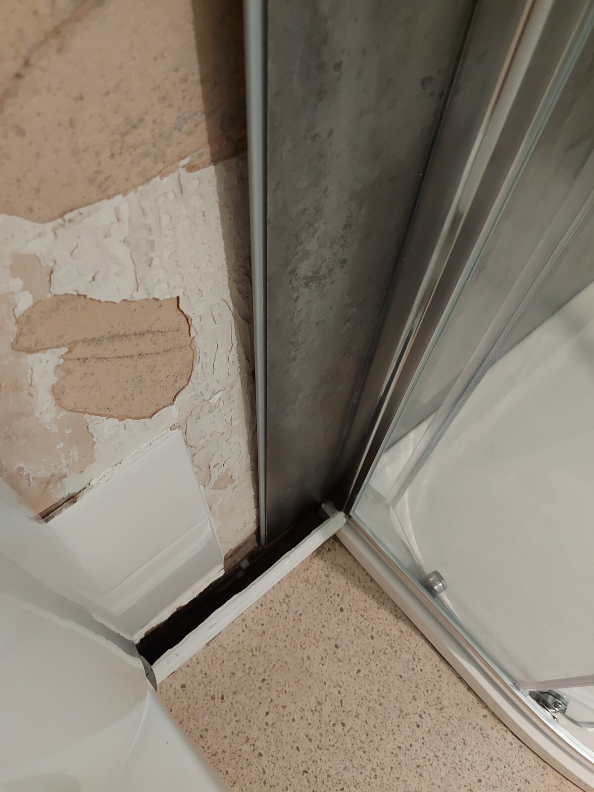

Hi guys wonder if someone could help me. I had plumber come in today to fit a quadrant shower and with wall panels. I should have checked and so should he but the walles are really uneven we are talking an inch maybe more. This is the outcome in the attached photo. Plumber has left it like this and now the board is half off the wall the enclosure not even fitted to the wall due to the gap being this big. Can someone help or recommend how to sort this out? People have suggested batton fittings and even expanding foam.

Hi Richie9.
I would not be happy with that installation.
I'm not mate really not happy. I understand the walls need to be straight for wall boards however i wasn't aware it wasn't straight and he should have definitely checked. He seems to think it is a simple solution with battens or fill the gaps with expanding foam
I wouldn’t recommend expanding foam, as it can be difficult to work with. Battens might work better.

He was up against the wall a bit I suppose. No doubt you asked him for a quote. He allowed a day.

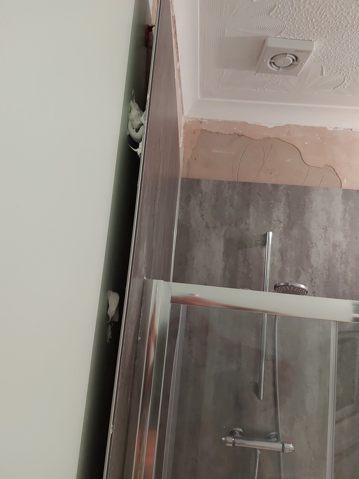

There’s nothing wrong with foam in this situation although he’s not been very generous with it and a few battens slid in the back of those boards would be easy enough to do.

That needs to come back out and be done properly.
I cant see how a fix in-situ is going to work and provide a reliable panel that won't flex if someone leans on it (which they will) if they flex it won't remain water tight.

Do the panels go behind the tray as well? Can't really see properly but they should sit on the tray not behind it.

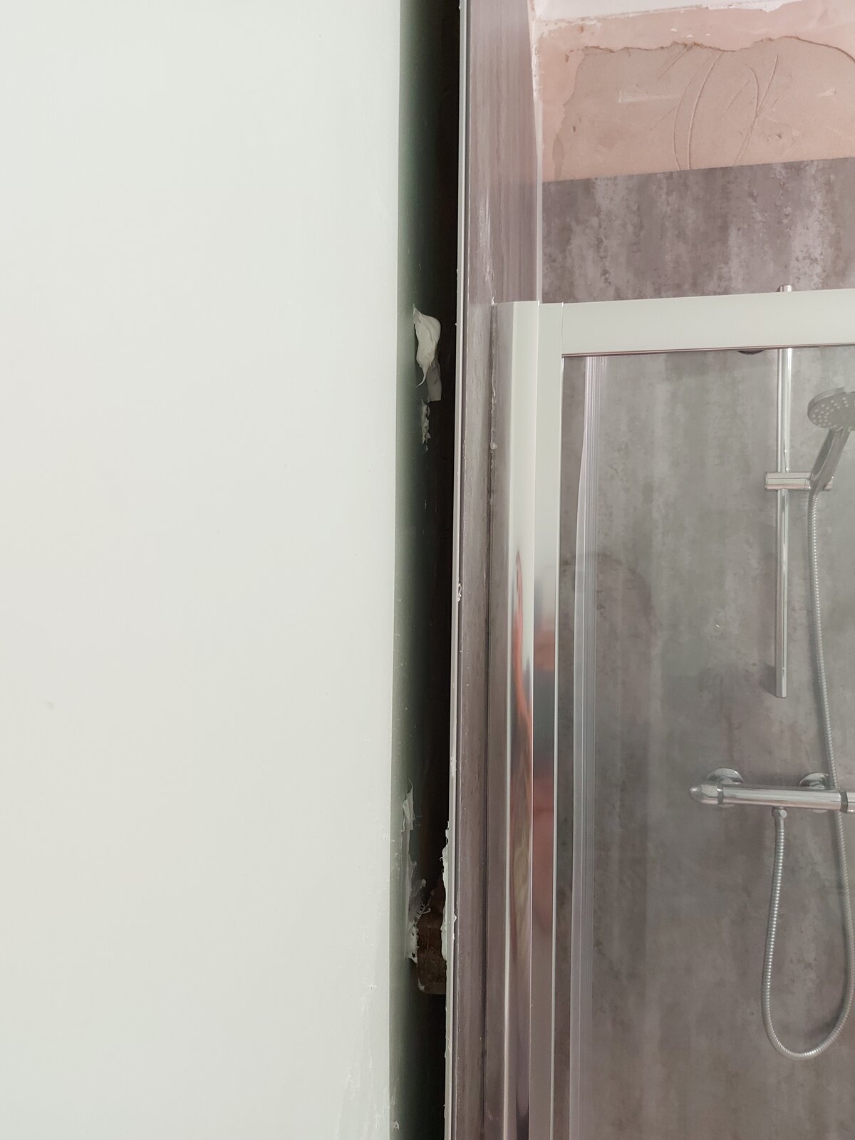

Hi guys yes the panel is only 2.4 metres wheres as the ceiling is about 2.5. Therefore that is why the panel is short. Here are more photos. The panels do not come to the floor they were cuton one side to support to the floor.

As suggested, that cant be fixed like that, it all needs to come out and the walls re- sheeted first to make it true. Anything else isn't going to last with that size of gap at the back of the wet board.

Careful he doesn't just use a baton to fit into that end, all that will do is firm up the edge, it will still have a huge void at the back of the panel. The panel needs to be flat against the wall therefore the only way to do it properly is the whole wall needs straightened, outherwise it will never look right.
That panel has been so badly fitted and with so little adhesive that i can see, it might be salvageable by gently prying it back off again.
Personally, I would have made good the walls above the panels first as well as they're a bit of a mess and will be more difficult to get a good finish after the panels.
