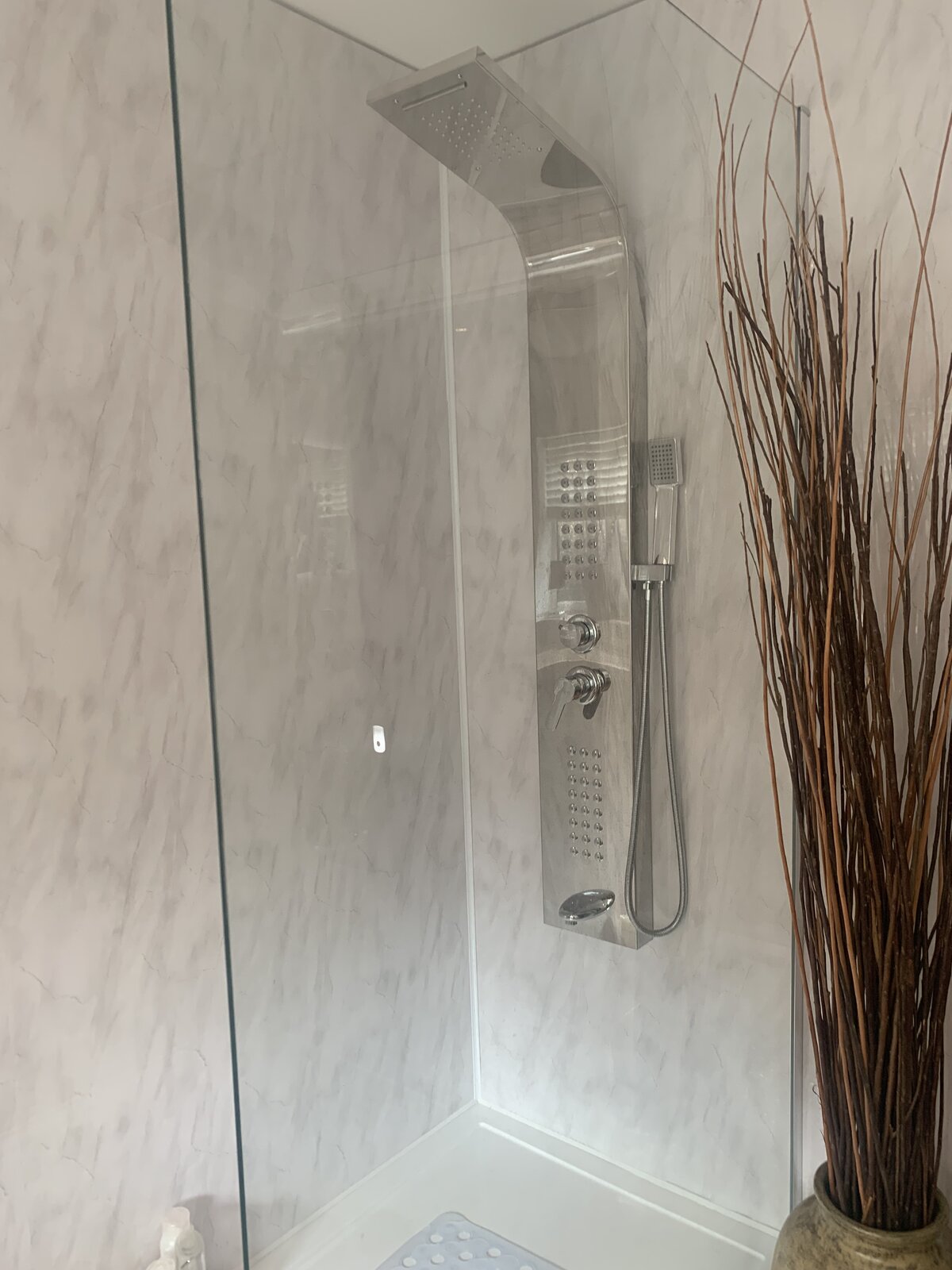

Fine, my shower panel is off a combi boiler .
