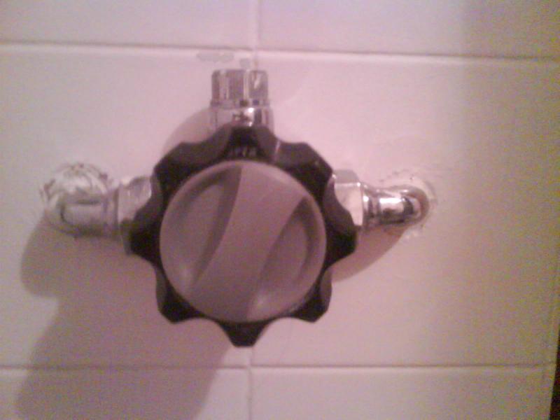

Can anyone help??
I have a mira 8 shower valve fitted in my bathroom and want to change this with another but without the hassle of changing pipework, can this be done??
Am I right in thinking that the hot and cold pipes are exposed where they enter the valve. If yes, measure the distance between the centres of the 2 pipes, and buy a mixer with the same pipe centre measurements.
A pic. would be nice. :wink:
