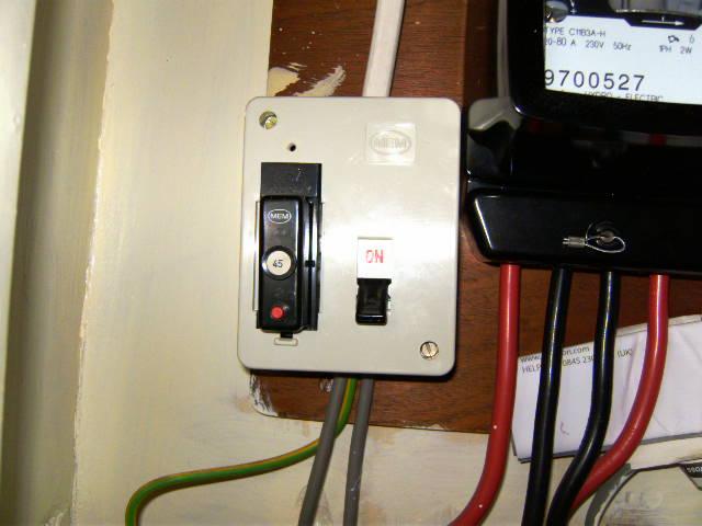

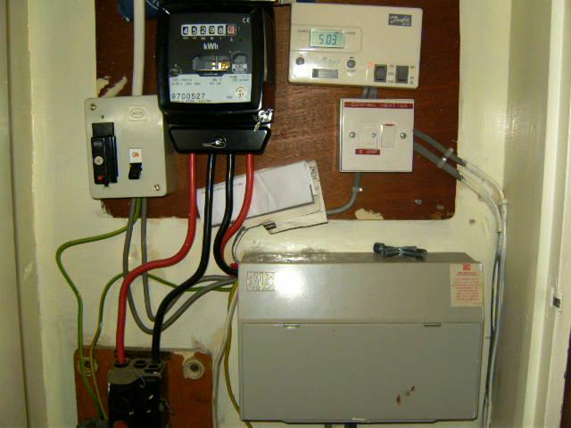

Here's the pictures of it.
So you think it may be the wires under the box, only issue with that is the bottom is live with no way of switching it off, if the new mcb doesn't work the I'll remove the cover and have a look, if there's sign of damage I'll get my friendly sparky to fix.
The overheating MCB
Main fusebox (MK)
How it all looks overall.
[/img]
Definitely have that old fusebox for the shower replaced.
It has no RCD, is probably damaged internally from the overheating, and isn't connected to the supply properly either.
There is plenty of space to get a new one in, even if the shower cable needs to be shortened to remove any damaged ends.
I'm happy with that, what should I replace it with ?
I take it a combined RCD and mcb unit ?
Any recommendations ?
Something like this should do the job, fitted with a D.P. RCBO.
If your mate's a spark, get him to bring his clamp meter around and check how much current that shower is actually drawing... Something's maybe not quite right here.
Excuse me being stupid but that just looks like a big on/off switch to me.
I take it I have to fit the protection afterwards ?
