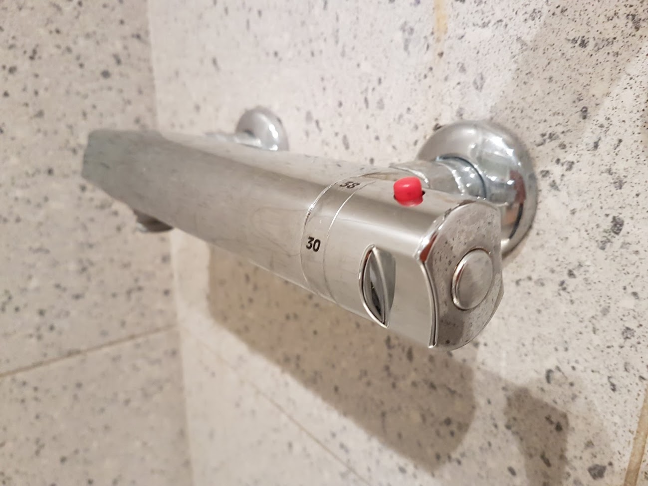

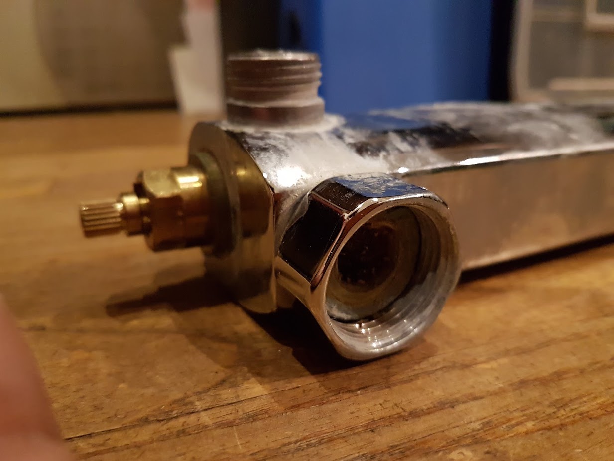

Trying to remove the valve at the end, the open/close valve, not the mixer, but it's solid.
Is it 'removable' does anyone know?

Thanks Terry. I know the evidence is obvious, but aside from the grips, I really have 'swung' on it using a mechanics' socket & wrench. Started me thinking it's not made to come out.
I'll give it another go.

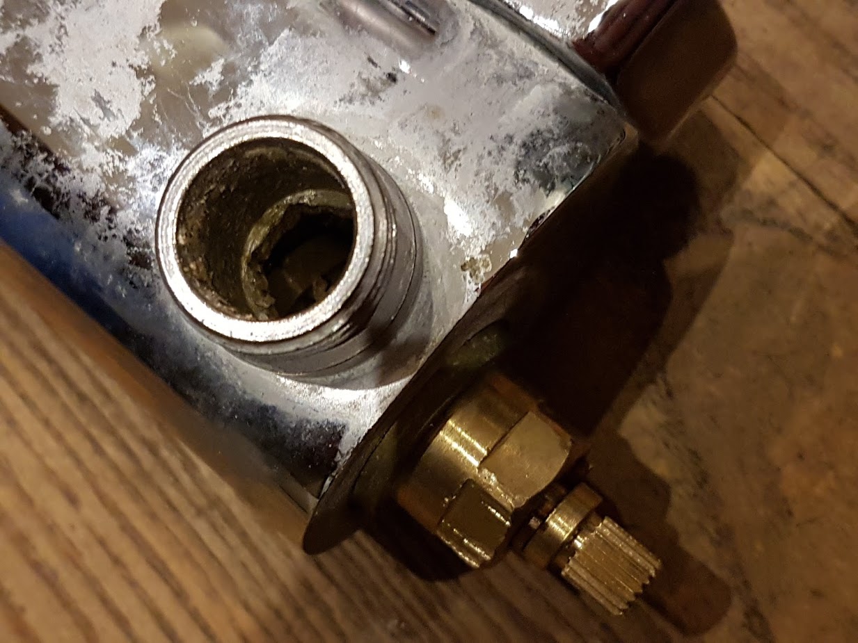

They can be awkward to remove,have you considered a new bar mixer ? your valve shows scale build up in the ports.
have got them and similar out by pouring a 2 kettles of boiling water over and inside the brass valve,then unscrew while very hot :idea:
you have to remember they have been tightened by a machine and could have some jointing/thread seal compound especially if its made in china :mrgreen:
swinging won't do - it needs shocking- air wrench or cordless impact driver. If you have a friendly garage/tyre place you use, take it there with the socket and a drink for them;)
